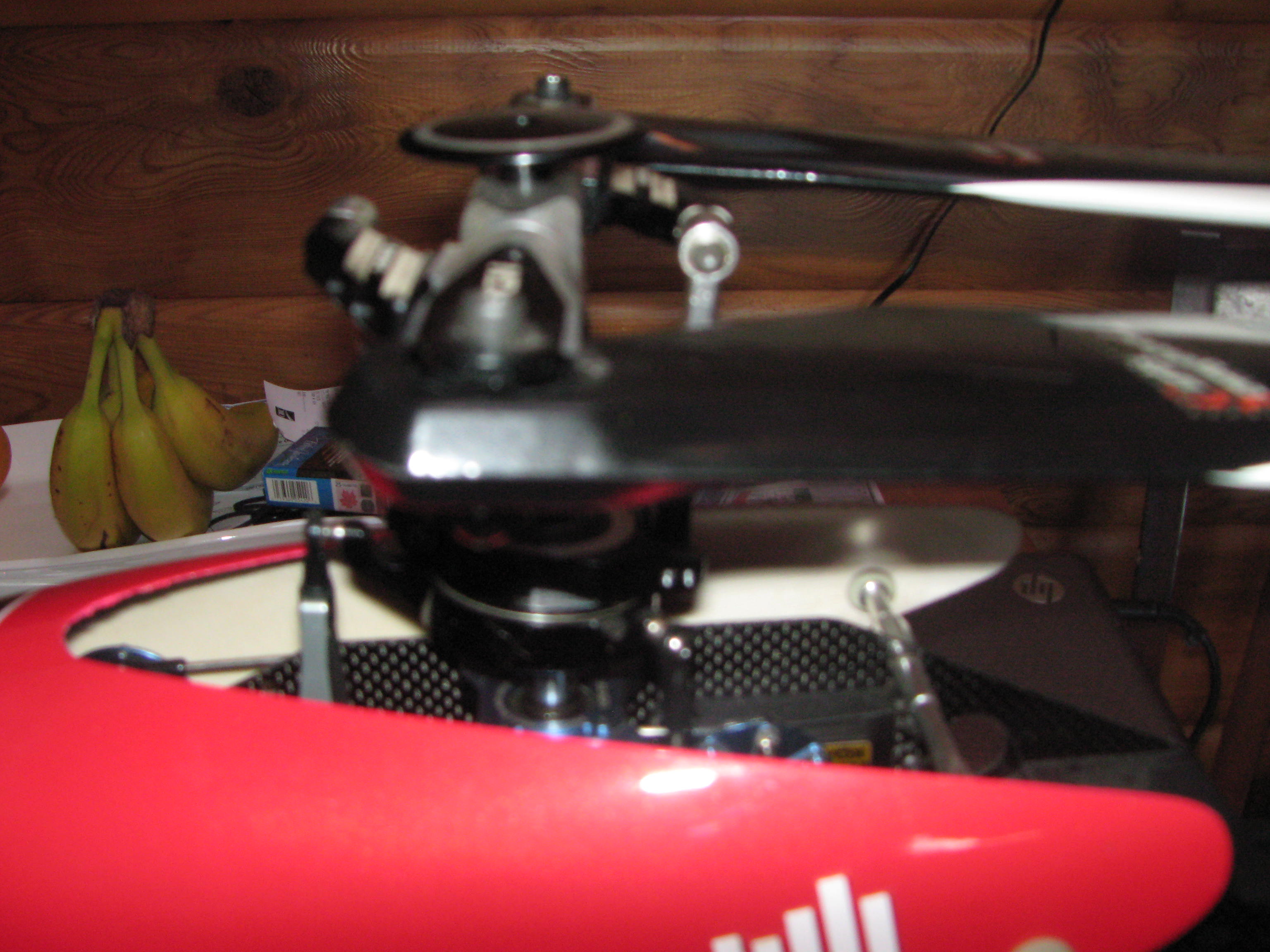

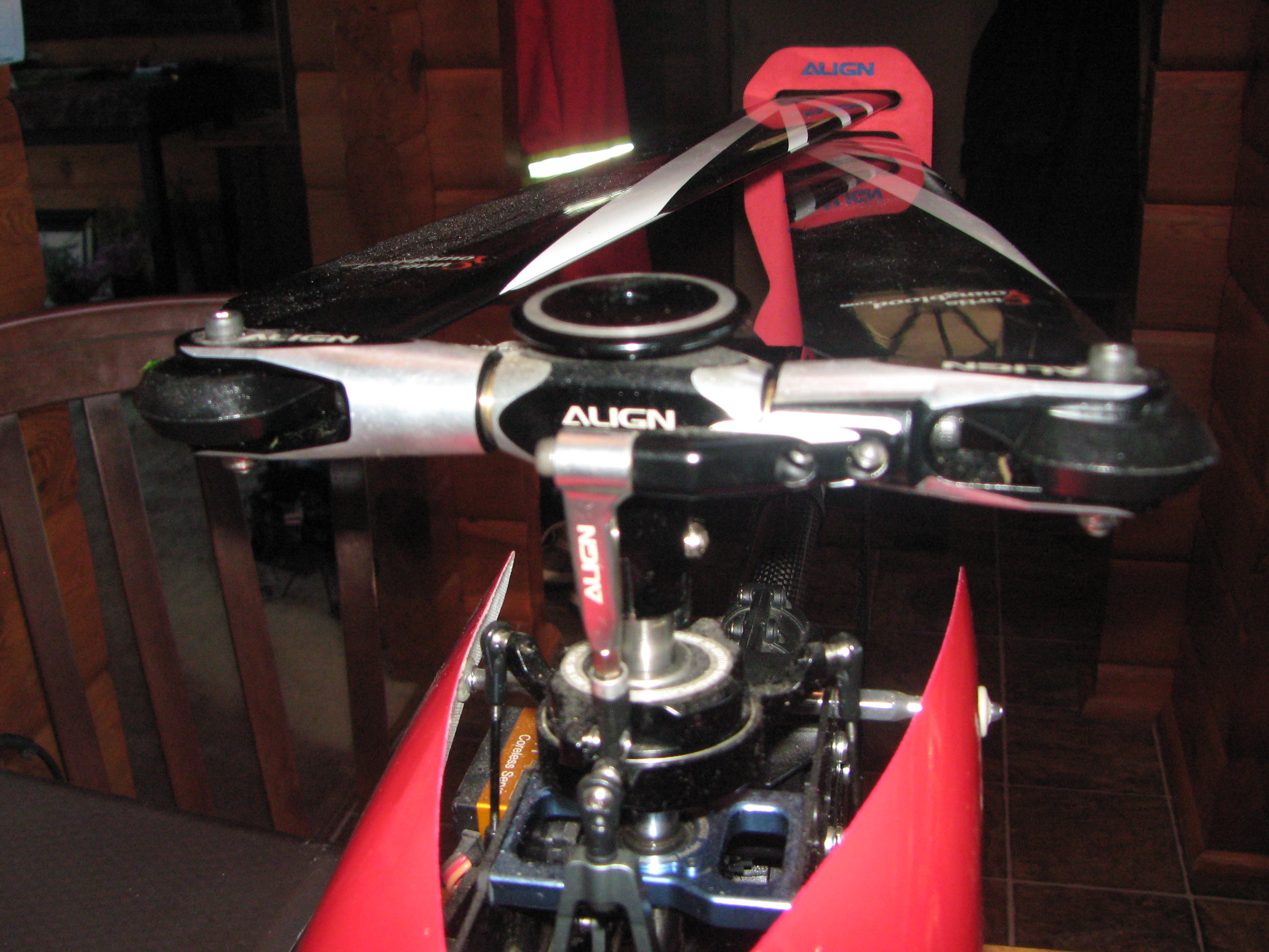

Dawiev
Posts: 139
Joined: Sat 28. Feb 2015 3:08:53
Blade grips on trailing or leading edge?
Perhaps post a pic of the head and swash.
john1127
Posts: 125
Joined: Mon 22. Jun 2015 5:50:05
blade grips on leading edge.
