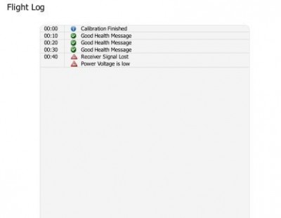

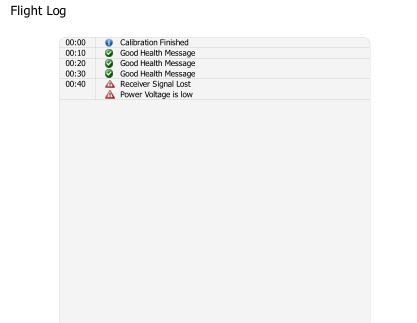

I make bec tester in your unit, and with bec to set 5v or 6 v, the unit and satellite, remains on, also led satellite is still on...nothing is restarted, but from the log I immediately find two warnings, one after the other: receveir signal lost and power voltage is low, but the radio remains to bind with satellite and the unit works perfectly. So there are some conclusions now?in the attachment you can see immediately after the bec tester in your unit.Thanks

I did other tests, I removed plug of the servos one at a time, when I did the test bec in your unit, and even with only one servo connected, I repeat on 4 servos I left only one connected, and from the log I find the warning: Power low voltage.a this point what you advise me? I will take the hobbywing esc 25A that you have advised me, I have no problem buying it, and at this point I build everything on a new helicopter, and I'm undecided which to take if a goblin fireball or an oxy 3.

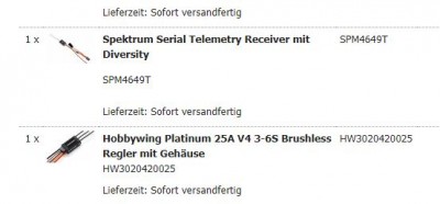

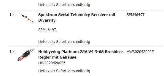

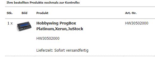

I bought the new spektrum 4649t receiver, and the regulator you advised me, and also the box for its programming. I followed your advice to the letter, if it's not okay I'll try to change servos, if not even with also the change servo,(now i have savox sh0257mg/sh0264 tail) I leave Spirit forever. I'm confident

Hello to all, I solved the problem of warnings in the log of the spirit about the low power and also signal lost, Thomas was right, was the regulator (talon 25 amp) inadequate, coupled with the servo savox 0255mg with old motor inside brushed. while i wait for my new regulator,(hobywing 40 amp v.4) next week, I temporarily installed an old esc align 60 amp with internal bec from 3 amps 6 volts, and magically when I test the BEC TESTER in the control unit, the warnings appear at the Low power, I do not find it anymore. So at this point it was the regulator. Now I only have an impression, but I have to understand why, although I have configured this regulator, well, (throttle calibration soft start and etc etc)I have the impression that the engine already at the tour is very strong, despite this engine can not pull more than 25 amps x 5 sec from the regulator, and despite having a simple linear curve of the gas in radio.this I did not understand why x now,but I have solved.
