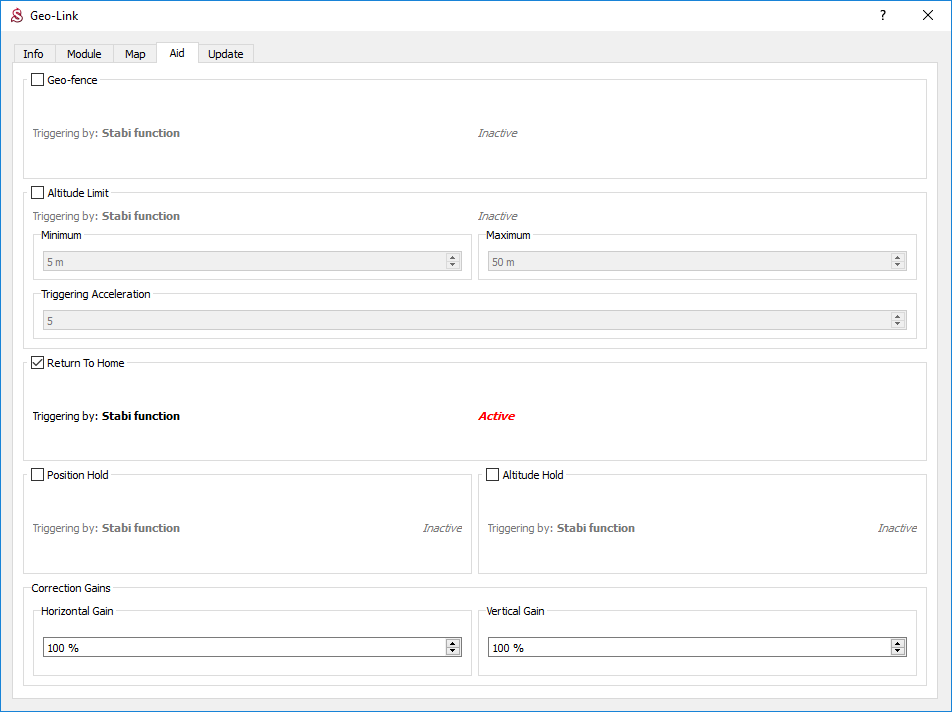

I turned off all aid features except Return To Home, i set return to home to be activated by Stability Mode. Geo Link displayed Steady Blue LED. Nothing happened. Attached is the .4ds file. Below will be additional pictures and a video.

Pic from Aid Page
Pic from Aid Page

Thank you very much for the details. It all looks great, which is even more strange.
