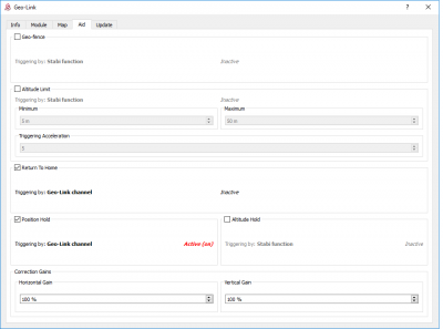

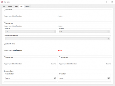

picture 2
Posts: 12988
all is looking well. The only problem I am thinking about is, that at the time of engaging there is no valid GNSS signal.
So you can make sure that before flying the GeoLink has blue light steady ON.
Could you verify it, please?
