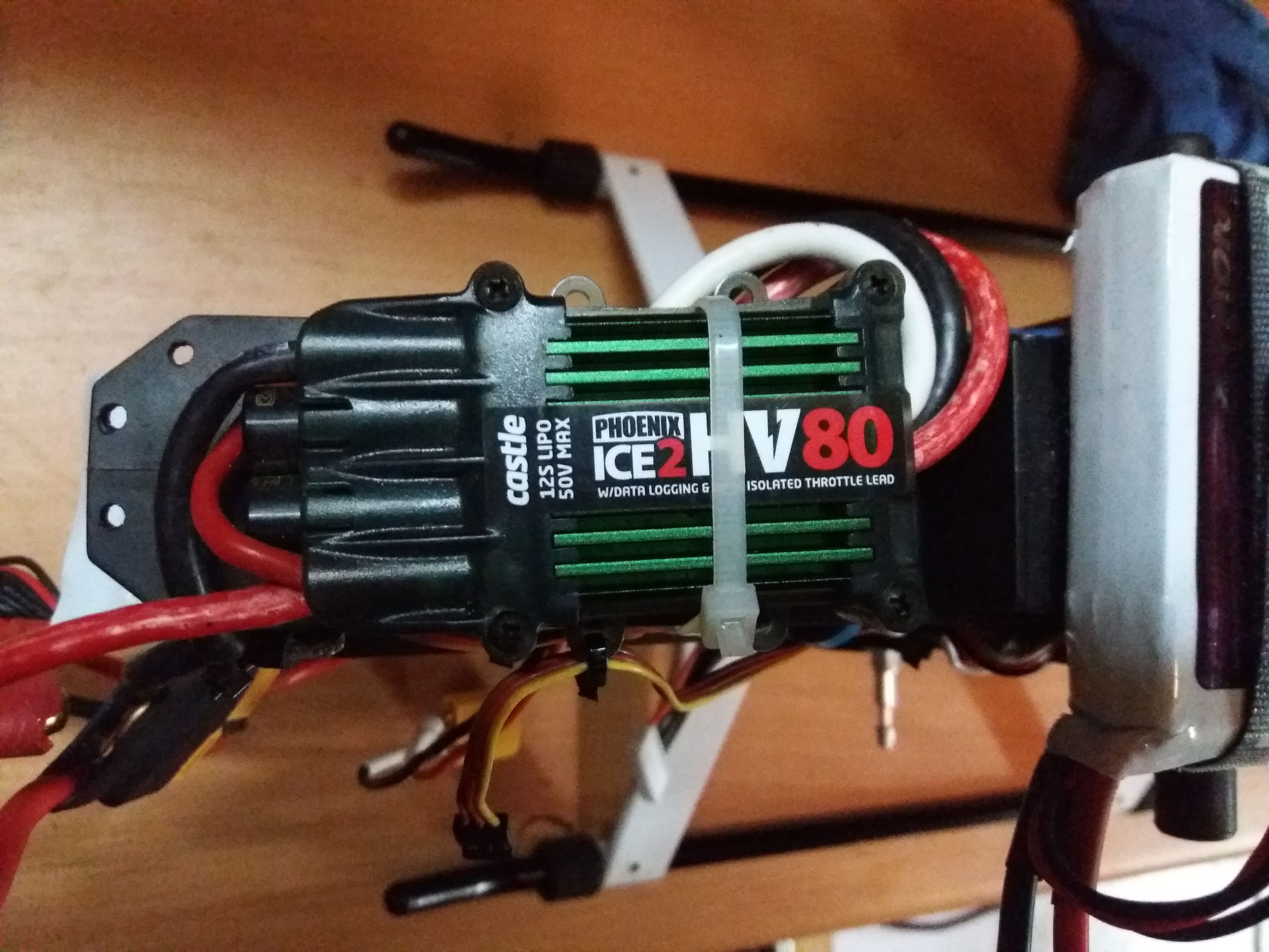

Today I got your Telem CC cable
cable the same negative result
I have worked without resistance and now
the result is positive :)
The telemetry data is displayed irregularly. Alternately correct and incorrect
Is that normal? :?:

ICE2HV80 I installed
Posts: 12928
Oh, unfortunately this model is not supported officially.
If I am not wrong some people had success with it, but sadly there are few differences from Edge/Talon ESCs.
Please see this table:
http://manual.spirit-system.com/index.p ... ted_models
It is possible that with a different resistance values it could be fixed. I would try for example approx. 20 KOhm.

with a resistance of 20 kohm, the telemetry indicator is steady, but the regulator does not run stably
I have now installed the correct regulator and everything is good
problem solved
