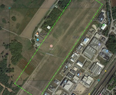

Hi i have same problem.
The rectangle which is genereated is not the one i need.
I need the rectangle rotated in the map.
Is there a way to rotate the rectangle in the map?
If not it would be really necessary to implent that feature, because without the Geo Fence is useless.
Here a picture from what i mean.
The yellow rectangle is what i need.

This is the exact problem i am having.
It's easy to set, and make a rectagle, but it will never form it where i would like it. Exactly as catdog has shown.
Logox2 are you able to set yours like that, with the rectangle lining up exactly where you would like it, or just an area roughly around where you fly?

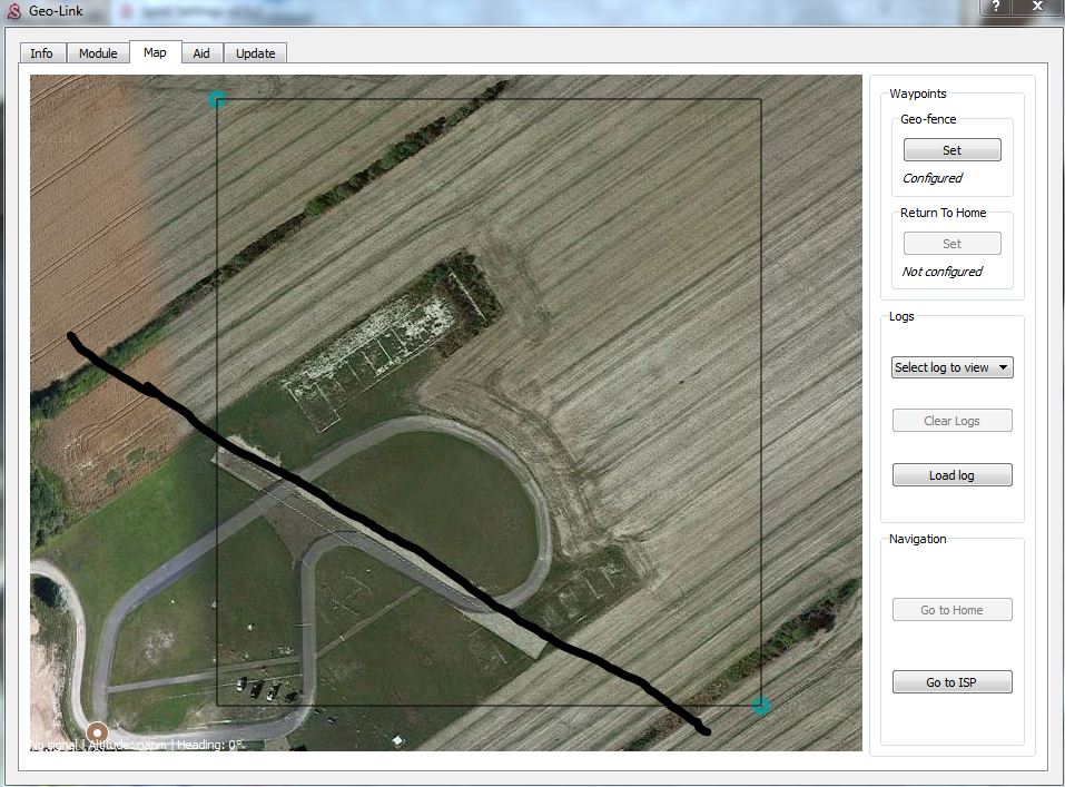

Such a rectangle to make along the impossible black line would require 5 points.

passe partout wrote:Such a rectangle to make along the impossible black line would require 5 points.
Why? All you would need is one side of the square you have made run along that black line.
From what I have tried, it almost seems like the 2 selected points i plot must line up either north south or east west.

Look at the both pictures above. These pictures shows exactly the problem. Sure u can make a rectangle which is big enough that the fligjt area is in it, but that is not the goal of a geo fence. The fence should be like my yellow line. My flight field isnt in a straight line from north to south or west to east.
