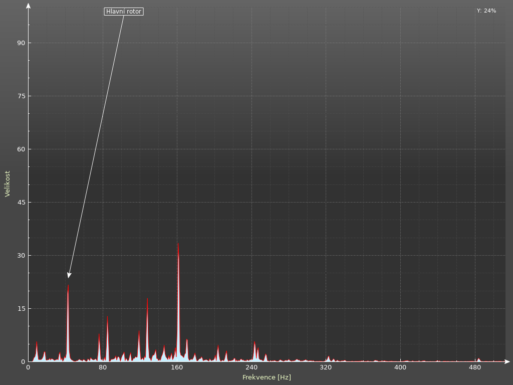

This is measured on the floor with all blades on, 2400 RPM. Looks much different, but I'm not sure what is to be expected with blades.
I misunderstood and thought you want me to put all blades on. I can try measuring with only tail blades, but will the heli not spin, is it safe? Probably safer than what I did, but just want to make sure..
I used the "In flight" option for safety, I hope this is fine.

Measure on the ground without blades. And a soft floor is better, such as a carpet.
I recommend to measure the ground without blades and you see.
Then in flight
This looks like unbalanced shoulder blades.

I did measure without blades, it's earlier in the thread. It looked fine. There must be sth wrong with the heli, but not sure what. I have no idea how vibes with blades should look like..

If it is without blades, try removing parts such as grips, head, etc. Make a vibration measurement after each part removed. When the vibration disappears, the part is bad.
Without blades the vibration should not be higher than 30-40.
Finally, to the rescue, in the other thread, the vibration has a big effect on the rescue function, so in this case it's the vibration, apparently.

As you see earlier in this thread, vibrations without blades are below 15, so this looks very well...
I would appreciate answer from Thomas when he gets time to go through the forum, if the vibrations measured with blades are good, or bad. I have no idea what to expect there.

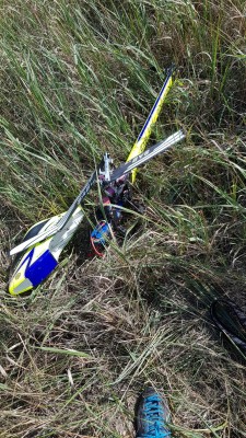

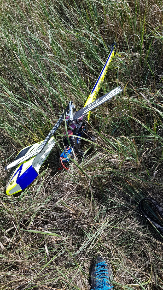

No problem anymore. I used the rescue and Spirit sent my heli straight to the ground :(
@Thomas I think there are serious issues with Spirit rescue recently. Maybe some software update ruined things. I say this because I also test this with another heli - freshly build Kraken. Heli flies great and seems to have no issue. But rescue easily gets 45 degrees off after some flying time. Not reliable at all as you see on the picture.

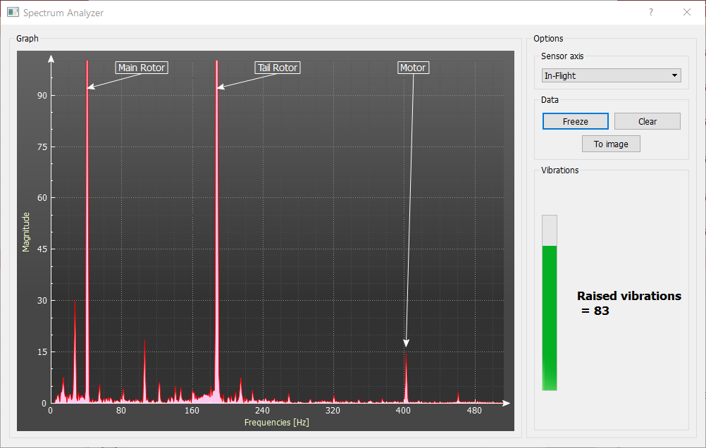

From the vibration plot I can only say the spike of the tail rotor is quite high. It shouldn't be more than half amplitude of the plot (50%) and 50% level in total.

Spirit Pro has better vibration resistance but with your red Spirit unit it must work well too. It can work perfectly also on nitro helicopters where vibrations are usually much greater. But sometimes also electric helicopters can produce very bad vibrations just from a bearings.
