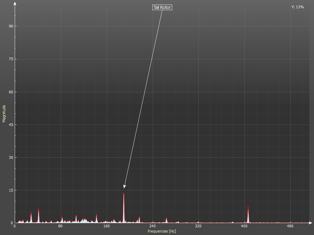

azaz44
Posts: 288
Here's what I get, done on the bench, no blades. RPM is 2400. This is what I use for flying, and which I had rescue problems with. I think it looks fine?

Posts: 12929
Can you measure with tail blades on?
Without blades it looks very well.
