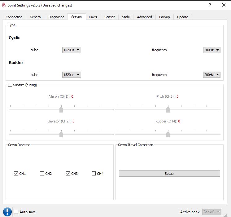

ok i agree, now i have the inverted plate set in the soft of unit, but i only had to reverse the aileron, in the radio, to get the correct movements.
You only use Reverse in the Radio to get correct movement in Diagnostic Tab. After that you Reverse the servo in the Servo Tab.

Hi Logo x2 I did it this way at the end, but now the aileron channel is inverted on the radio, and from the diagnostics tab "obviously" is inverted. now the movements are correct
Posts: 13057
This is wrong, channels in the Diagnostic tab have to move always in the right direction. Otherwise flight performance and functionality will be degraded.

Hi Tomas I ask you again your patience I don't come out of this situation. Practically on oxy3 choosing the reversed 120 plate, I have to invert a radio channel, (aileron)to have the correct movement of the aileron.ma every time I reverse a whatever channel on the radio, even in the diagnostic tab I find that the green slider in the unit diagnostic tab works the other way around. when I push the aileron stick movements to the right the slider goes to the left and vice versa. when I invert a channel in the radio the sliders in the Dtab work the other way around. How can I solve something else only ch2 has the exact match, then I have to merge ch1-to ch3-and ch3-to ch1.
if I connect the servo output ch3 in the plate diagram, with the input 3 of the unit, and of course ch1 output servo diagram with input unit ch1, the plate is all wrong, even with the reverse there is nothing to do.

Finally I solved !!!! in practice on the radio in my case I don't have to invert anything, but only to invert from the unit the ch1 and the ch3.now also in the diagnostic tab the movements are correct and consistent with those of the sticks. Thanks the same.

Yes, the servos should be connected according the Swashplate diagram. But when it was inverted servos were connected differently too.
