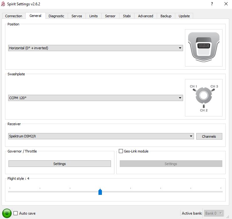

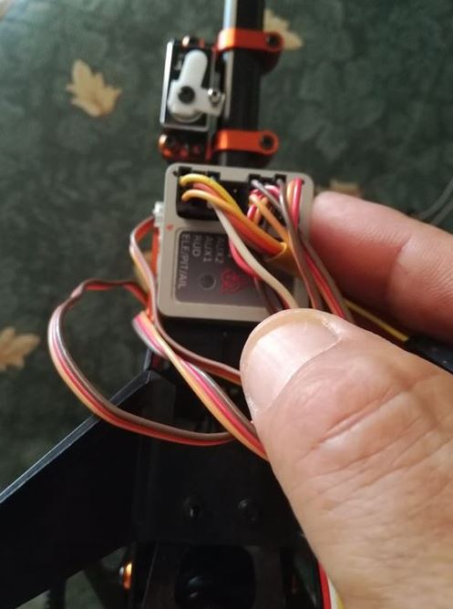

Thanks Tomas, for your answer, can you take a look if the position of the control unit is set right in the software? I then chose the swashplate normal, and not the inverted one, but then I had to invert only the elevator from radio.now the movements seem corrects .can you give me confirm by comparing the photos?
Posts: 12929
Swashplate should be CCPM 120 (Inverted) for this model. So unfortunately it is not correct and must be fixed.

Hello in another topic you had replied to a user that the oxy3 plate didn't need to be set up(inverted), but you have to invert a channel from the radio. At the end now I have inverted it, following the wizard and choosing the model is already inverted, but I always had to invert a channel from the radio, the elevator. if I don't choose the non-inverted plate, from the radio I have to reverse the aileron,and it works the same way.
Posts: 12929
I am afraid, but this was probably misunderstanding.
It must be always in the way the helicopter is built. Any other option is wrong. (even if servos are moving correctly)
Flying with a wrong settings will result in a bad flight performance and especially Rescue/Stabilisation modes will be unreliable.
Also channels in your radio must be reversed in the right way. Always according Diagnostic tab.
Pino74
Posts: 192
Ok
ok i agree, now i have the inverted plate set in the soft of unit, but i only had to reverse the aileron, in the radio, to get the correct movements.

Hi Pino74,
Yes the software setup is correct for the way your fbl is mounted, if it were on top the elevator would be revered and the aileron untouched. As for your servo noise I had that in both my Oxy 3 & Oxy 4 both using KST DS215MG V3.0 servos and by reaming all the plastic ball ends until they swivelled with no friction at all and they were quiet. Also make sure your swash is set up properly both mechanically and in the software and same with the tail mechanics and endpoint settings which may also stop the servo chatter. Good luck on your setup.
