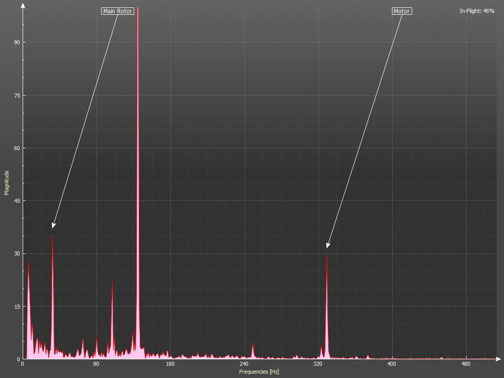

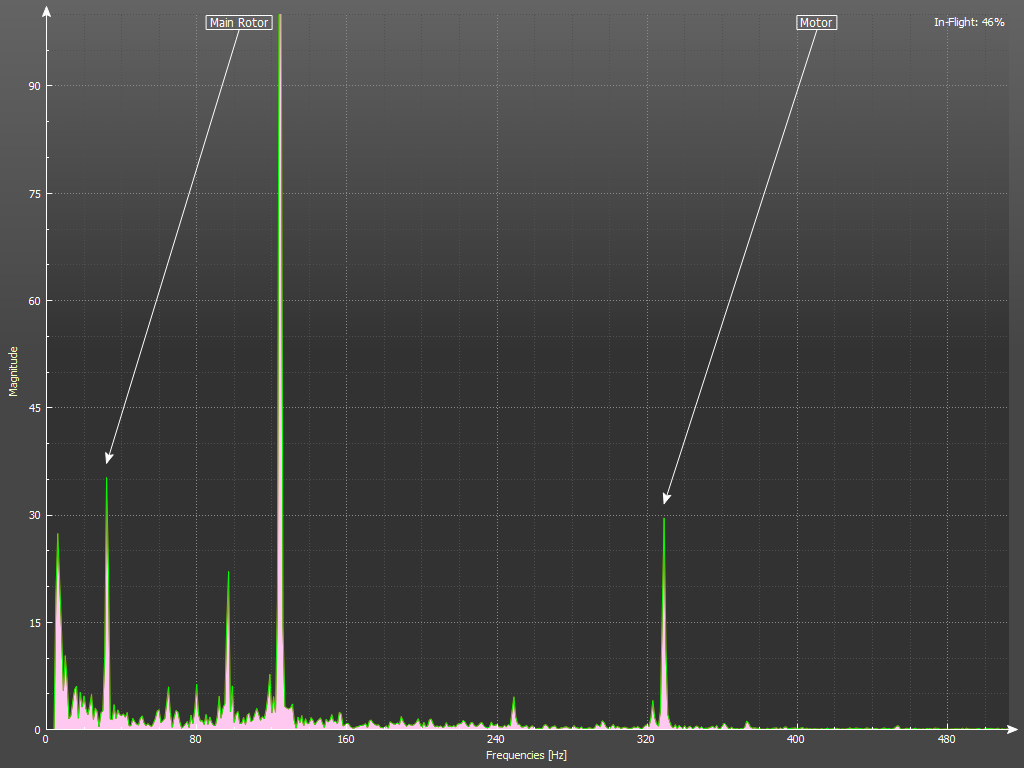

ok, I need help figuring out the vibration screen shot. My score for in flight was Green at 46..... but I have one spike high that is not identified.
See the screen shot and please comment on the screen shot. One thing.... I do have a set of fiberglass training gear on it... I noticed on landing that one of the four tie straps had broken.... I did not see it bouncing around though.
the spike is not identified as a component... however the tails is not shown so could this be the tail ??
the total score is ok though... no ???

the last plot is showing a resonant vibrations. These are the worst for the model and unit itself.
It is coming usually from parts that are not holding firmly or from belt. So belt tension could resolve the issue.
Usually these vibrations are happening at the tail rotor mechanics.
Anyway no spike should be higher than 50% of the plot.

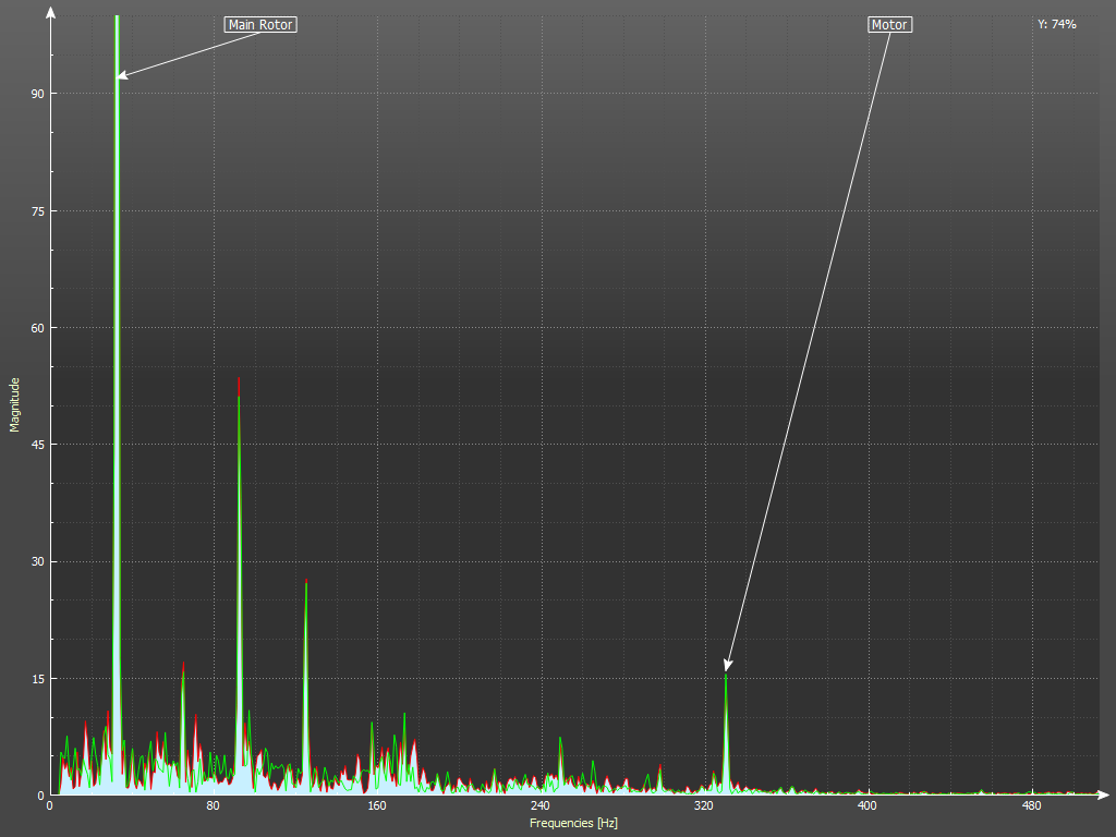

NO, not able to figure this out. I have taken one part off the heli at a time and ended up with just the motor and main shaft with the gears and tail drive box only. That is the last vibration diagram.... that is when the Spirit person said it looked like a resonant (??) vibration. I wish some one who is good at vibration reduction would jump in..... I would pay them to figure it out.
