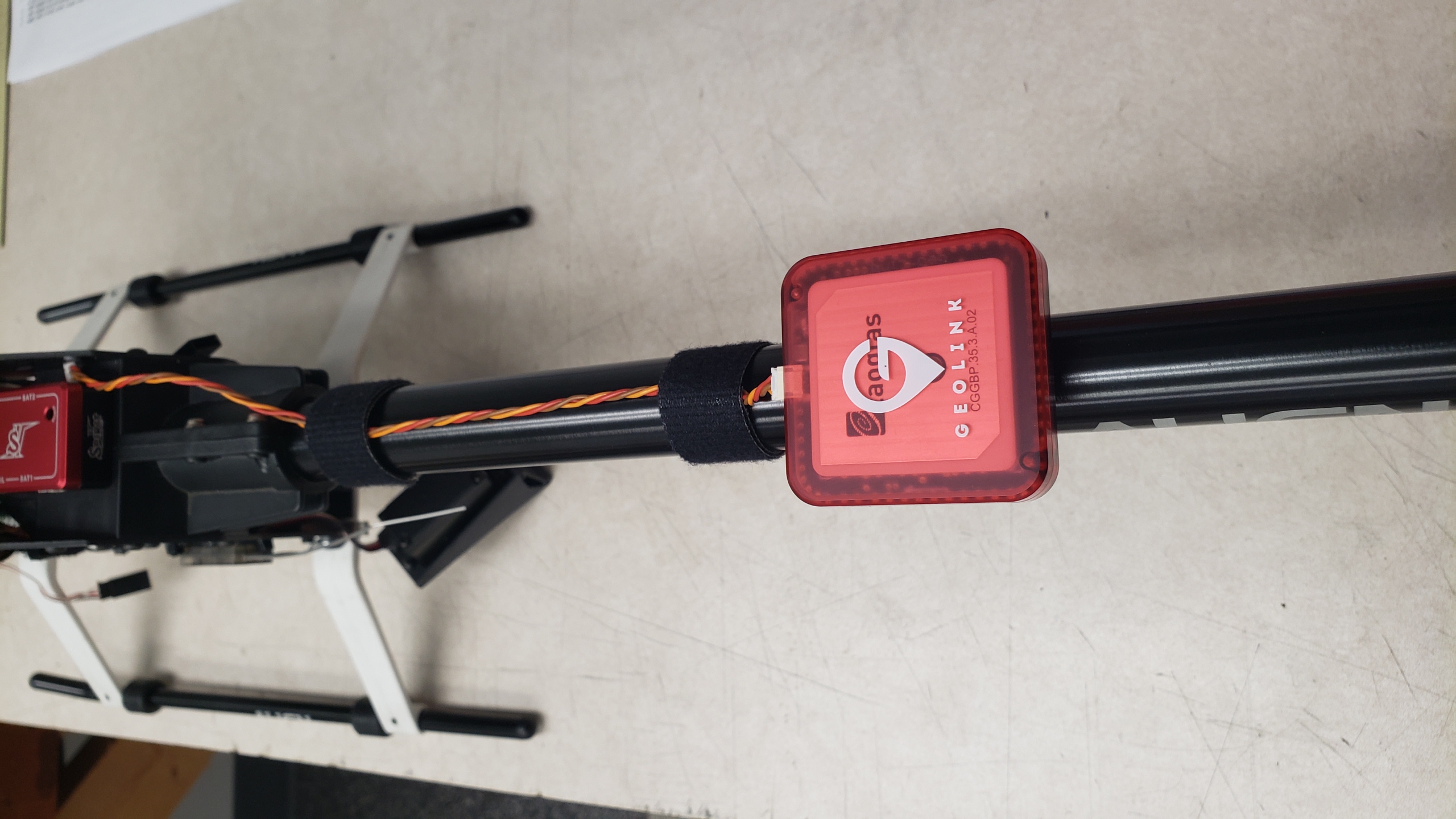

3. How the GeoLink is mounted at the model? Can you share a photo?
All this three points can cause that Position Hold (and other modes) might not work properly.

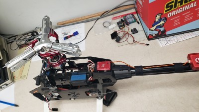

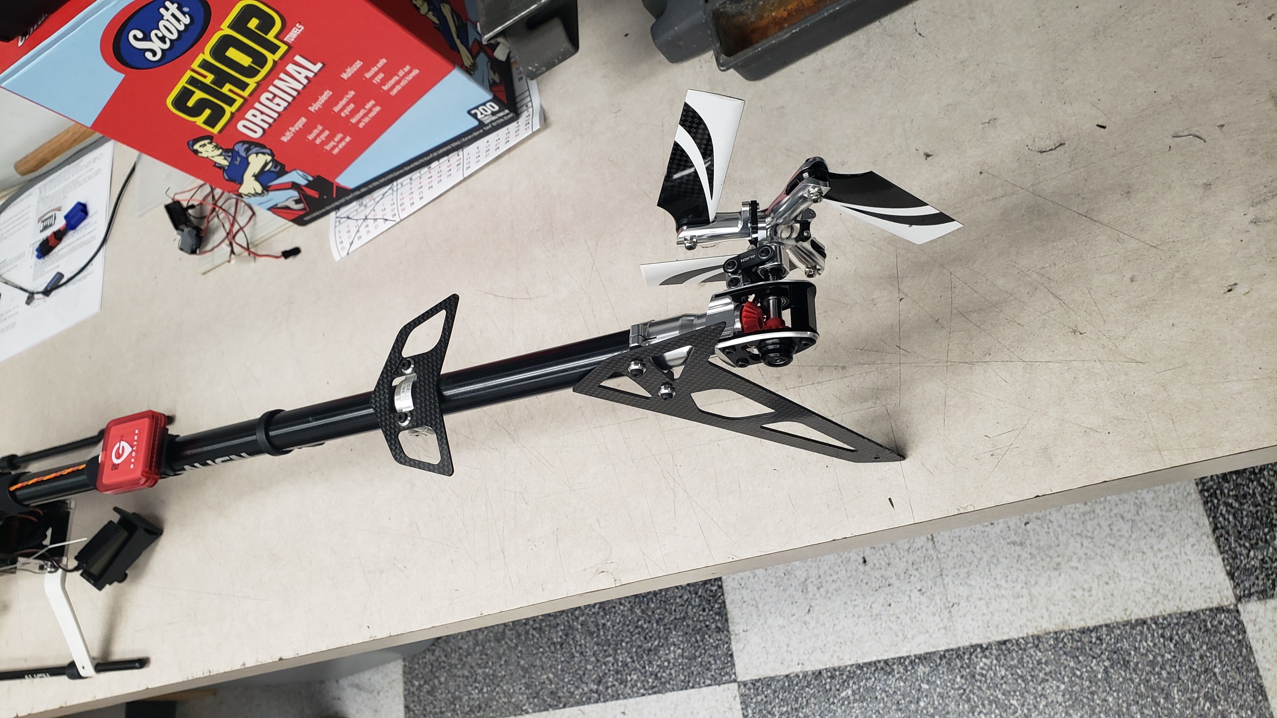

3. Pictures enclosed. The unit is mounted with your plastic mounting device and three small tie wraps through the holes in it and of course your sticky tape to hold it down.
there doesn't seem to be much vibration.
I have a Trex 550 with a three blade head and a three blade tail.

it looks good, thank you!
