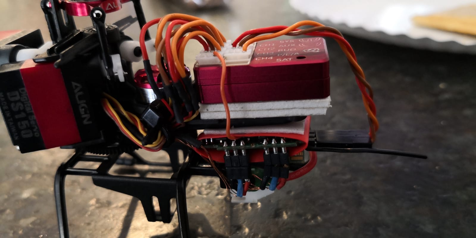

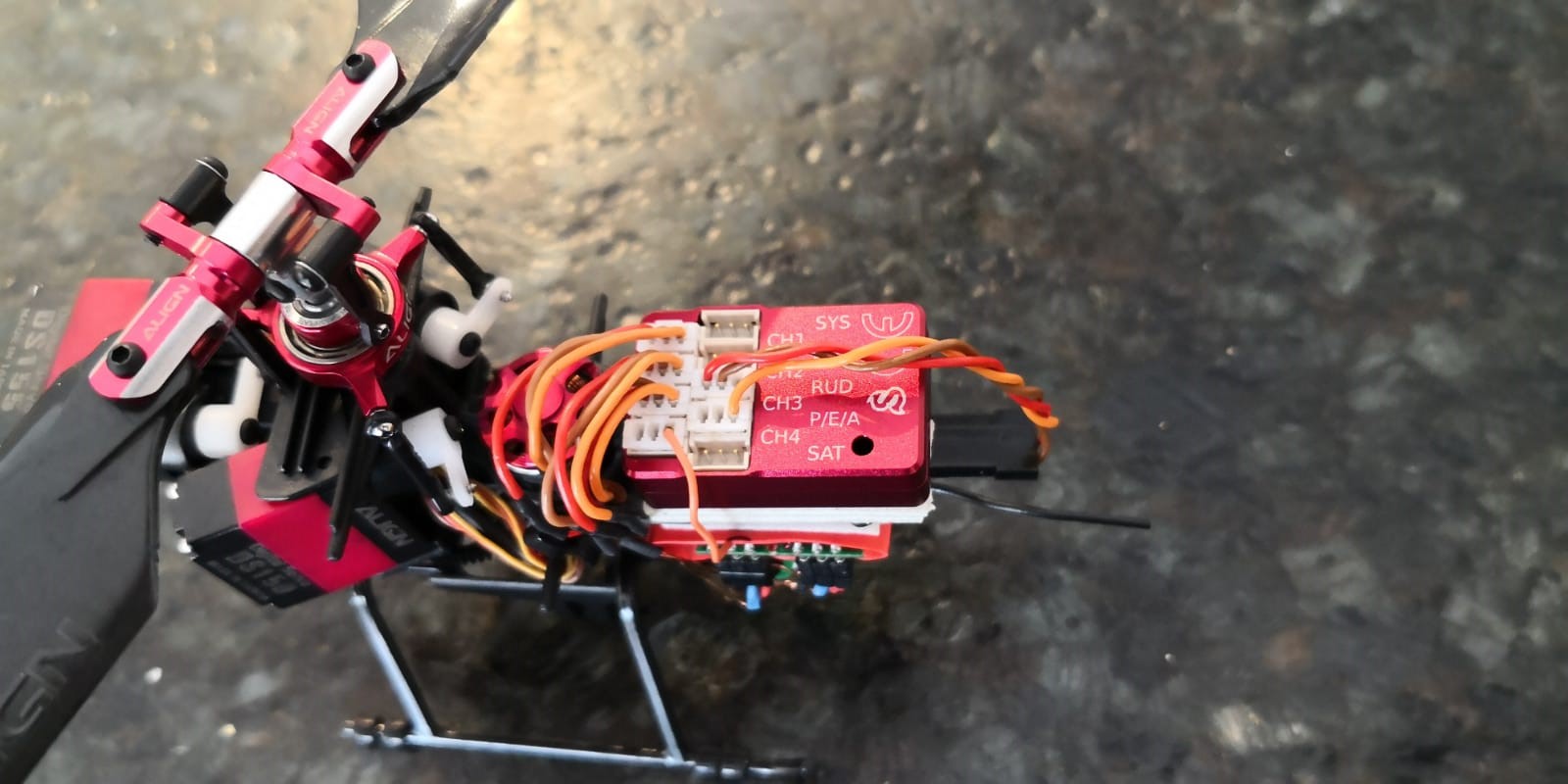

caven
Posts: 27
Joined: Sun 10. Aug 2014 20:15:44
Can you send photo how you install uspirit?

tomsl
Posts: 33
Joined: Tue 10. Sep 2019 3:02:10
Location: Whitehall Michigan USA
sorry i only saw it now
do you still need photos?
