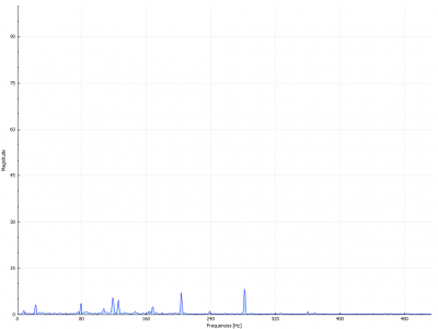

so fare I couldn't find a defect bearing - they are running smooth (I use ceramic precision bearings)
Vibs are O.K (20-30) as long as I don't have any blade grips on the spindle.
As soon as I mount them onto the head spindle vibs shoot up to 90+
I have weighted both blade grips with bearings inside and both have the same weight.
I thing the problem seems that I cannot 100% center the spindle with the blade grips on (obviously due to the dampers) - I have even replaced the dampers and blade grips without any success.I will order new bearings - maybe they only cause the vibs under the additonal load of the bladegrips (with bearings inside).
I've done a testflight with extended signal processing - some drifting was there but a lot better.What also didn't work was trying to make corrections during bail out - the heli hardly reacts on stick inputs (nearly nothing) althogh I've set highest stick priority. With BD3SX I was even able to change from inverted to normal if I wanted to. Is this also not possible due to the vibs?

These vibs make me cracy - one moment excessive vibes - suddenly also high vibes from the tail. then taking off the head again - pushing and pulling on the blade grips to try to center the spindle. Reassembling the head again and hardly any vibs at all?
For me this makes no sense.
Good. As I said there can be more strange things with Protos and vibrations.
For example you can get extreme aileron wobble during spoolup just because Main hub has small play on the main shaft.
For bailout it is the worst case, that vibrations are not constant and they are changing during flight depending on what you are doing.
This can induce inprecision because it can't sense helicopter movement correctly. For normal flight it is OK all the time.

Yes protos and it's vibs - permanently changing vib levels:(
I'm afraid I'll have unfortunately to live with that bad manner.
But in normal flight it feels so good with spirit-I feel so connected to it.
Should I keep extended signal processing?
Is the hardly reaction to stick movements also caused by the vibes or are reactions to
stick movements with spirit generally very low during bailout? Because on the work bench it works perfectly.

Vibrations does not affect flight characteristics, stick reactions are only dependend on the settings.
I am sure you can sort out vibrations pretty well, I have Protos too, but it can be tricky sometimes.
It should be all below value of 50.
