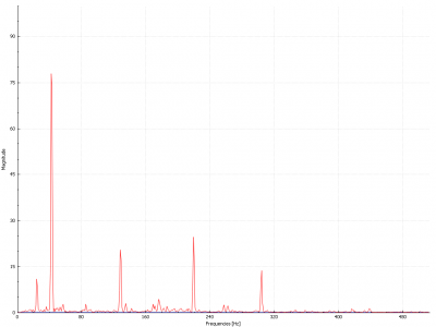

hi,
just checked vibs and I definitifely have some problems with vibs.
Overall level seems to be o.k. with a value of26.
But I seem to have a problem with the main gear/shaft/bearings head:
peaks of 77 - 90 on rpm 2000 (33hz).
So I will have to check out the reason for that.
thx a lot

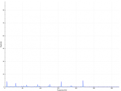

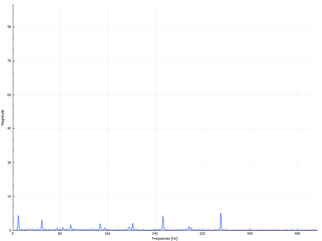

I've no clue where the vibes have come from.
I have taken off the head from the main shaft and vibs have been gone.
Then I've reassembled the head to the main shaft and vibs have still been gone.
It's a miracle.
I'm really keen on testing tomorrow whether drifting has also gone now - I'm really curious about it.
thx again for the hint
Posts: 12920
You can check 3 bearings that are holding main shaft.
