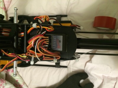

Ok, I pulled the unit off my G570 and will put it on the logo. What is the best location on the FBL tray for the unit to be mounted? Should it be as close to the main dhaft as possible or does that not matter?
OK. It does not matter where the unit is, it must be only perpendicular to all axes.

Jman841
Posts: 215
Ok, all set back up. I switched it around so the wires are facing to the main shaft instead this time. It's lined up the best I can get it. You can see the reference line in the picture.
We will see how it goes when I fly next.
