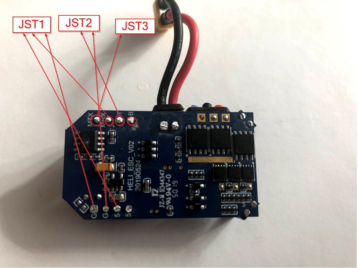

Many thanks man!
Did I get you right?
fassla
Posts: 54
Joined: Sat 20. Jul 2019 21:06:40
correct, you do not need ground for tail signal on any of the available FBL systems (JST2 is sufficient to hold signal cable)

I am now trying to figure out why I don`t get the current RPM value through that MTX pin.
I plugged that into P pin of P/E/A port of uSpirit and I get no output.
Also I counted 24 poles in the sunnysky motor => 12 value in sensing divider, right?
HeliMLM
Posts: 370
did you plug into middle pin? i would say the manual could be misleading in that point...it says: „μSpirit - P pin - pin in the middle of P/E/A port“… but maybe i am wrong… do not know microSpirit.
cheers
Michael
fassla
Posts: 54
I think Tomas needs to have a look on it. Neither P nor E on uSpirit is delivering a RPM value

fassla wrote:I think Tomas needs to have a look on it.
Okay, but is your setup reading the current RPM?
fassla
Posts: 54
for some reason I use the OMP ESC on a different FBL system....and there it is working as I showed to you
