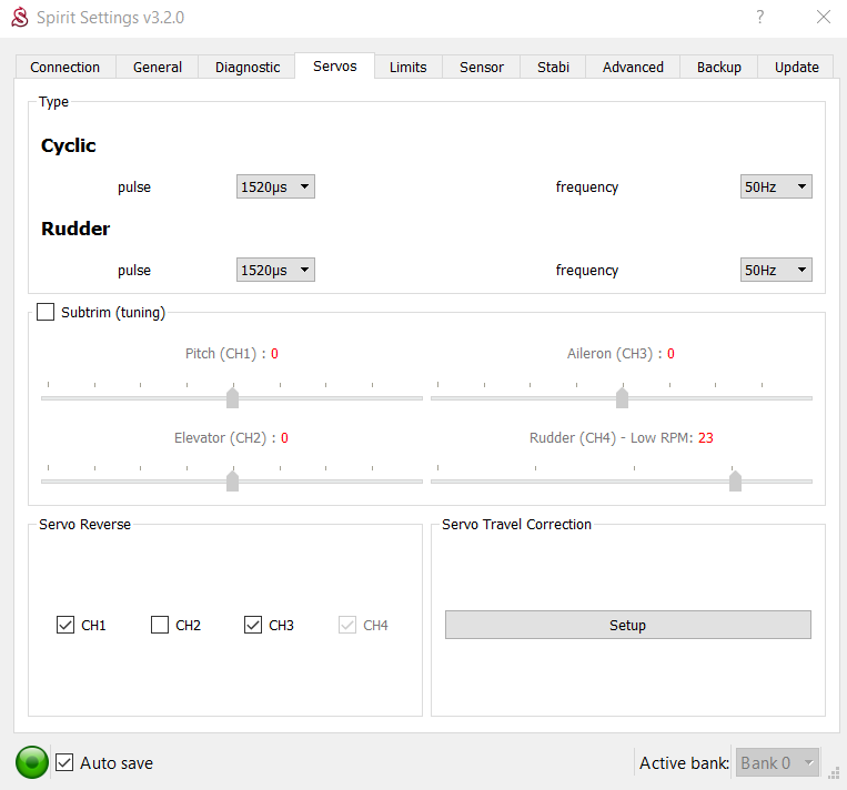

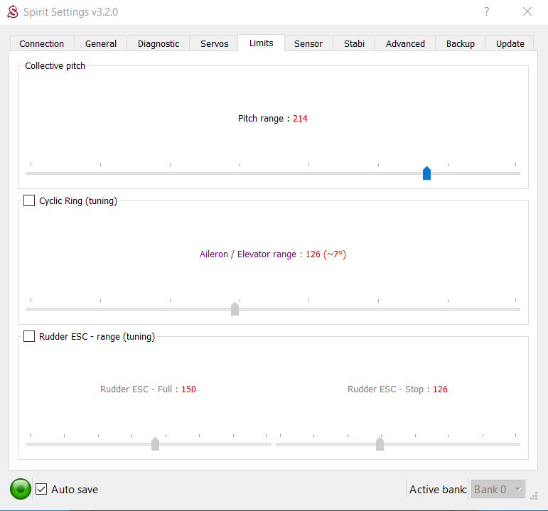

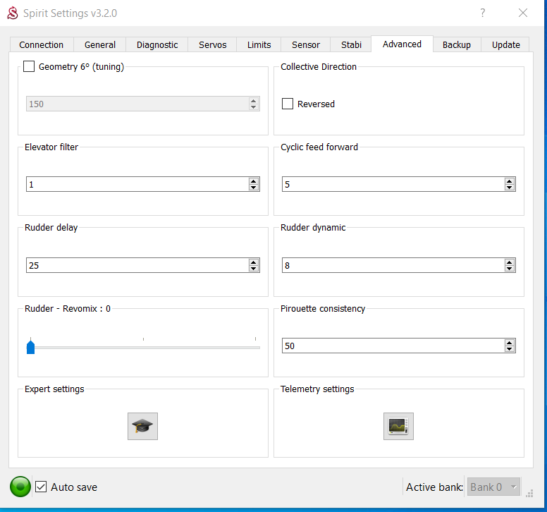

Here are some relevant screenshots in software
Where could be the problem?
uSpirit severe tail wag - motorized tail
Please set Priouettte Consistency to value around 80. Then it will be much better.
Then please decrease it even more and also increase Rudder Delay to for example 25.

Lowered params to this:

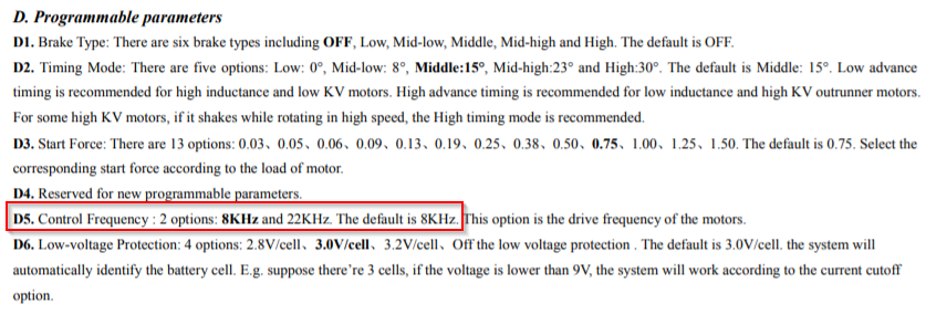

From the ESC manual I get this:
I tried switching to 22kHz but now I`m not able to properly find ESC endpoints with the sliders.

the frequency on the ESC is not the factor which is important but the timing.
But mor important are the setting in spirit software for frequency, and funny but true the rudder delay.
What are your parameters here ?
