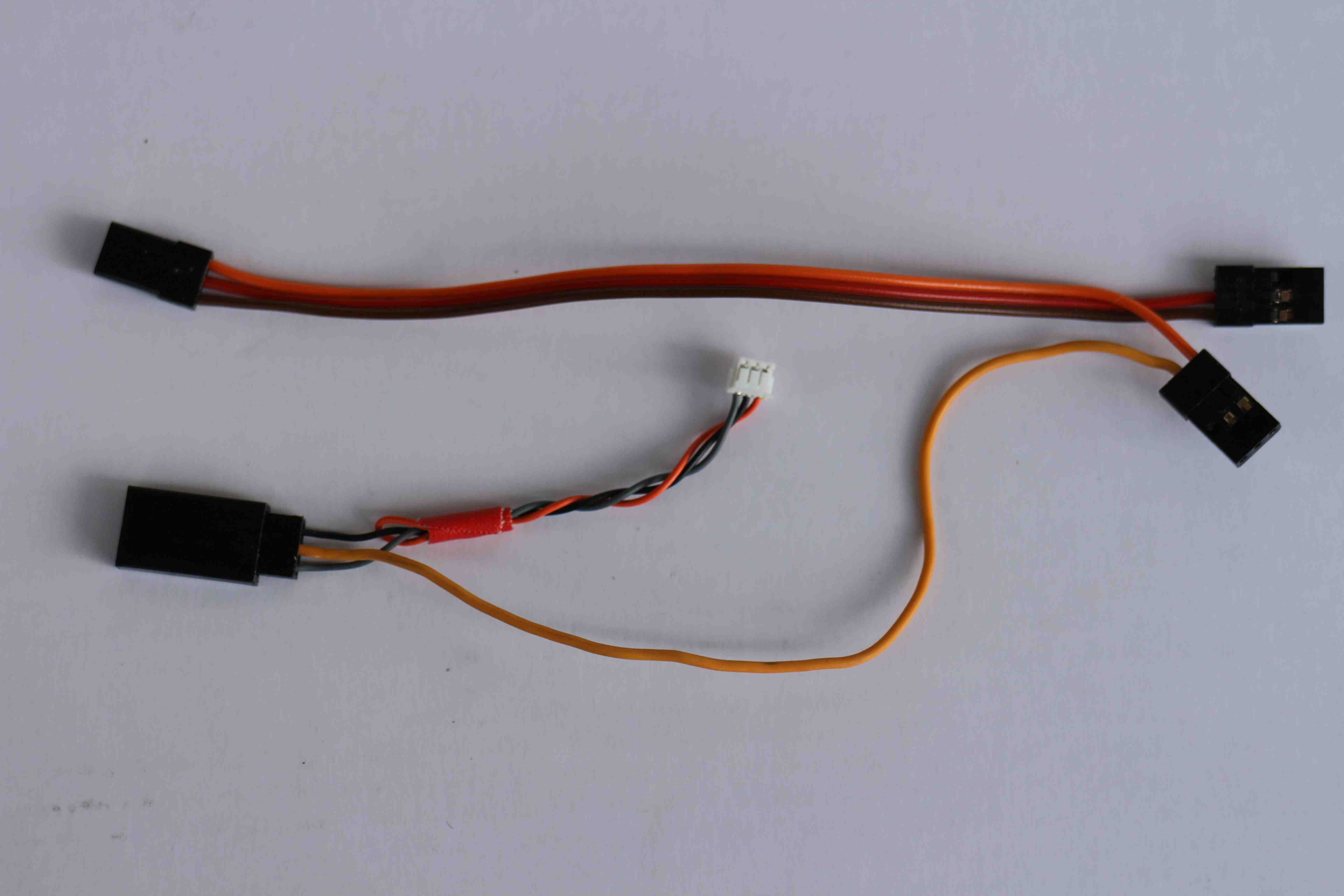

Kluftinger - can you maybe post some photos of your setup and how this was connected?Kluftinger wrote:YES! It works.

I'm afraid there are so many wires on these fotos and they are therefore not very helpful
Let me try a detailed description:
Fist step: connect the SRLX2 receiver according the manual
http://manual.spirit-system.com/index.p ... wiring.jpg
Second step: modify the recommended adapter for the YGE connection.
http://manual.spirit-system.com/index.p ... -servo.png
There are two ways to do it:
A: cut the red wire at the little white connector which plugs into the Sat1 port
Crimp a servo connector which fits on a pin to the end of the red wire
Then assemble the new connector into the center position (PIT) of the outboard signal connector from Step 1
B: if you don'thave a crimp tool use a 10cm servo extension
Disassemble the female servo connector of the adapter from step 2
Remove the center pin (red wire) and cut it off at the little white connector
Disassemble both connectors of the 10cm extension
Remove the outer yellow and black wires
Now put the matching connector of the red wire into the center of the YGE adapter servo plug
Finally assemble the matching connector into the center position (PIT) of the outboard signal connector from Step 1
Why the red wire (rpm signal) from the ESC goes to the PIT pin is described on the http://manual.spirit-system.com/index.p ... e=Governor page.
