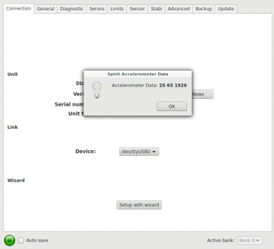

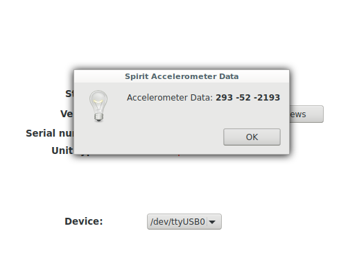

...sooo...I tested. it says... look at the two screen shots.
holding in hand, upside down.
Sitting on the table.

Posts: 12836
Hello.
It is enough to press CTRL+ALT+SHIFT+U to reset accelerometer calibration to default. Normally this should never be needed as it was factory calibrated.
It look like someone did the calibration previously but improperly.
Your Spirit unit is already many years old so it is hard to tell what was the history.
Anyway it is sure it can be resolved easily after checking all the particulars.
If the procedure above will not help then the problem is in your servo wiring. Even if your model can fly well, it does not mean your servos are plugged correctly unfortunately. It is still possible to ignore servo reversing description and find "working" way. But this will always give bad results including wrong rescue direction.
