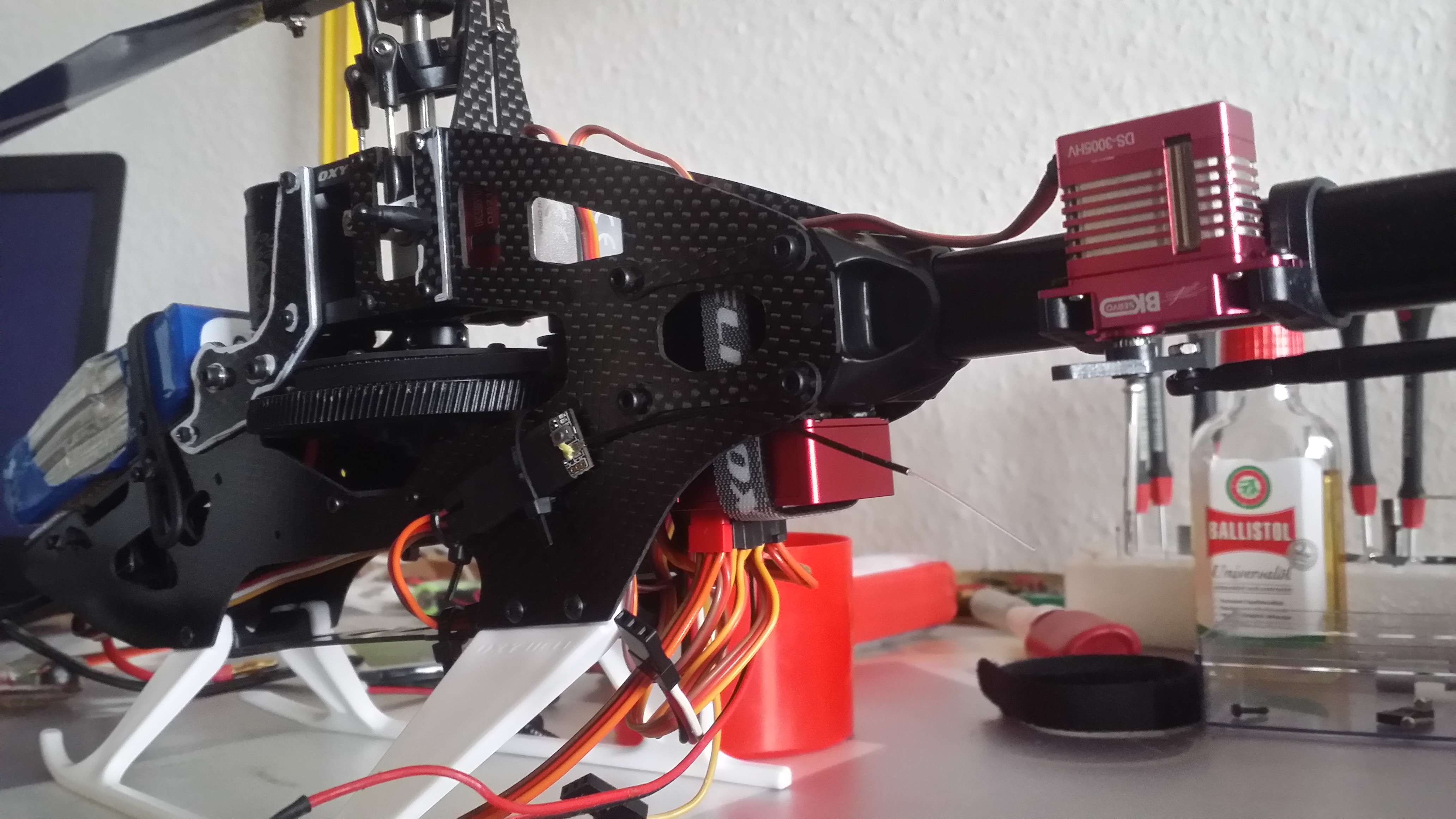

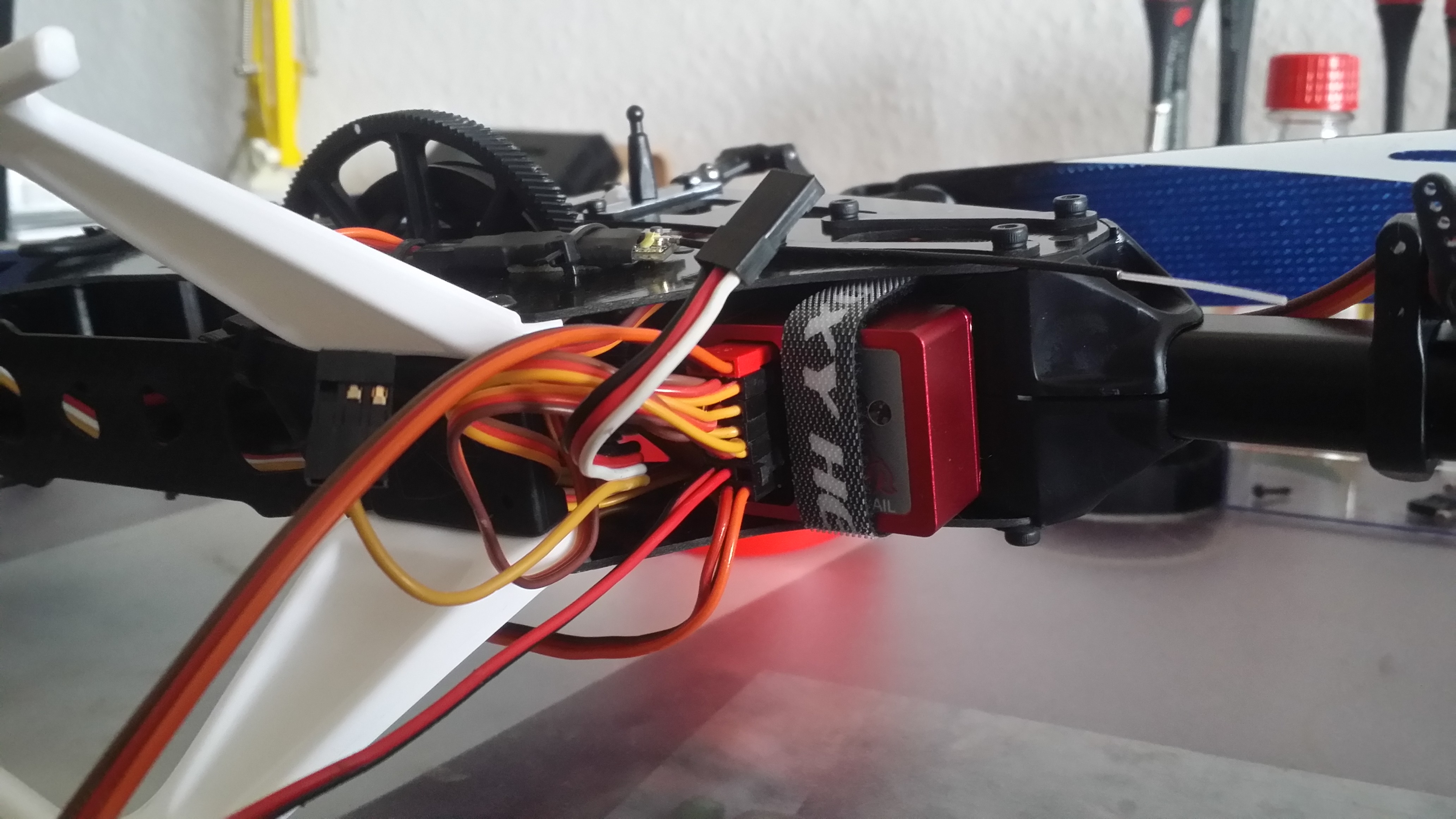

Here 2 pics and the settings file.

Orientation and settings seem ok, but the order of channels in the SW General / Channels tab is non-standard for s.bus. Can't there be chaos in the reverses in the transmitter and subsequently in the SW?
