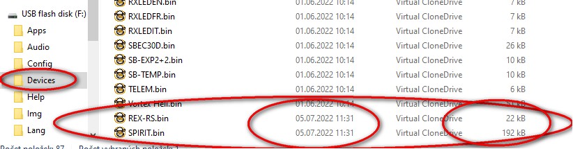

Posts: 13048
please try to download and copy new BIN files:
https://spirit-system.com/dl/jeti/SPIRIT-3-4-1.zip
Alistair
Posts: 9
Joined: Mon 04. Jul 2022 5:47:35
Hello! I copied the new BIN files to the Jeti. These appear to have resolved the interface errors. See screenshots below. Receiver is recognized, firmware version is displayed correctly, no errors in the integration. I ran through the setup wizard to check everything. All seems good. Rescue by function is good, telemetry is available. Then tried to bench test the functionality of the Heli.
