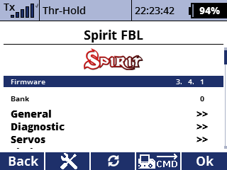

I have a problem that I have not been able to clear. First time Spirit user needs help please.

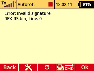

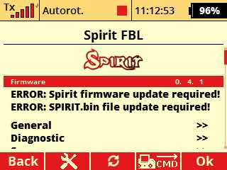

Jeti shows Error:invalid signature for device REX-RS, and does not show correct version on firmware in integration with errors. New Spirit GTR, first set up, never flown. These errors occurred immediately.
Jeti is DS-16 G2 - fully updated.

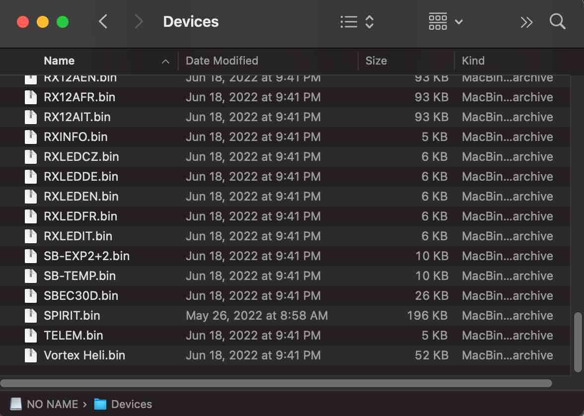

I have now updated GTR to v 3.4.1. I have loaded latest Spirit.bin and REX-RS.bin files (downloaded today) to Devices on Jeti. The errors are still present. All screenshots below.
(As shown in Devices folder on Jeti - Spirit.bin file 26-May-2022, REX-RS.bin file 23-Sep-2021)
How do I fix this please? Any help is very greatly appreciated. Thank you.

Posts: 13048

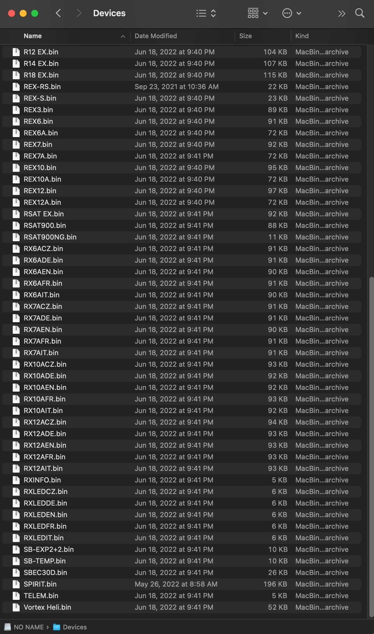

Can you let me know what firmware version is installed in the radio?
It seems also that REX-RS.bin file is missing in the Devices directory.

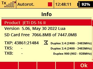

Thanks for your quick reply.
Jeti version 5.06

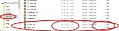

REX-RS.bin is present. Sorry I cut it off in the previous screenshot.
Posts: 1068
Spirit.bin from May 2022 is old in your tx and also Rex_RS.bin from 2021 is very old.

Hi Habasek, thanks for your reply. I thought that might be a problem. But I download the zip file from the website only 3 days ago. The files on my TX are the newly downloaded files.
I just checked again today in case it changed after the release of 3.4.1. No change. It is still the same files I have loaded on my TX.
Best regards, Alistair
Posts: 1068
The version archive 3.4.1 bin is only 1 day old. Download it and copy (rewrite) the entire unzipped contents to Devices in your radio. Update via Jetistudio is not a solution, but Jeti does not have new versions of other parties in the updates (Spirit and others).

The files you have are recent. They are really from May for version 3.4.0. There is no 3.4.1 yet.
For me it look like there is some problem with communication between unit and receiver. I never saw the issue earlier.
Maybe you are using some special configuration for the receiver?

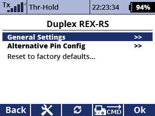

I believe the configuration of the receiver is standard. The errors have existed since I first connected it and opened the Jeti integration. I can program the receiver from the Jeti or PC. The Jeti can read the settings of the receiver. But the errors are still there. Makes me wonder if the root of this is more about the Invalid signature error reported with REX-RS.bin? interesting how the GTR firmware version reported on the Jeti is 0.4.1 and not 3.4.1

maybe a year ago i was running into a similar problem (just on one of our 2 DS-12s) after a Jeti DS-12 firmware upgrade. did not get it to work whatever i tried. then i completely deleted all the Spirit integration files on the DS-12, did a reboot of the DS-12, re-copied the Spirit integration files, did another reboot of the DS-12 and it worked. no idea if it helps with your problem... but maybe it's worth a try as i does not take long :)
