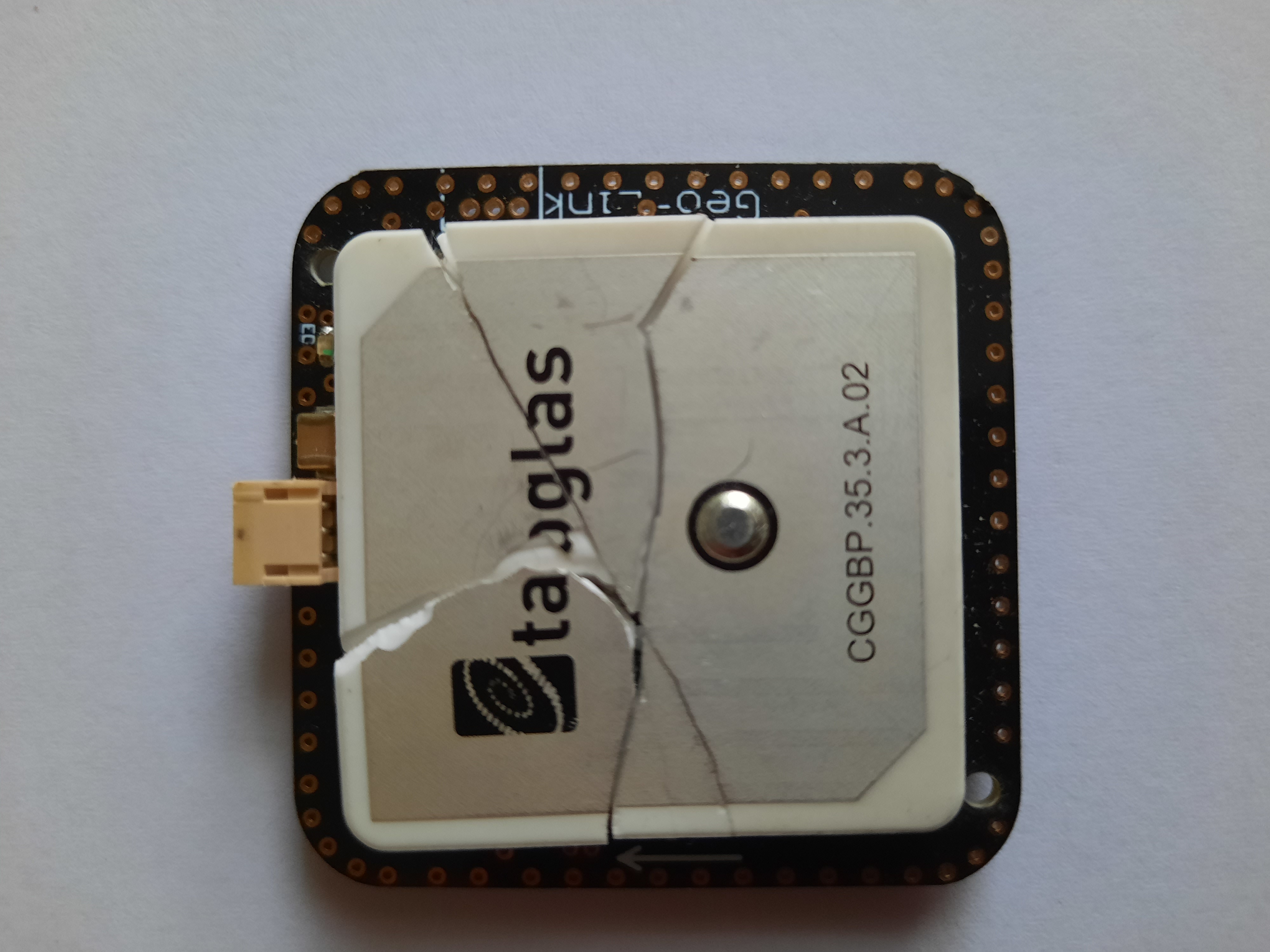

Heli crashed after rehearsing the 2 rescue altitude settings

I repaired the heli and installed another Geo link and readjusted it.
Would like to ask you to check the file if everything is set correctly now.
