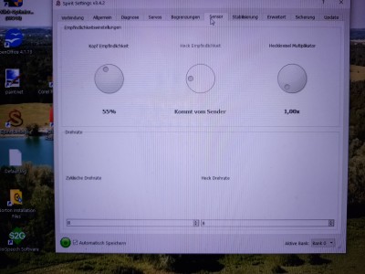

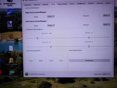

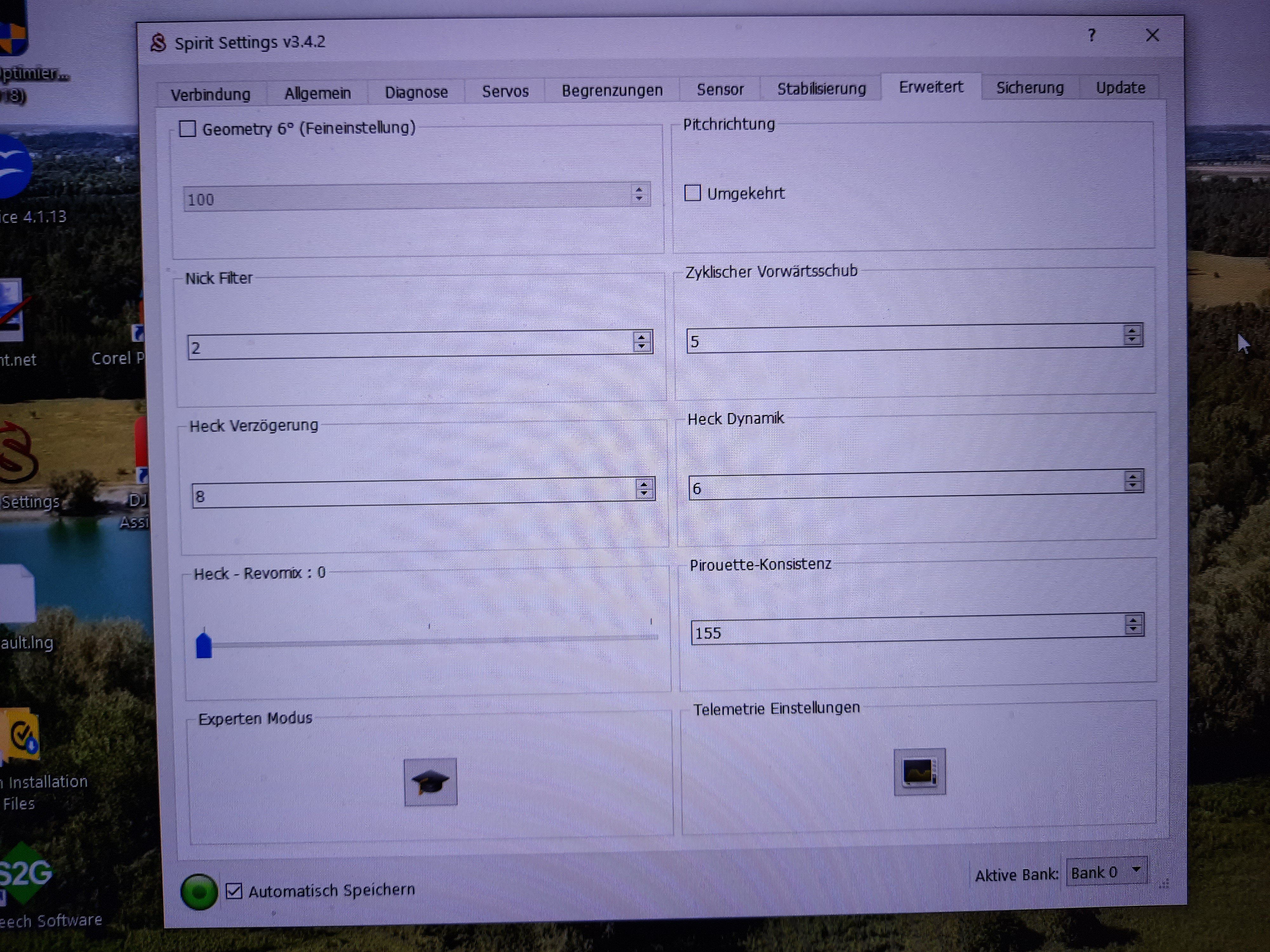

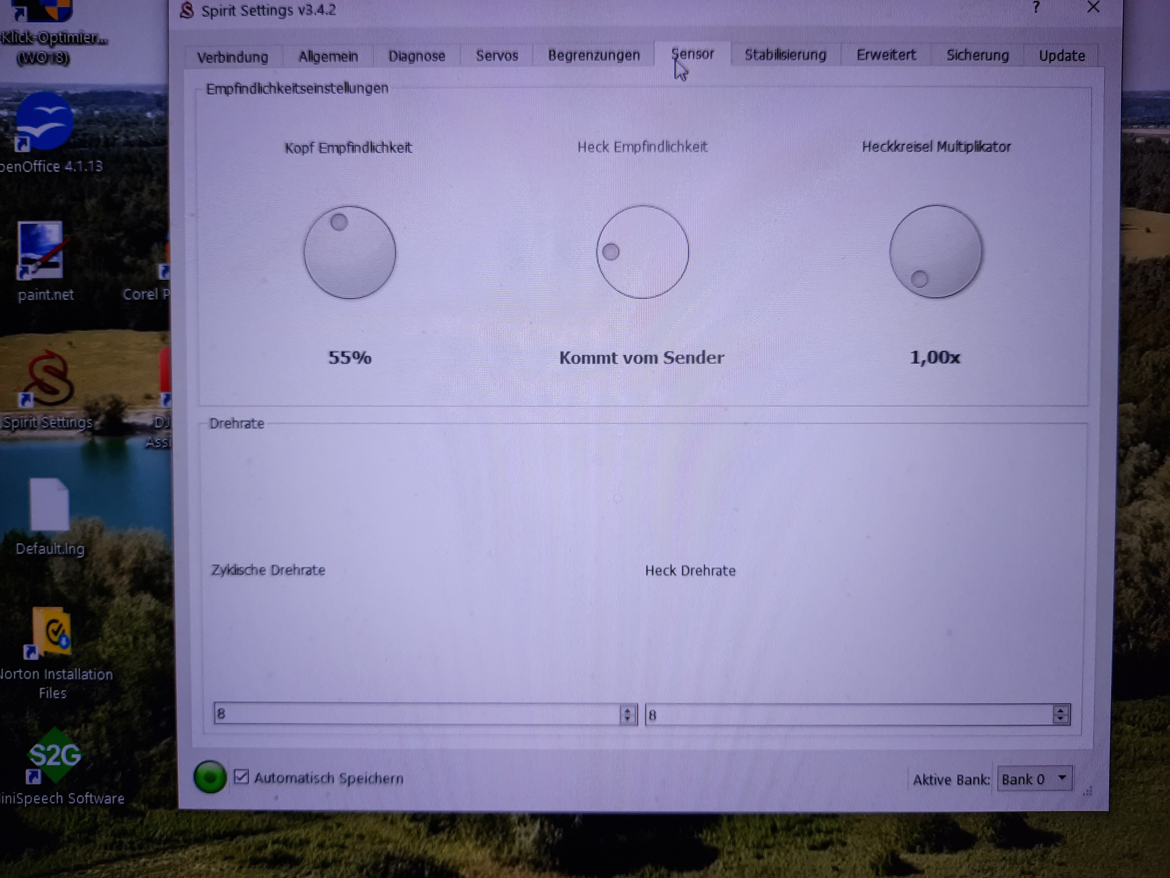

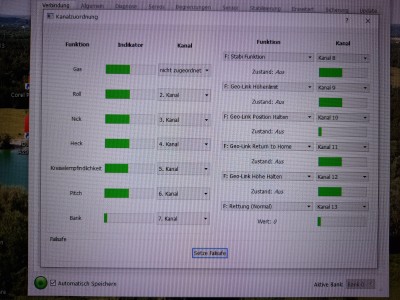

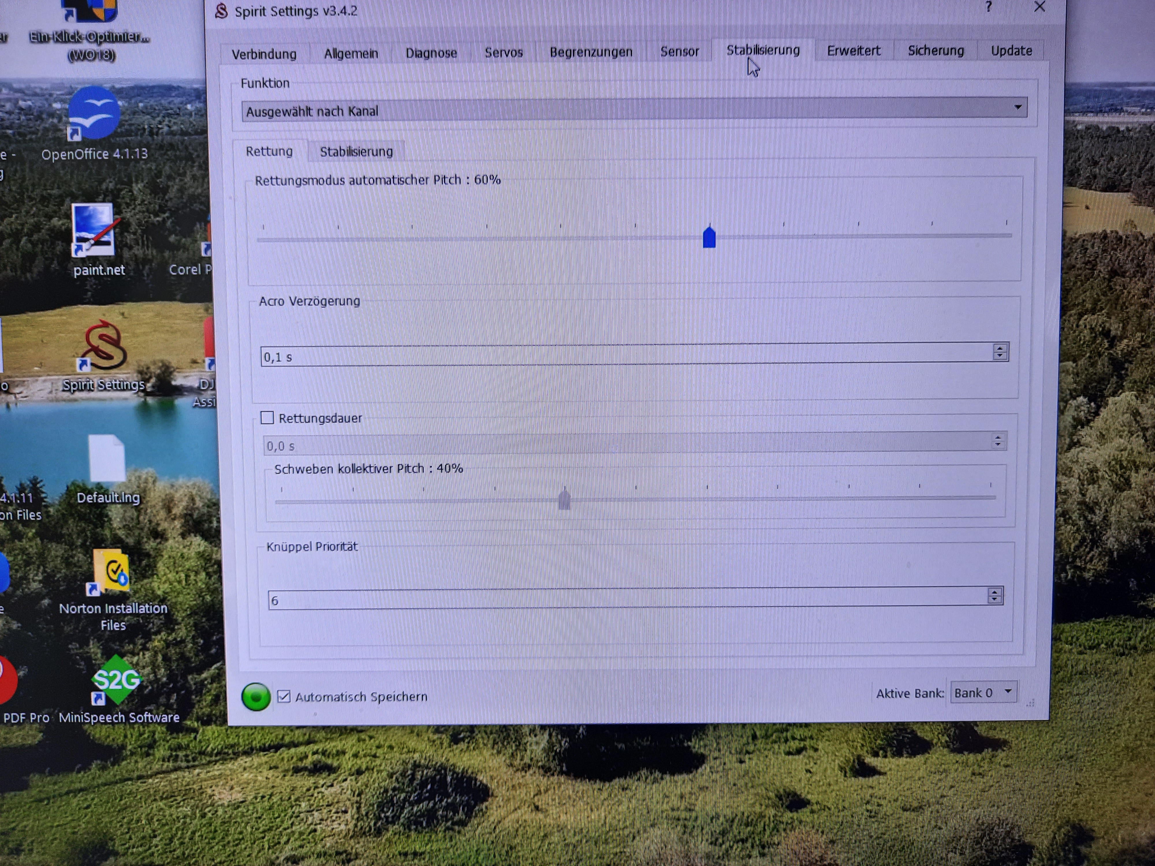

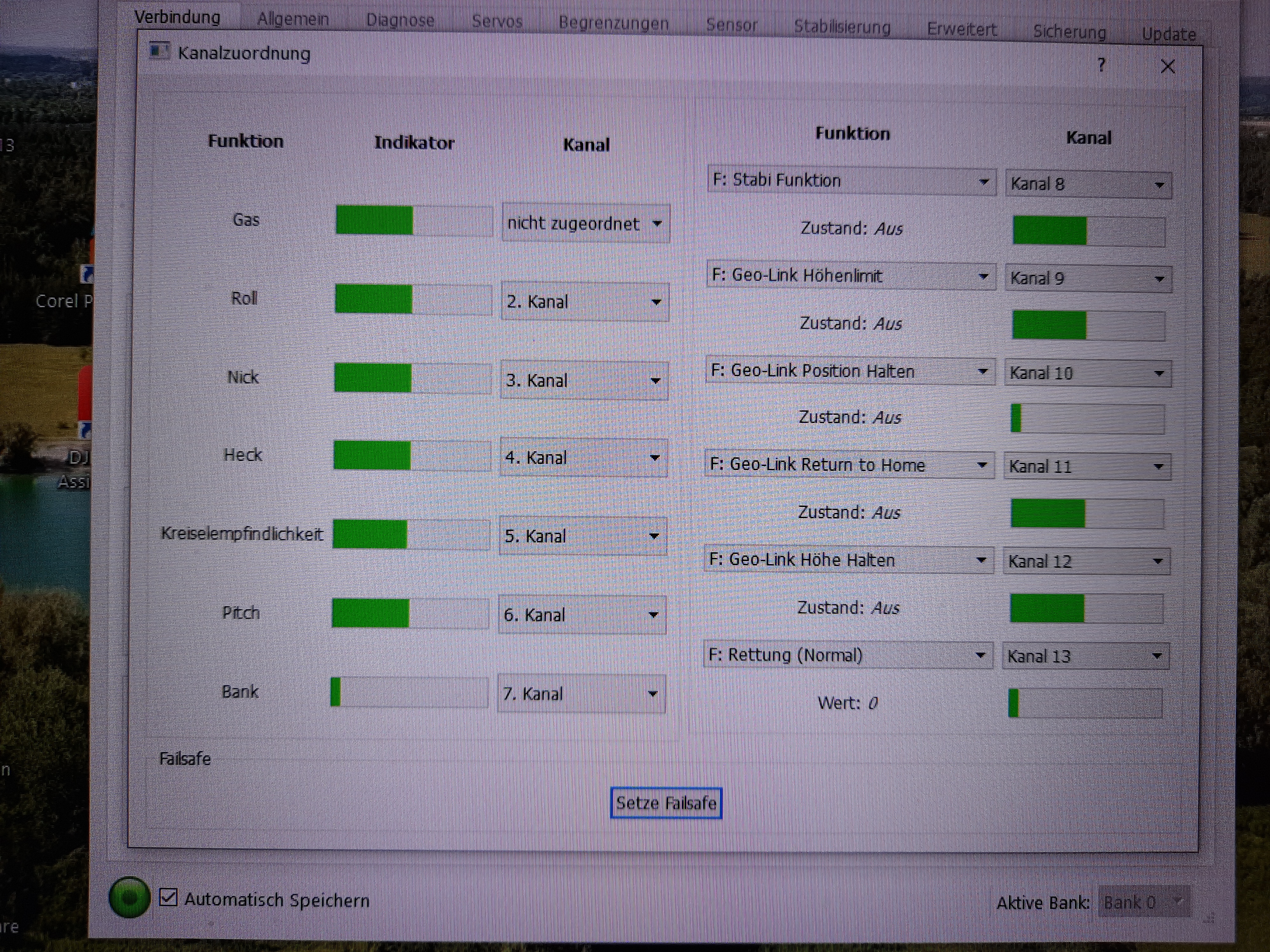

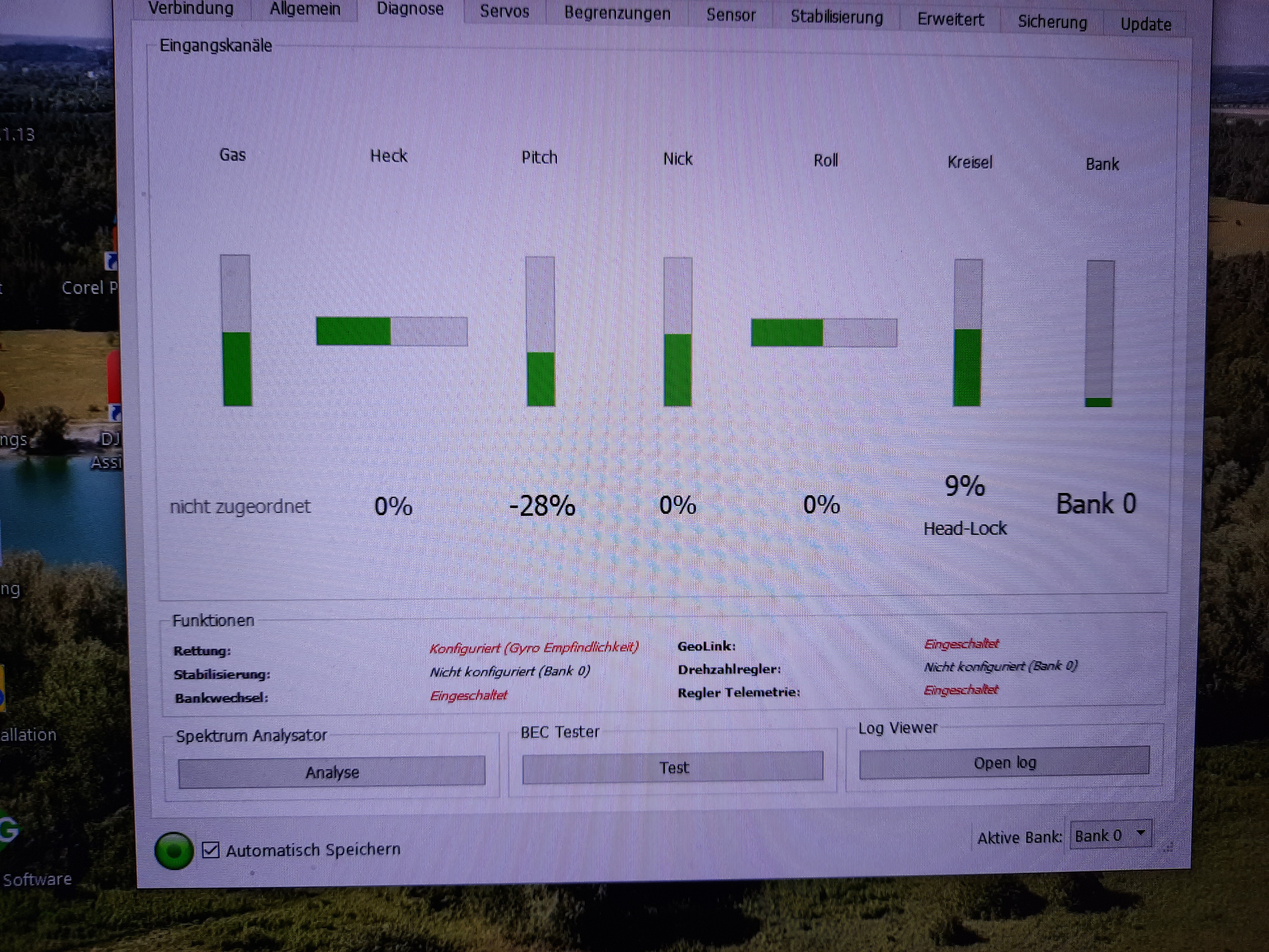

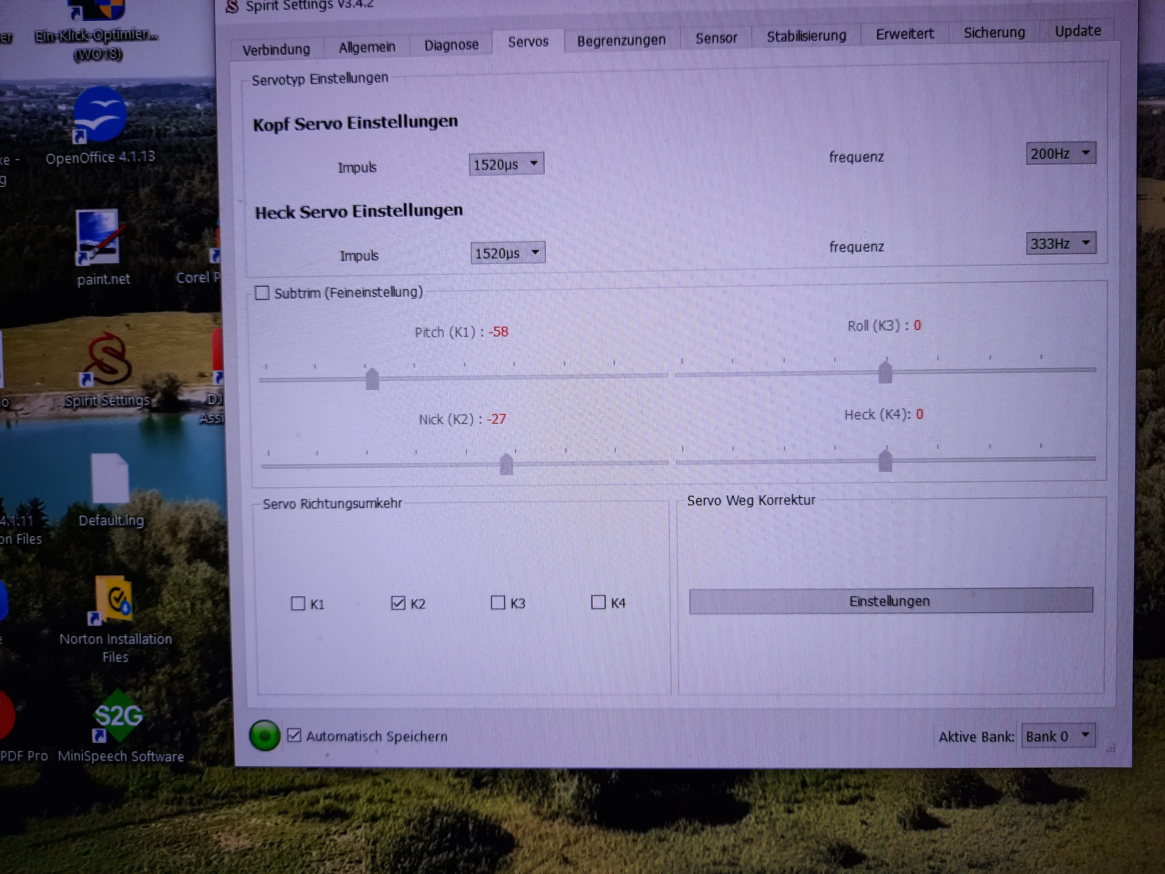

Hello here are my settings that I could see. Will send as photos, because I do not know exactly what data you need exactly.
Börni1
Posts: 51
Joined: Mon 16. Sep 2019 22:29:31
Here are the rest of the photos
Posts: 12932
thank you very much!
I will need rest of the settings unfortunately - all are saved in the file.
You can easily save it from the unit in the Backup tab.
Then attach it here and I will see completely all parameters.

I checked your settings and found that nearly everything looks good.
But one thing that could cause problems is that you have F: Stabi mode in the Special functions but in the Stabi tab you have Selected by Channel.
So your configuration contain two different engaging for rescue function which can cause that you can achieve quite unexpected condition depending on how your other banks are set and your model can for example fly away with Rescue function engaged even that you think you disengaged it.
So please remove F: Stabi Function from Channels. Then you can check all functions on the bench and verify that it is all doing what you expect. It is very important to not leave anything assigned if not used.
