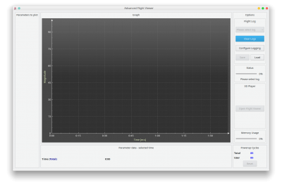

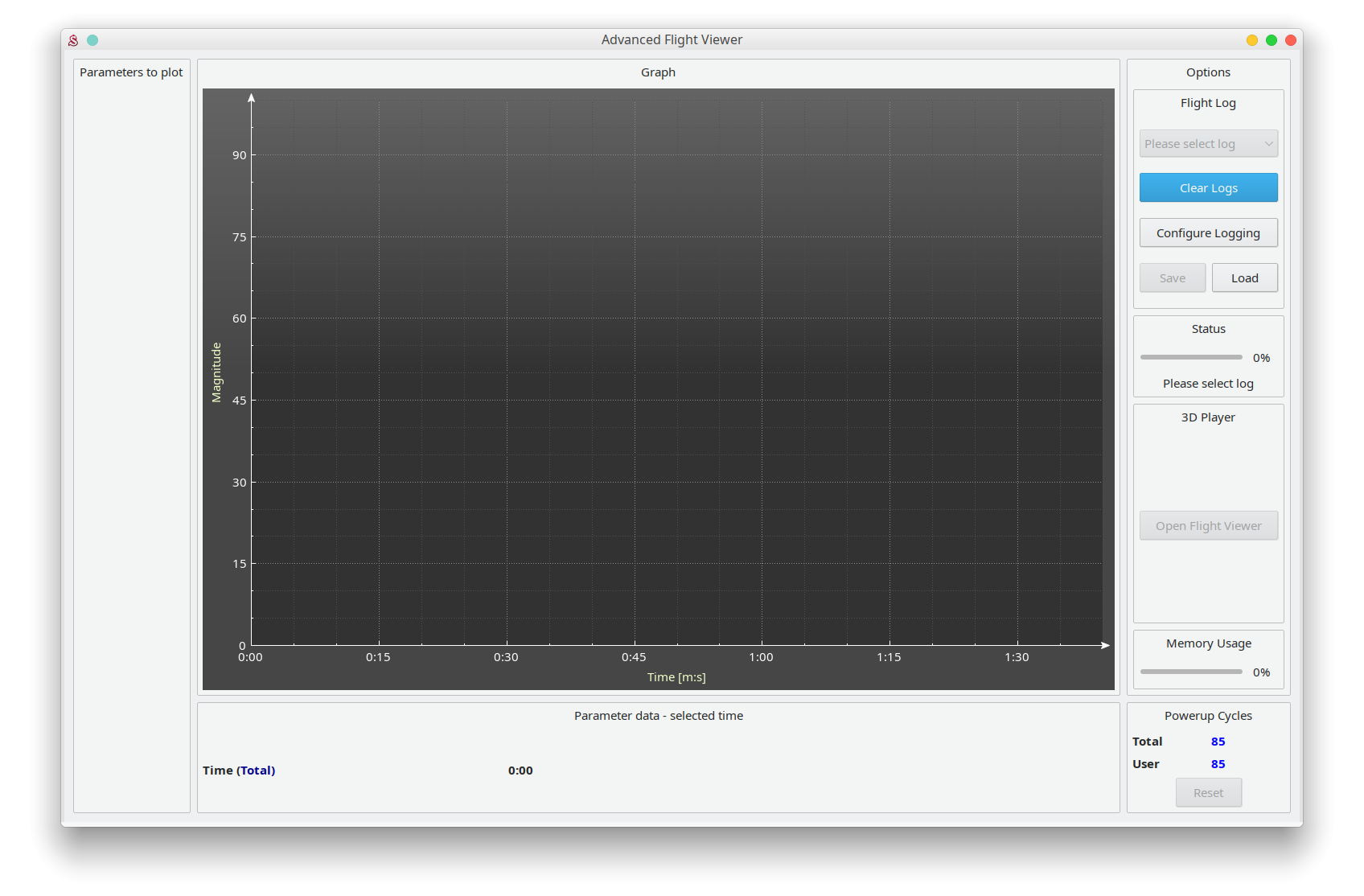

If you can`t see any RealTime log then please clear all logs first - in the RealTime Log Viewer. Then you have to see a log after each flight. If not, please disconnect ESC fan.
Dr.Fleming

I get the impression that you don't read what I write in detail,
there are no Flight Logs to delete, since it does not record them.
I have mentioned several times that the fans are disconnected, and I have asked you several times to tell us which fans are compatible,please.
Posts: 13049

Have you clicked at the "Clear Logs" button? Please answer to this question with "Yes/No". Please see my attachment which button I mean. It does not matter whether there is log or not. I am trying to help you with the issue why you can't see the log.

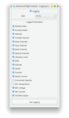

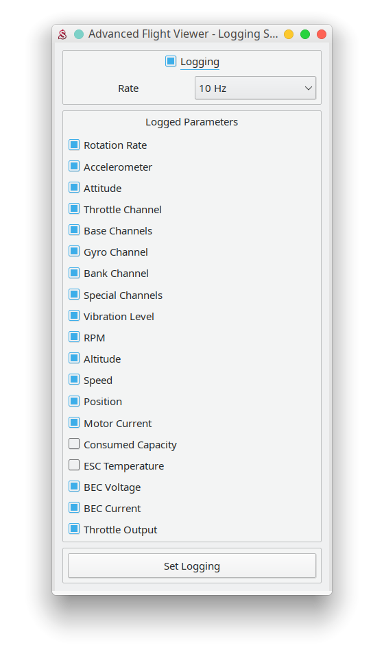

Then if you can't see recorded logs after a flight, please verify that logging is really enabled in the Logging Configuration - see attachment.
Dr.Fleming
Posts: 241
I have reset the memory of the Flight Log, but as I said before it was empty.

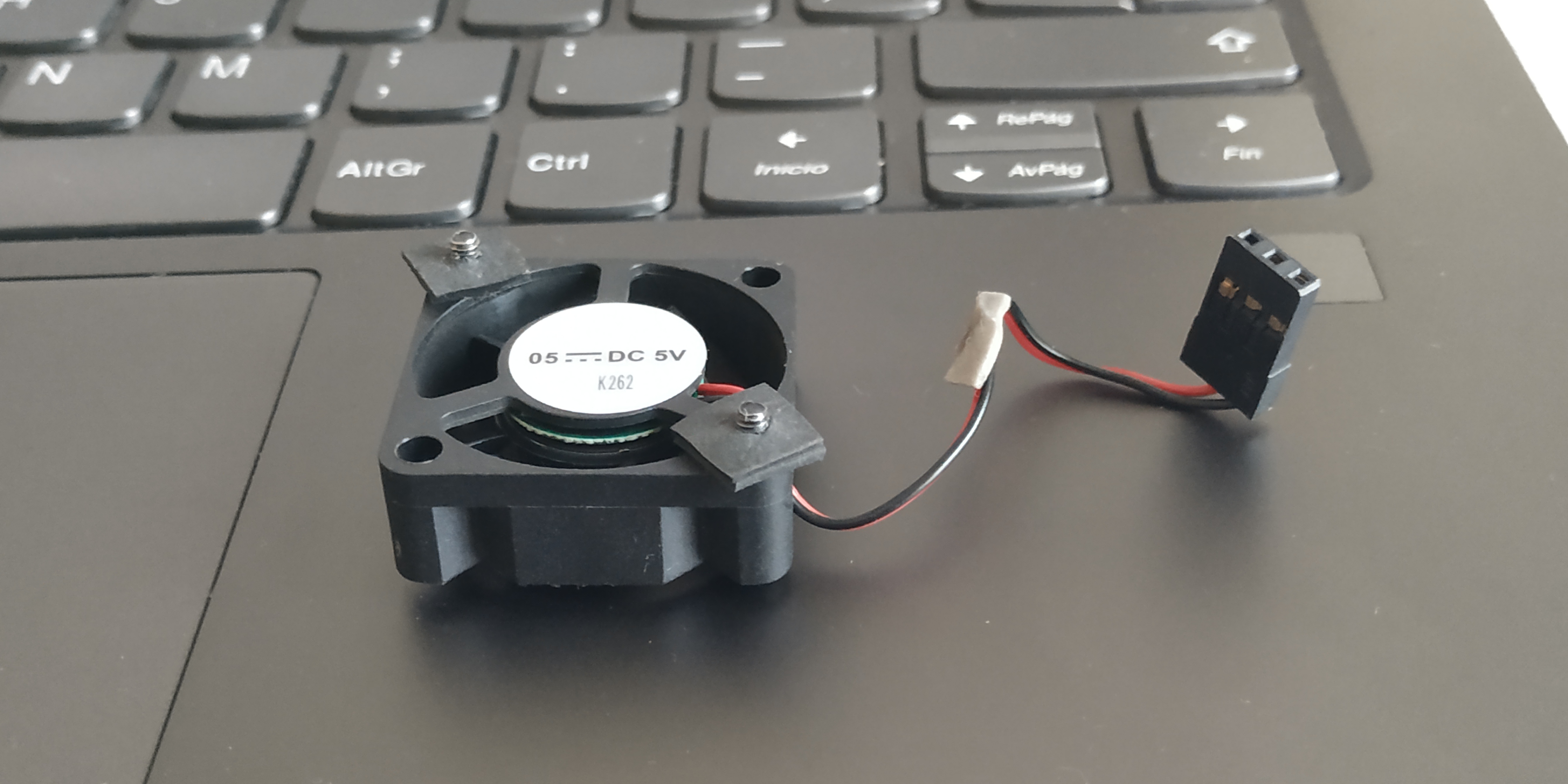

:idea: I have solved the problem with the HW fan by putting some silentbloks cuted from an old bicycle chamber, this help's that the vibration not transfer it to the base.
Attached photo, it also helps not to tighten the two screws to the limit, better put more Logtite on the screws.
Not need to buy another Fan from other manufacturer , still can use the original Hobbywing Fan.
We will Test this weekend again, and see if I can catch some Flight Log.
This tip is from a veteran. 8-)

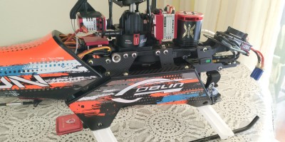

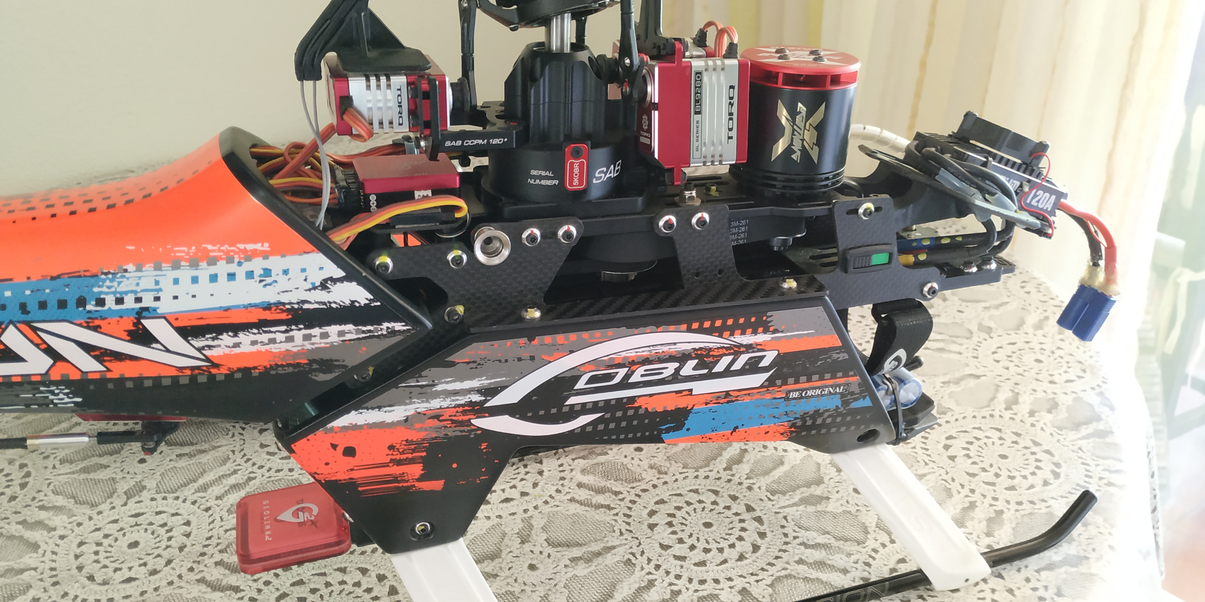

By the way see the installing position of the GL, it's under the Tail boom more protected.
