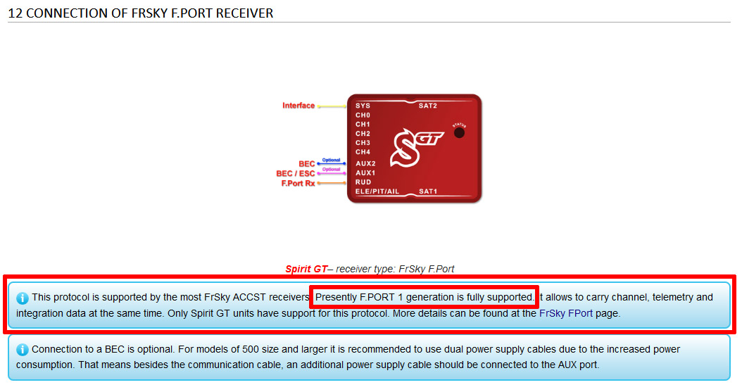

When I said I wanted to do this with a single cable, I wasn't talking about using a single cable for S-BUS and Telemetry, the only only Spirit unit that can do that is the Spirit GT via F.Port, and the R161 only support F-Port v2 and the Spirit GT wants F.Port v1.

Are you saying the information in the online manual is wrong or out of date?
No matter, the GT is already wired and working fine on another bird. The question here was about the Pro, which doesn't support F.Port.
Also, as you can see from the video you linked (which BTW is for the iKON FBL, not the Spirit), F.Pport v1 on the R161 will provide channel command signals only, no Telemetry.
v2 will provide Telemetry, but according to the manual, f.Port v2 is not supported, unless you know something we don 't?

there are two different versions labeling from FrSky for F.Port. Spirit units have full support for F.Port that has public documentation.
It works with ACCESS F.Port 2, yet we can't guarantee all will work, since there are so many receivers we simply have not tested all.
Moreover some FrSky receivers are implementing only partial support for F.Port, some very old receivers without telemetry or integration support.
F.Port v1 has full support for telemetry and integration.
Please note there are at least F.Port v1, F.Port v2, F.Port v1 2.0.
In any case you will get full telemetry and integration if receiver has support for this with F.Port.
