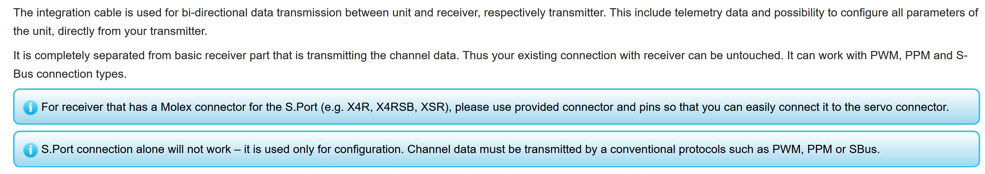

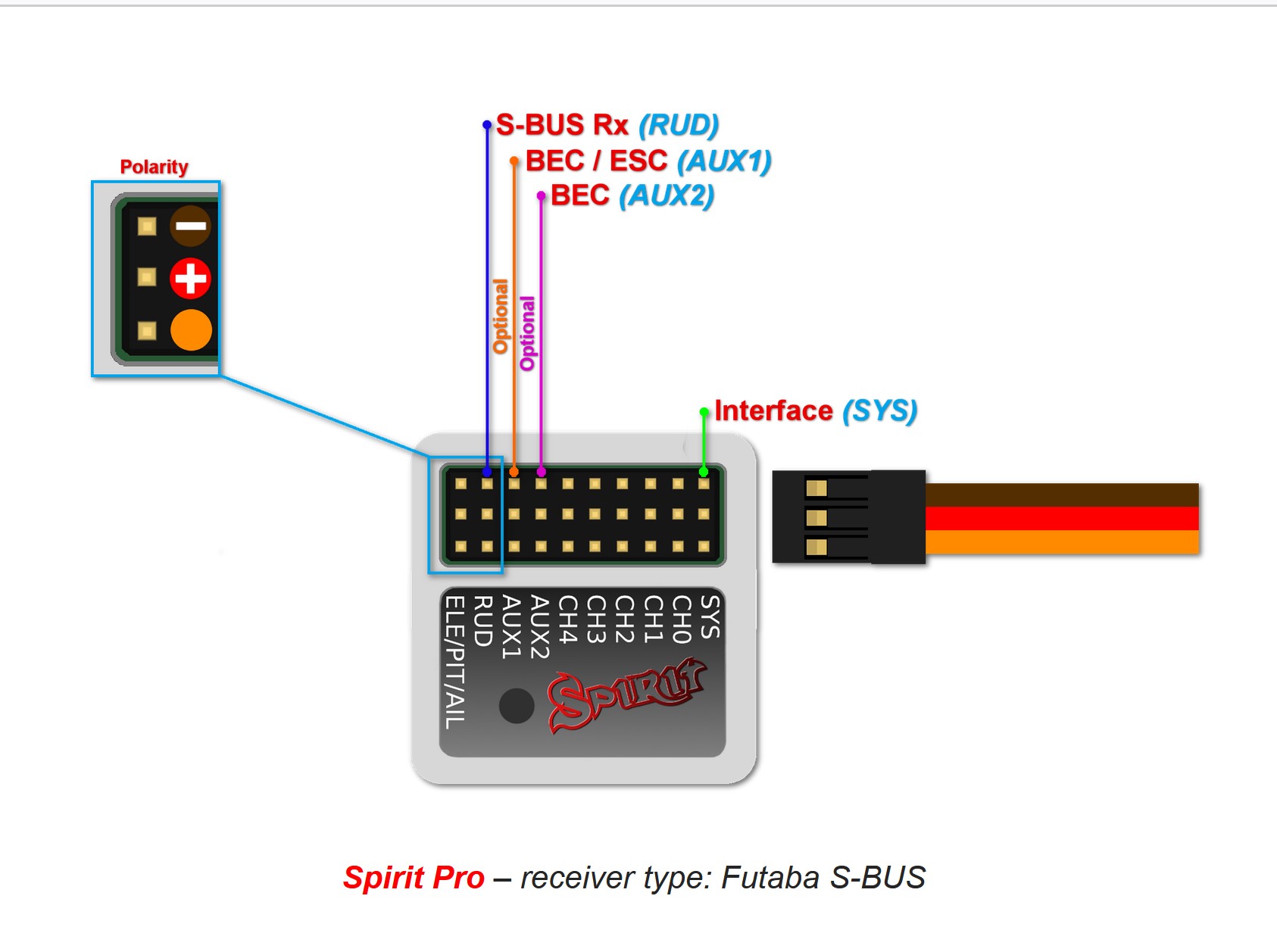

if I understand it right, then that is incorrect what Tomas said ! Tomas you can correct me if I am wrong, but I don't believe it - As I understand the wiring for SBUS and the integration you need to independed cables - one cable is only for integration from receiver SPort to the SYS-Port in the Spirit Pro, here you need the integration cable as said. For the channels transmission you need an independend cable from the receiver SBUS to the RUD-Port in the Spirit Pro - As in the wiringdiagramm shown the polarity of both Inputs (SYS and RUD) are total identical, as from the back to the front -, +, Signal, see SBUS-wiring-diagramm

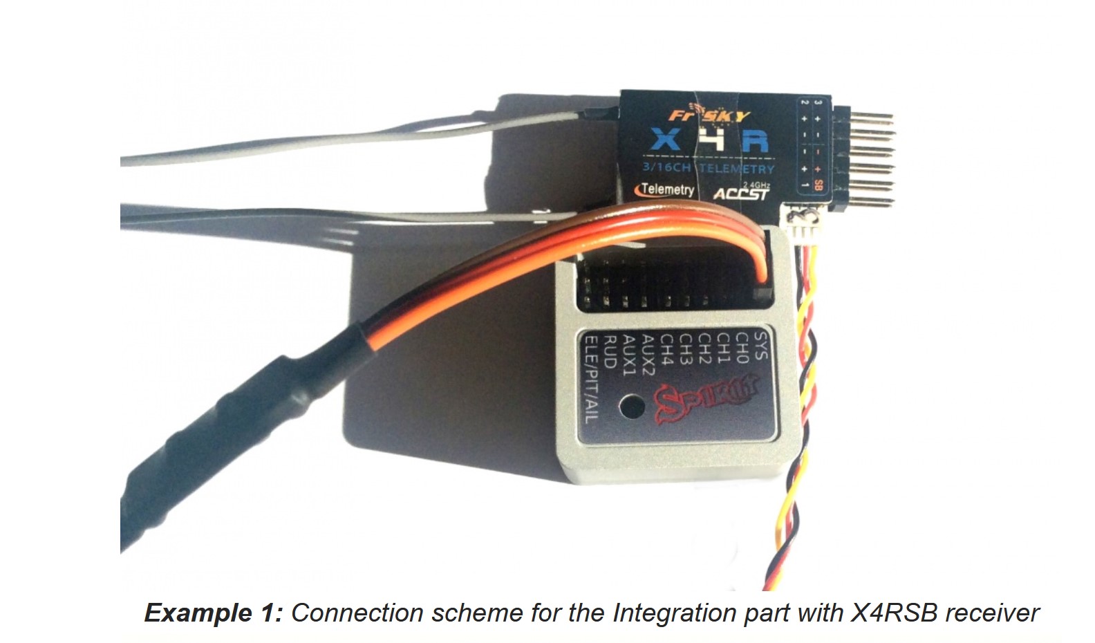

Integration:

According to the wiring diagram, the statement to place the signal on the middle pin is not correct, since the middle PIN is always plus (except for the sys port of course)! And I think we're not talking about the Ele/Pit/Ail interface here?! Or am I wrong here, but then the wiring diagram is not correct - Maybe SBUS-Futaba is not similar to SBUS FrSky, then an additional wiring-diagramm hast to be made- that needs to be clarified of course -

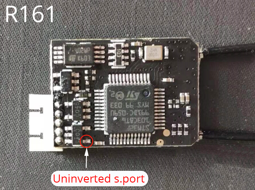

On some FrSky receivers and FrSky clone receivers, there are pads or locations on the receiver board where the original un-inverted signal is present. On the R161 it's here:
So I wired a cable directly to that pad, and tried to connect it directly to the SYS port to the signal pin first, and then the middle pin as suggested by the Admin, but in either case, no telemetry. The rest of the system works, and I got full control, but since there is no telemetry, there is also no integration, so I can't make any settings changes from the TX, the only way is to connect it via USB to a PC.

1. The un-inverted signal is not present on that pad as the photo suggests, although there are many other links on the web that suggest the diagram is correct,
2. The Spirit Pro does not support and un-iverted signal, and requires something "more", which the integration cable provides. This is the reason why I asked originally if the integration cable does "more" than just invert the signal.
