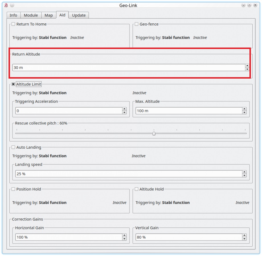

Altitude Limit
if it is activated on1 is activated based on the current position of the model
on2 is activated according to the channel signal
Triggering Acceleration is 0 standard but do i have to change this value?
but if the function Altitude Limit of the geolink is activated in 2 mode which I just described the parameter return altitude (the red rectangle) what do i need it for? i am reading this
http://manual.spirit-system.com/index.p ... tude_Limit
tell me something?1.2 Usage
The feature can be engaged at any given time by a switch of your radio. We recommend to use a normal two-state or three-state switch for this feature. But first it is important to decide in which way the feature will be engaged as there are two options:
To engage with Stabi function - in this case the feature is engaged when programmed Stabi function is engaged. This mean you do not need to assign any other switch than when used for e.g. Stabilisation mode. [LESS CHANNELS ARE USED]
To engage with assigned GeoLink channel - it is required to assign F: GeoLink Altitude Limit function in the General/Channels to an available channel. [EASIER TO SET UP]
Return Altitude is not used for Altitude Limit at all.
It is used only for Return to Home and Geo-fence features.

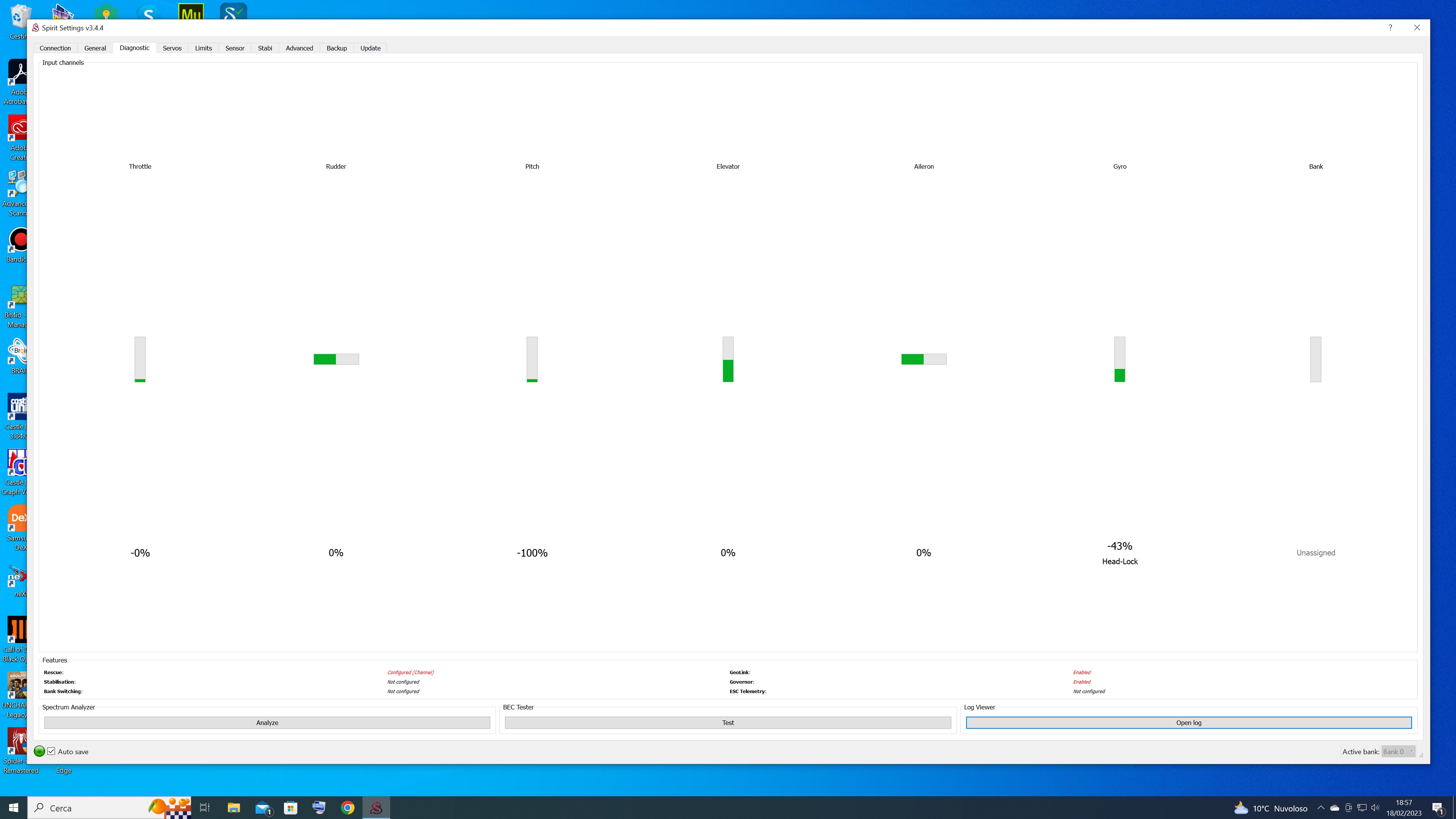

Now i want to report a bug of the spirit rs with radio jeti ds12 spirit edition.
In my first tests this thing didn't happen.
In the first tests it was good.
Now if i set gyro gain values below 0 it doesn't go in normal mode.
But it always stays in avcs.
negative values come out but remains avcs.
Even if in the channels I deactivate channel of the gain sensitivity and set the gain from the software the same thing happens.
It always stays in avcs.
here is a screenshot and here are my settings.
Obviously when I move the sensitivity from my radio the value in the software moves regularly.
i moved on first setup the limits of channel gyro sensitivity to have equal values on my radio and in the software max positive 115 and max negative -114 (to have +100 ecc)
Previously it was in normal mode now without changing anything normal mode no longer works.
The logs say nothing
PS
I do not understand why in my radio channel gyro sensitivity is numer 6 and in software spirit I have to put channel 5 .
doing so when i move the gyro gain from my radio corresponds to the movement of the software.
If i in the software set channel 6 such as gyro sensitivity the software radio gain does not match.
but remember that this mode in the first tests it was good.
maybe it's an integration of the jeti with spirit
