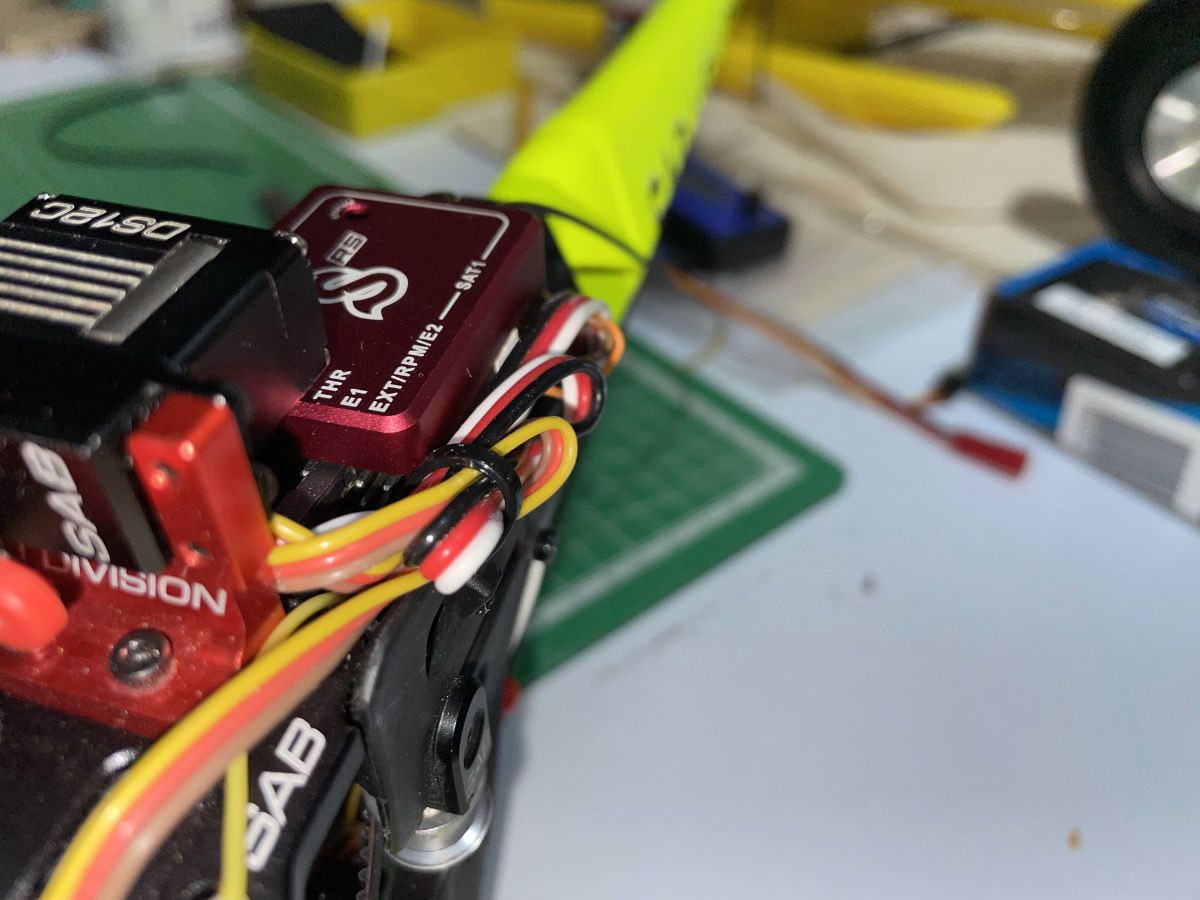

ZeXx86 wrote: I can see that there is something connected to EXT/RPM/E2 - there are white, red and black wires.
Can you tell me what cable it is?
I made another picture from the front, so you can see the connections. As you can see nothing connected to E1 and E1. Then THR connected to the ESC and AUX not connected.
I hope this answers your question.
Kind regards
Gerhard
