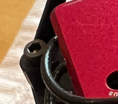

I created zoomin photo to show what is wrong.
There you can see that insulation of the antenna has wrinkles. Inside the anntena there is not only one wire but also shielding which is damaged always when bent like this is done.
Actually even SAB-made antenna holders are not designed well.
But I believe none of these are reason for crash. If signal is weak you will receive notice to your radio.
I think there are only two things that could possibly result to this crash:
a) Only one BEC cable is there - if BEC tester is passing with no issue or voltage alarm on the radio then it is OK. If there are two leads from BEC I recommend to use them.
b) During RPM change model can generate high electrostatic discharges if belt is loose. This can affect whole electronics. It is important to tighten the belt properly. However I believe with this model it is not too common.
