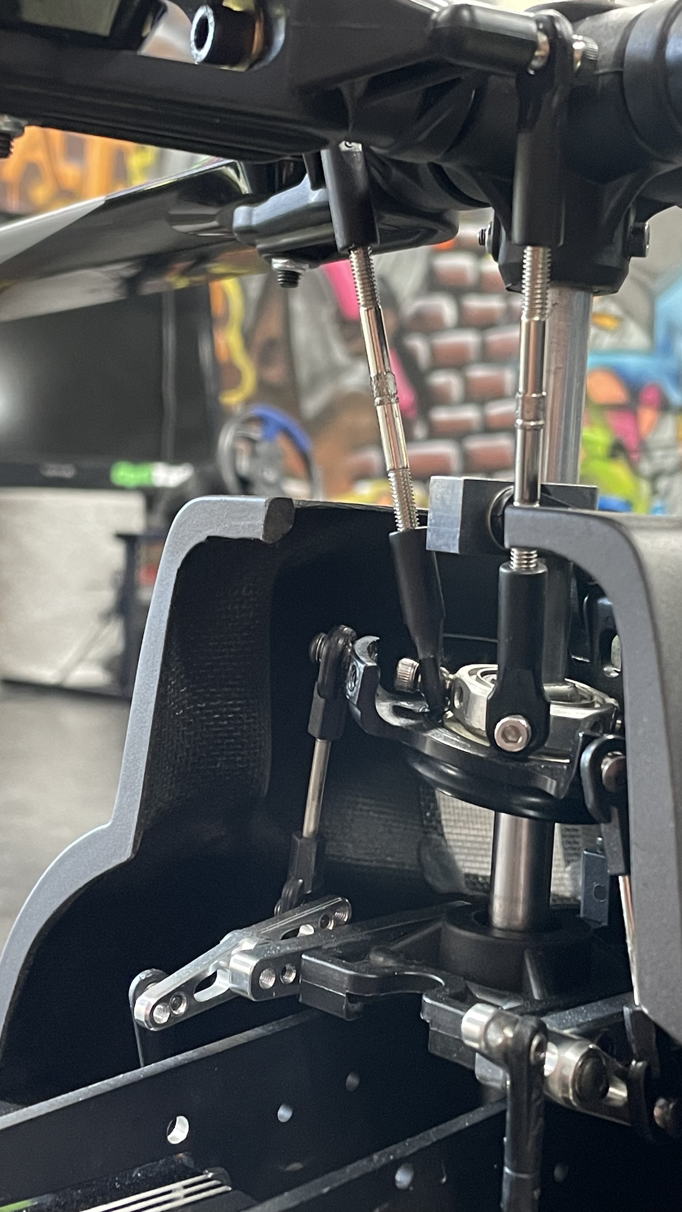

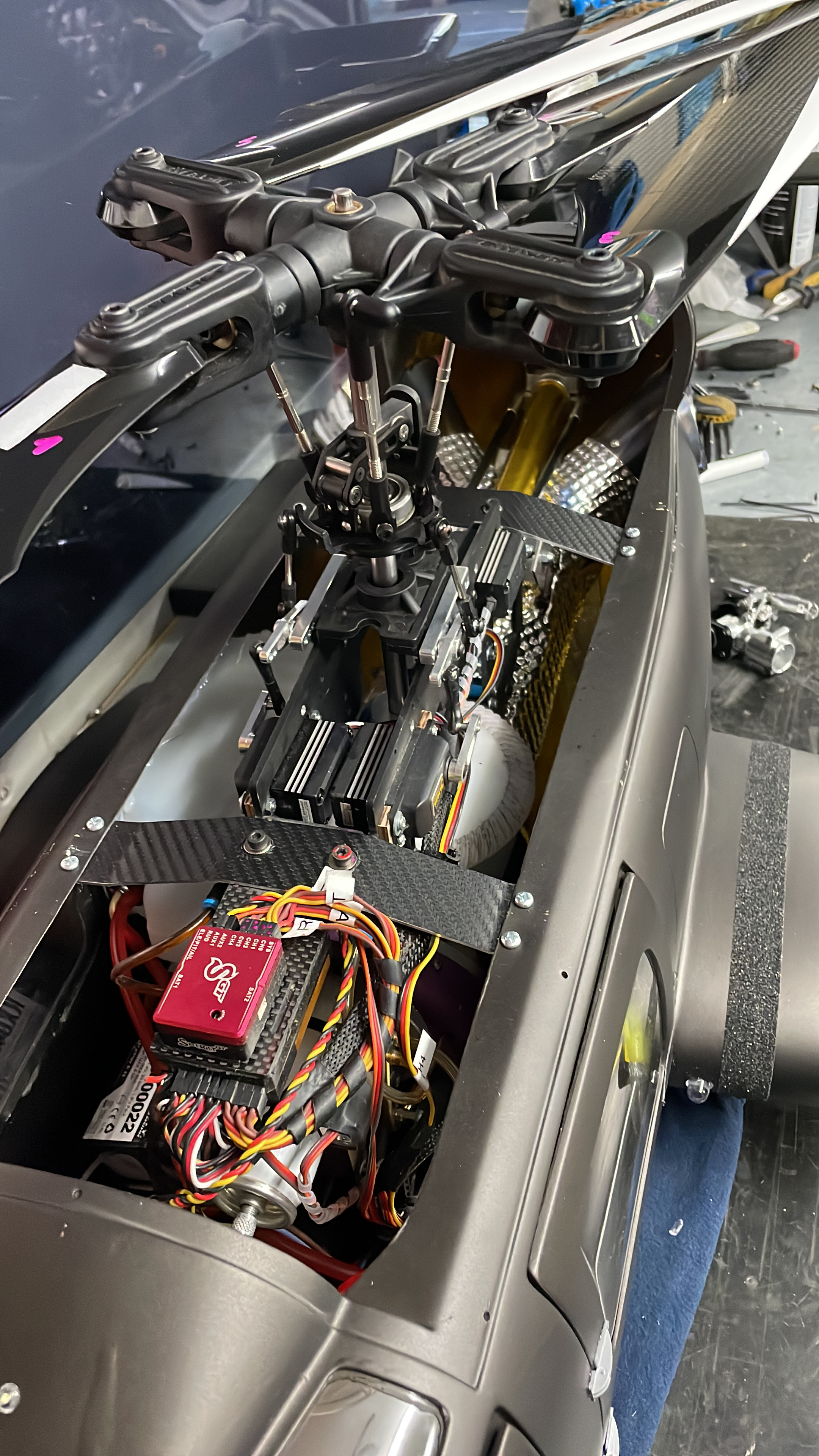

as far as i know - as said: no personal experience with 4 heads - there are different kinds of multi-head setups (some needing cyclic phase setup, some not) depending on servo positioning and swash/head geometry. best could be to make a photo of your head/swash from above - so that head/swash/servo geometry can be seen. then Tomas or some of the scale guys will for sure be able to give the right advice :)
for sure: improper setting of 6° and maybe phase setup can for sure render the heli to hard-to-impossible to fly :)

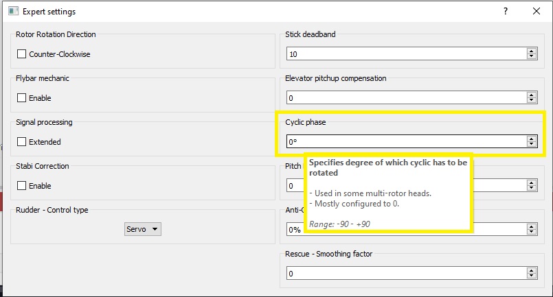

My 4blade head has a standard 3 servo setup as you will ser on any trex.. but i didnt do any cyclic phasing. Its at O..
When i tried 45degree everything var 45degree off. Trying to go straight, it goes 45degre right front.. and so on.

Also in your photo I see the servants they are not directed to the plate, this thing you set it for good?
This one is at 0. I tried 45degree as i was told. But helicopter flew 45degree sideways

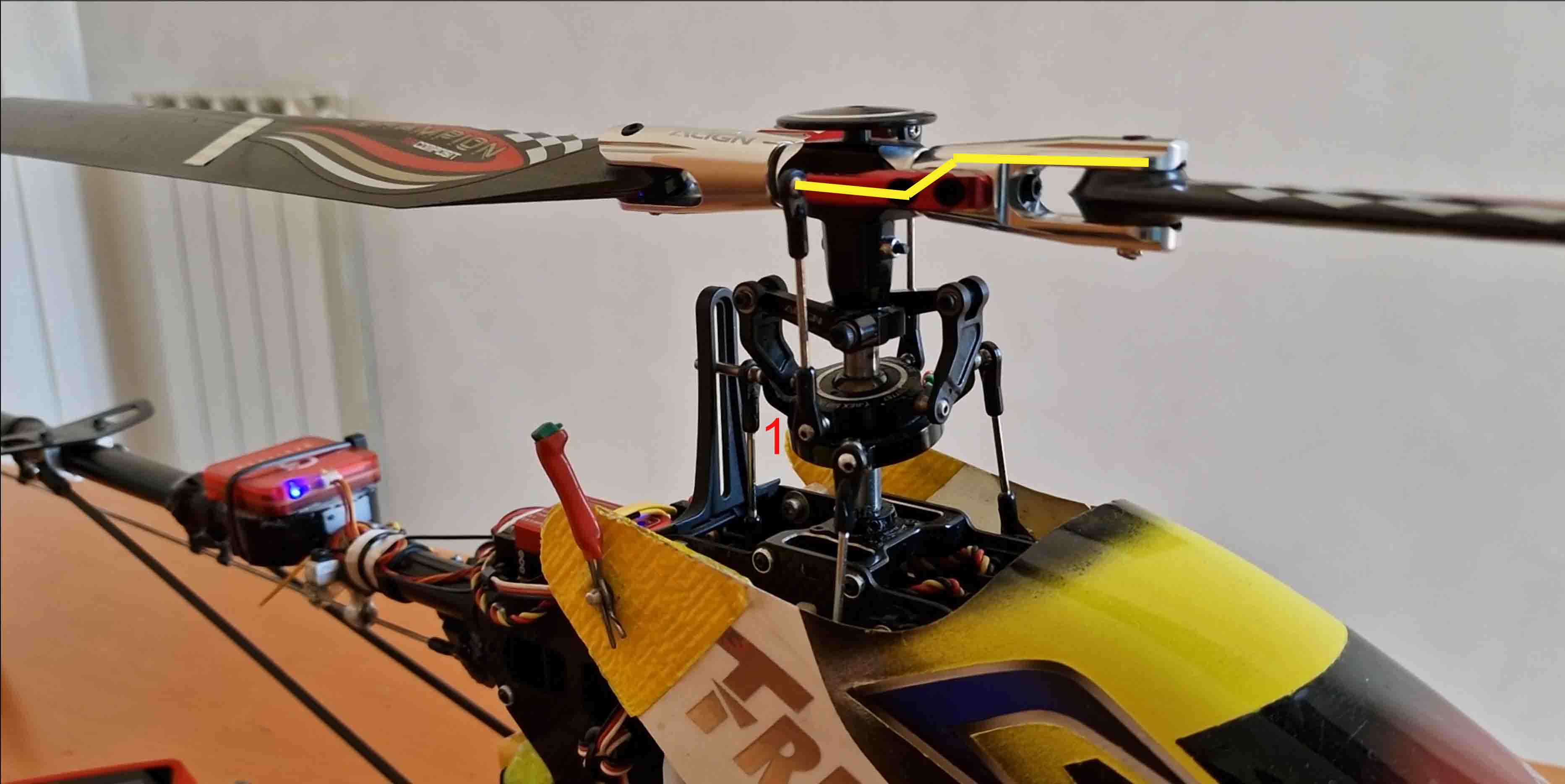

Let's see if I can explain myself.
In this image there is a 2-blade model, when you tilt the swashplate aileron to the right ; when the linkage called 1 it is in that position thanks to the length of the yellow lines you have an angled blade when it is found on the nose of the helicopter.
while your 4 blade when linkage 1 is on the same point, thanks to the yellow lines with different length you will have the blade inclined in a different position and not when it's on the nose helicopter.
I've been clear?

Cyclyc phase is at -0-. Thats correct setting, 6degree tuning is i believe correct if you see pics. I lowered cyclic speed. Helped alot. But heli still wiggles around the whole area. Really hard to hover in one place

0 it's right for models with 2 blades but with the 4 blades it's wrong.
reset any changes you made
set cyclic phase 10 and try.
if that's not enough set cyclic phase 20.
