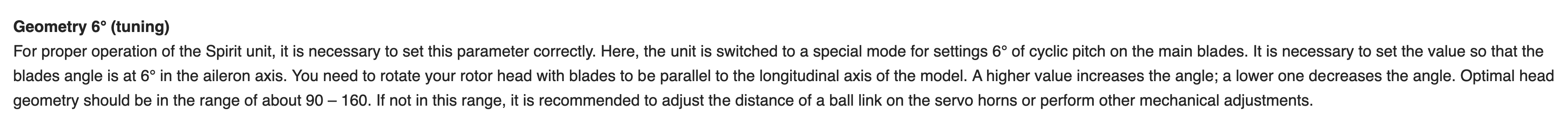

HeliMLM wrote:the 6° should be set with "blades parallel to the boom", so with a 4-blade head i guess it's just "measure with the one blade above the boom". but really exactly above the boom (and of course perfect level swash and 0 pitch etc before to do this one). this parameter is really important to be spot on for good flying characteristics... !
Wait, what?? 6degree tuning is measuren the blade going with boom? Wow.. ive allways measured it almost at ailerion angle sort of speak. Was told to measure it on the highest point of the swash, thats where it would be.. around 45degree on the front right side if seen from
Behind
... see attached a screenshot of Spirit manual. "You need to rotate your rotor head with blades to be parallel to the longitudinal axis of the model"... maybe this could be different for different special swash type (as said: i do not know - but maybe your 4-head is different), but that's how it is in general. be sure that the blade is really straight in the grip to not distort the measurement.

Yeah exactly.. this is why i would love to see pics. English is not my native language so this just confuses me.. also. Would this be the same for 4/5/6 blades as for 2?HeliMLM wrote:... see attached a screenshot of Spirit manual. "You need to rotate your rotor head with blades to be parallel to the longitudinal axis of the model"... maybe this could be different for different special swash type (as said: i do not know - but maybe your 4-head is different), but that's how it is in general. be sure that the blade is really straight in the grip to not distort the measurement.
