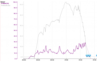

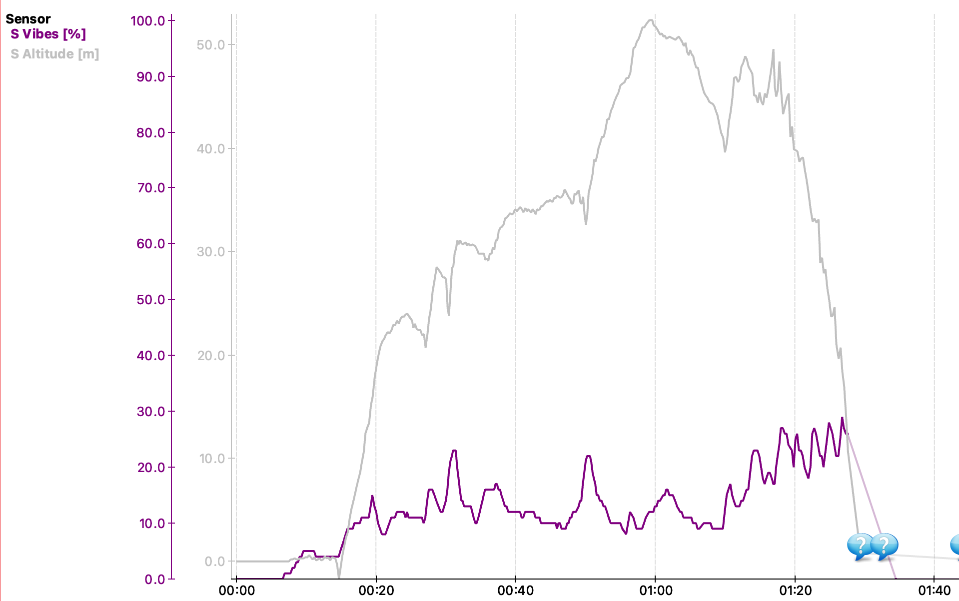

The vibrations are not very low. Please have a look on the attached chart.

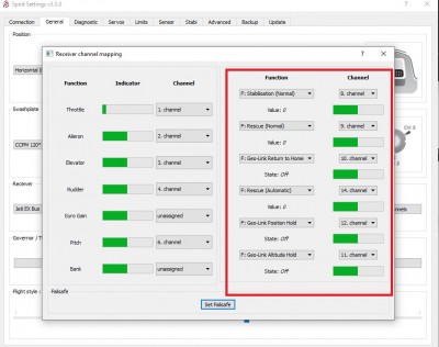

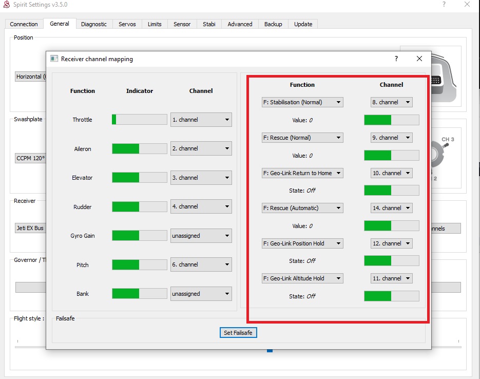

For channels please have a look on my first post. It's attached. All Channels are from -100 to +100 (Jeti). The altitude limit (channel 14) is activated with +100 in radio and Spirit, deactivated with -100.
all others:
Yes, it was normal mode. So the heli should have to rescue with base downwards in every case. But the heli turned upside down in the moment of rescue by itself.

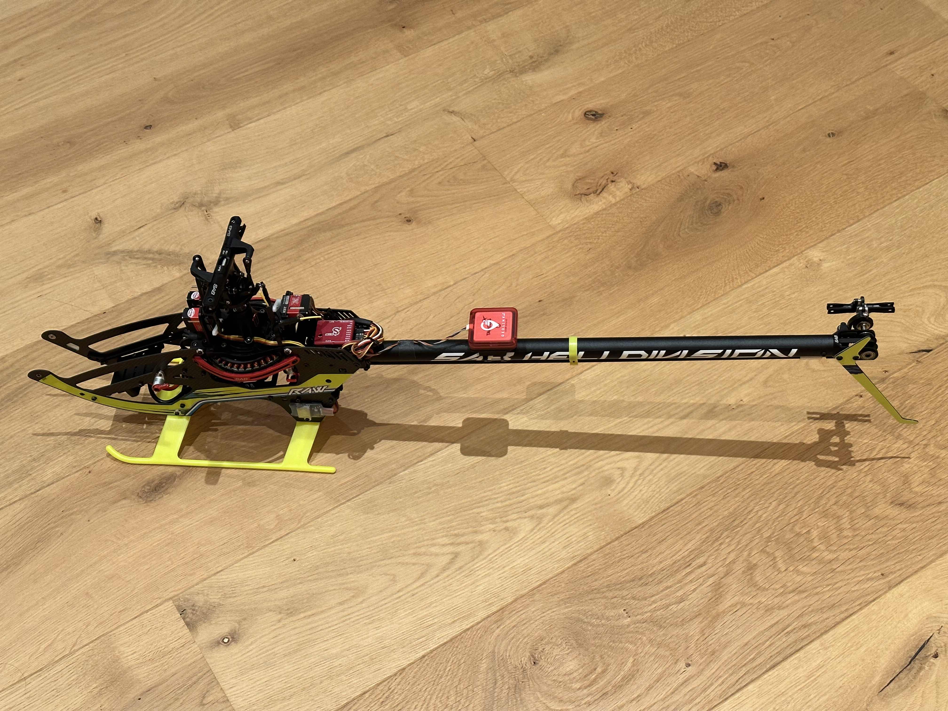

Rebuild after crash

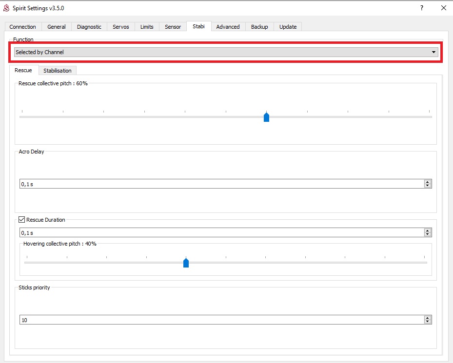

altitude limit it has two activations ON1 and ON2 based on the channel value assigned to the switch
in general channel what is written to you? (on1 or on2)
this settings you only see them with the radio turned on
let me understand but you use altitude limit and normal recovery?
why if active altitude limit and after you use normal rescue altitude limit takes the altitude than when you activated normal rescue.
This happened to me, but the rescue normal It has always worked fine for me.
only that between altitude limit and rescue normal the priority goes to rescue normal.
but he's always been good to me.
Only if you activate altitude limit and then you activated the normal rescue you should disable and re-enable altitude limit.
But is it possible to have all these functions active?
why in stabi mode you can only choose one option

Posts: 13047
I have checked your settings. I found that you are not using GeoLink Altitude Limit at all.
Instead you are using Rescue (Automatic) which is feature directly from GTR.
Are you aware of this? Altitude for the automatic rescue is programmed during flight, not from the software.
Tanja
Posts: 32
Joined: Fri 02. Dec 2022 12:27:33
thank you for checking the settings. I am aware of this. As long as I don't know what happened with the altitude limit when I crashed, I don't want to use it with the Geo-Link anymore. So I changed to the automatic rescue of the GTR.
Do you have an idea, why the heli turned and stayed in the inverted position while normal rescue with altitude limit? I want to make sure, that it's not an hardware issue, what can happen again. It doesn't feel good.
