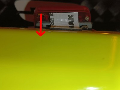

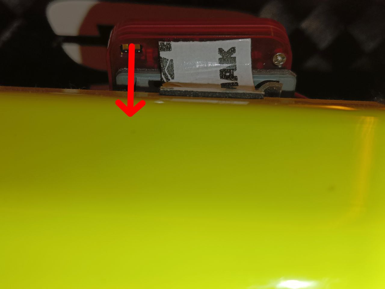

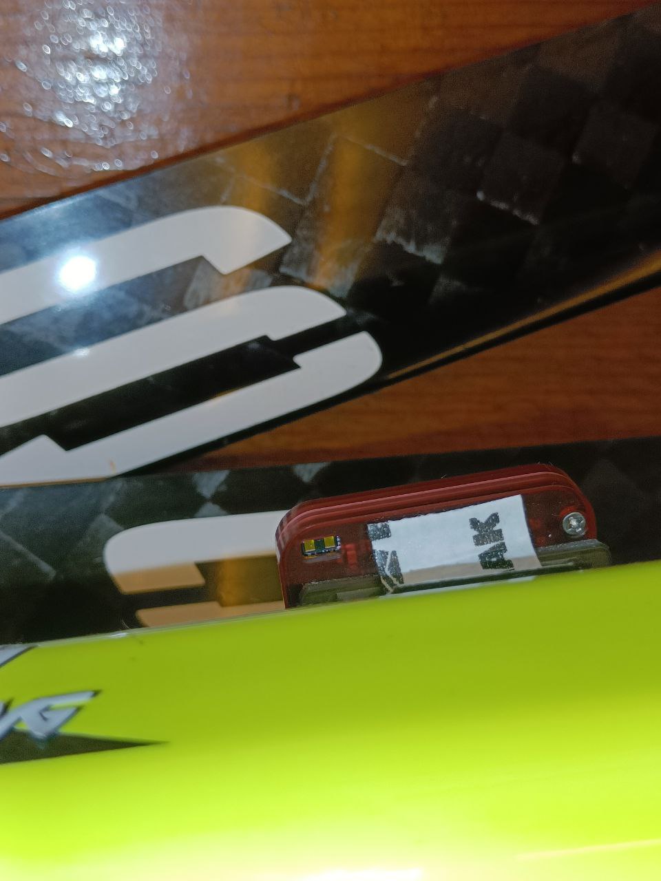

I understand correctly that there is a hole for the laser sensor at the bottom? If so, then according to the instructions it can be covered and it will turn off, or as I understand it, it must be positioned so that it "sees" the ground. And I have it not covered, while looking at the edge of the beam. Could it be that he does not understand what is happening because of the tail boom and thinks the helicopter is near the ground and drops the measured height? The arrow showed where the laser sensor "looks"

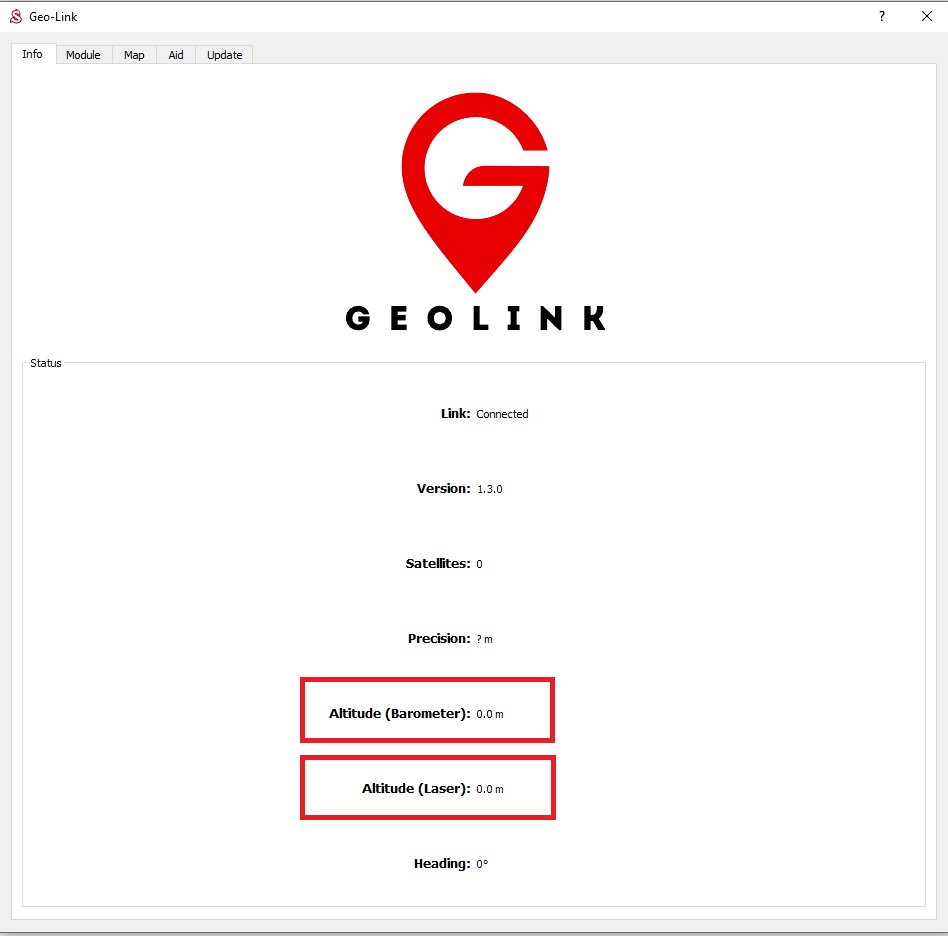

general geolink settings and info
connect the helicopter to a laptop and come out to get all the satellites.
Now With the hands sends the model up and down.
Can you tell me if these values they read height exact? (altitude (barometer) - altitude (laser)

franz88 wrote:general geolink settings and info
Yes, after finding all the satellites, the barometer height is measured very accurately

is screen demo mode.
sensor laser what does it read?
if the barometer reads good it means that the problem is not the barometer.
