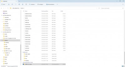

Good morning and thanks for your prompt reply. I attach the requested screenshot from my Jeti DC-14.
Regards,
Heliman550
Thank you for the screenshot. Now I can see there are some files. But Spirit.BIN file is not there at the moment. So integration will not work.
