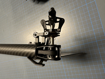

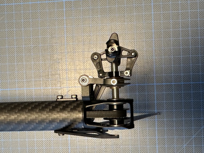

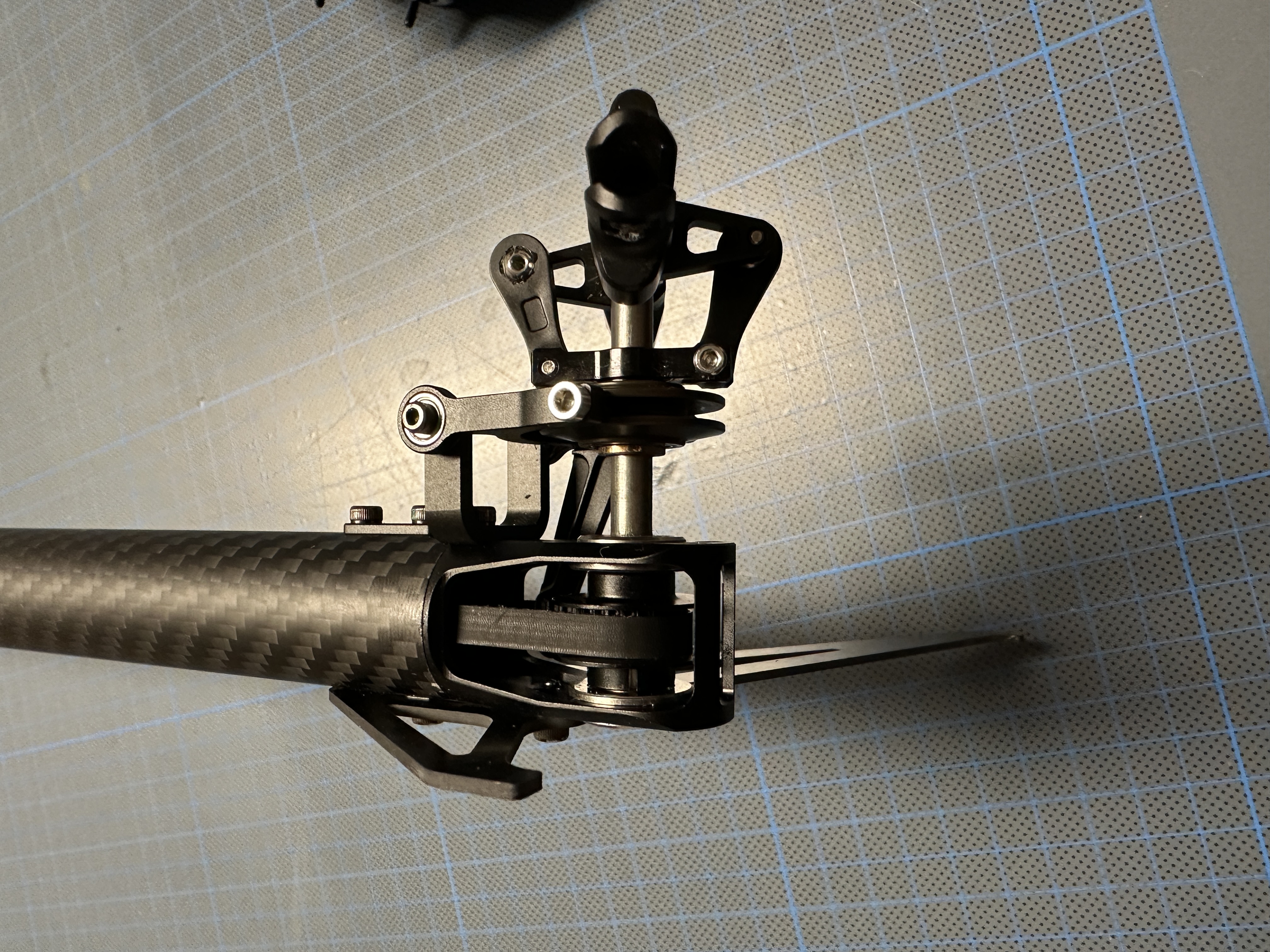

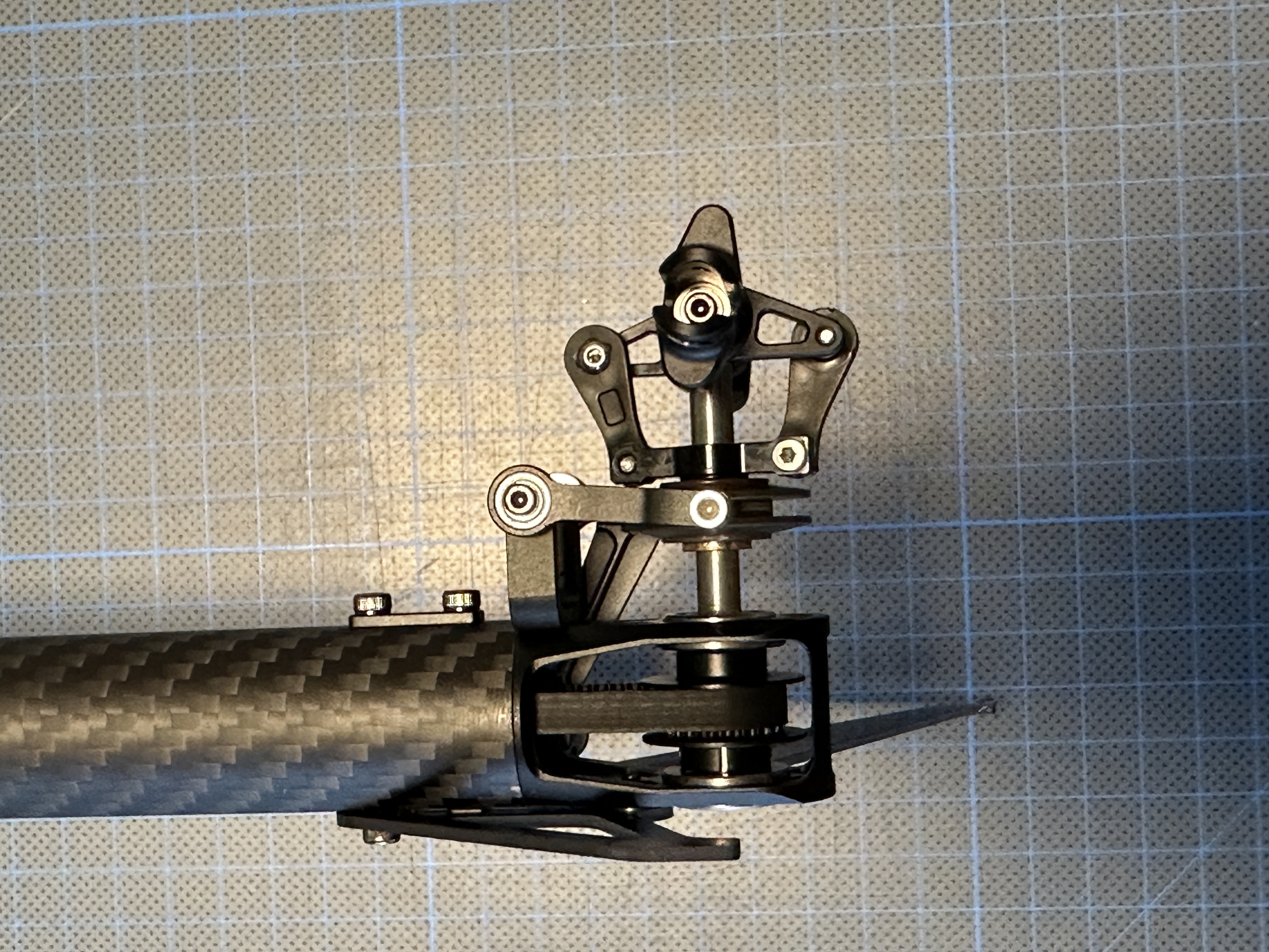

Hi, when I deactivate the heading hold by reducing the gyro gain the heli starts rotating around the z axis, not only drifting but quite fast.
When my servo arm is at 90° to the pushrod (pic2), the tail rotor has a bit pitch (picture 1). I thought that would be right because you need some compensation for the main blade momentum.
Am I wrong there?
Am I wrong there?

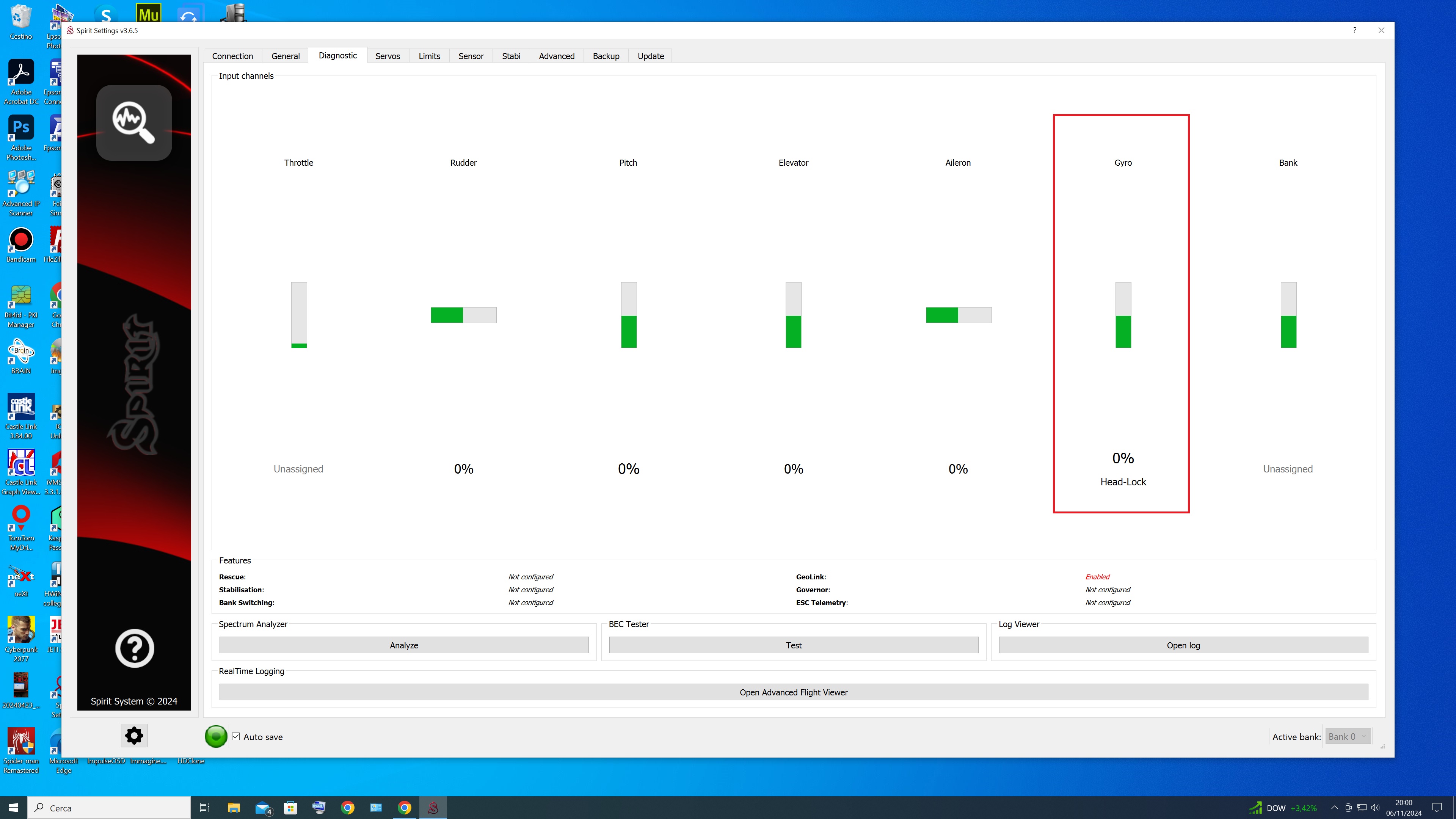

the radio values they are relative
in diagnostic (rectangle red image) use a switch position to have +50% head lock
and one position switch to have +50% normal mode
you push on with helicopter in avcs mode and after switch in normal mode
during hovering in normal mode without pressing the stick the nose the helicopter must remain still (move linkage tail if it doesn't stay still).
