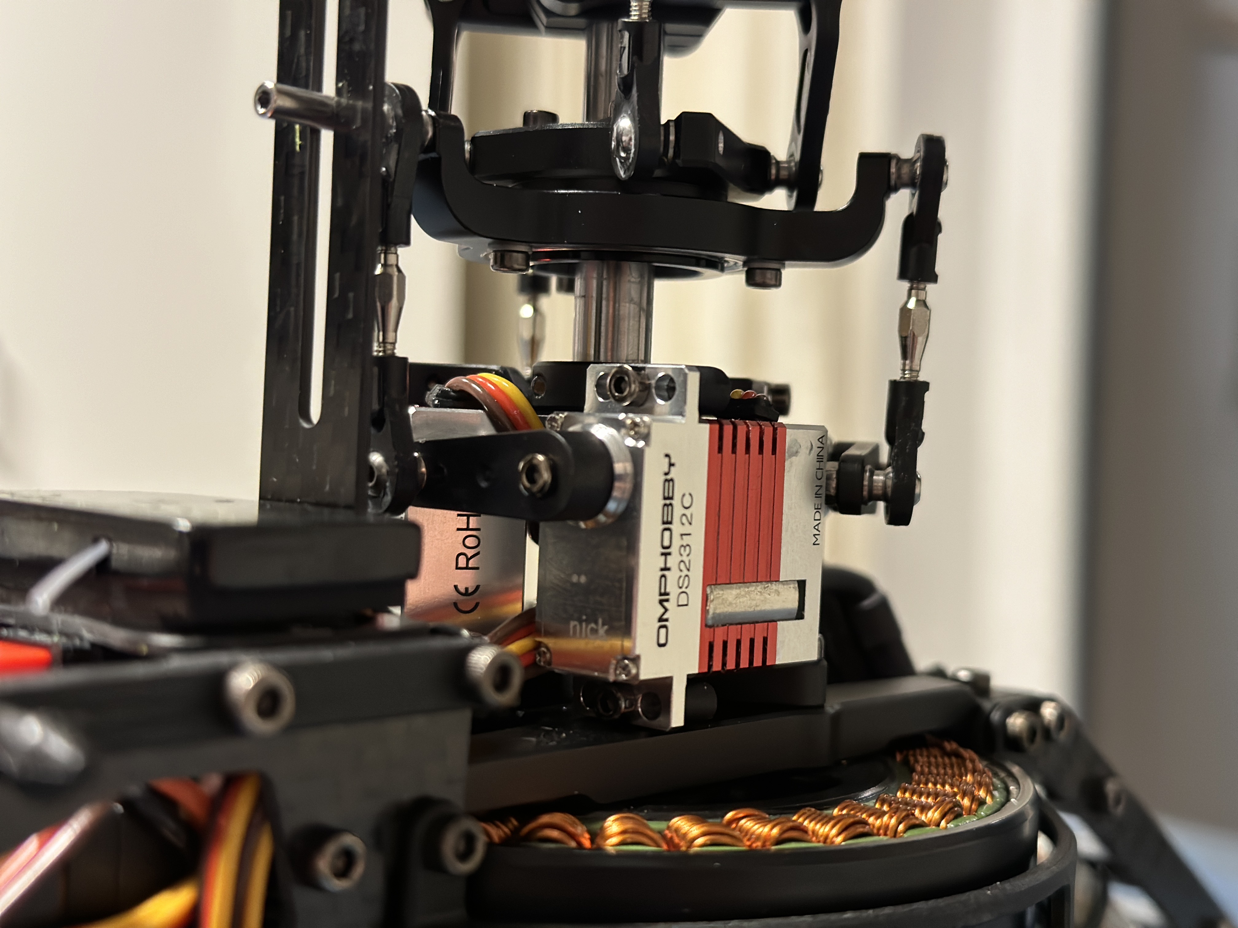

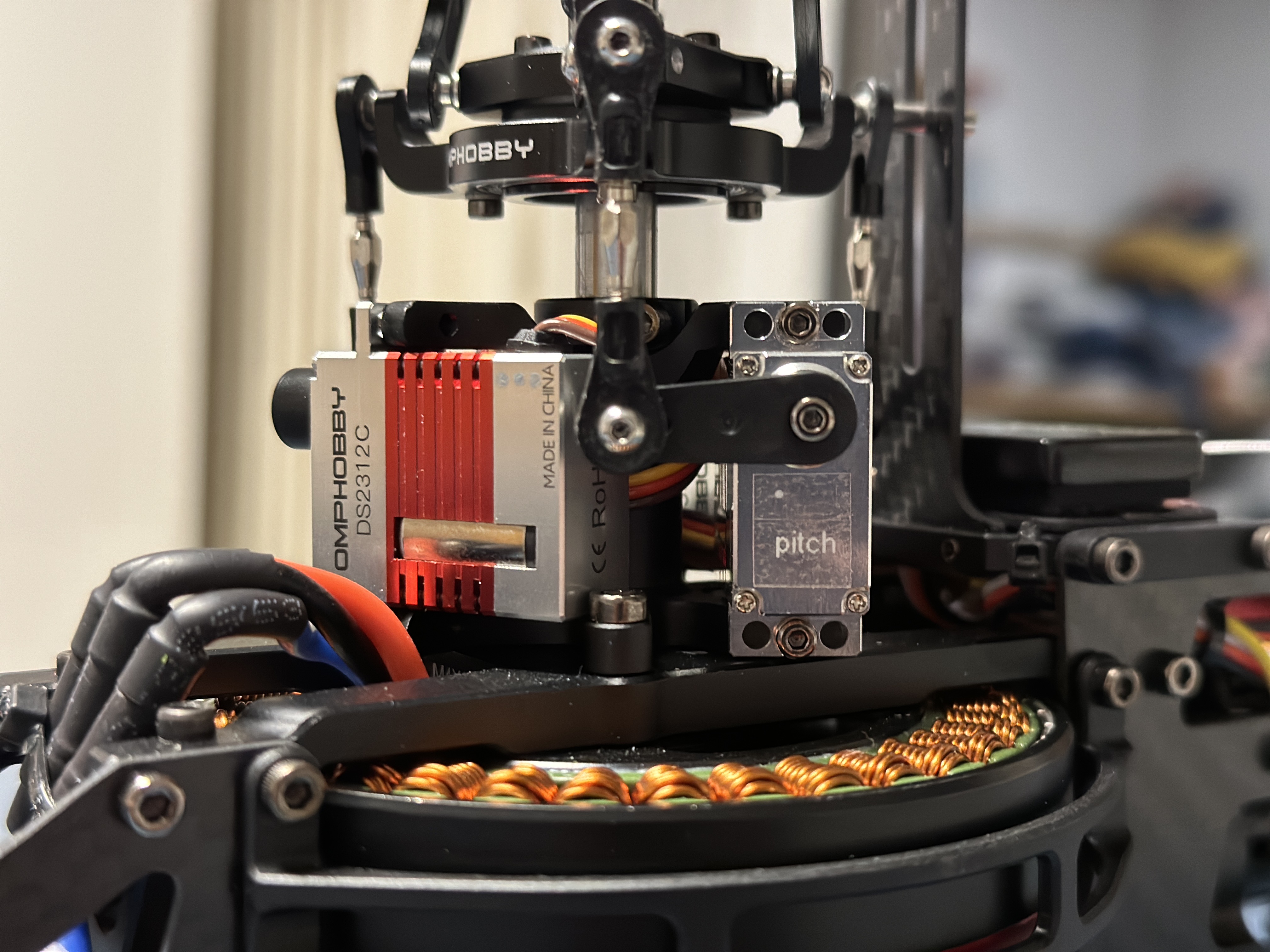

Here some photos of the linkage in subtrim mode. I think they are good. To reach them I needed to entwr values in spirit subtrim between -86 an -33.

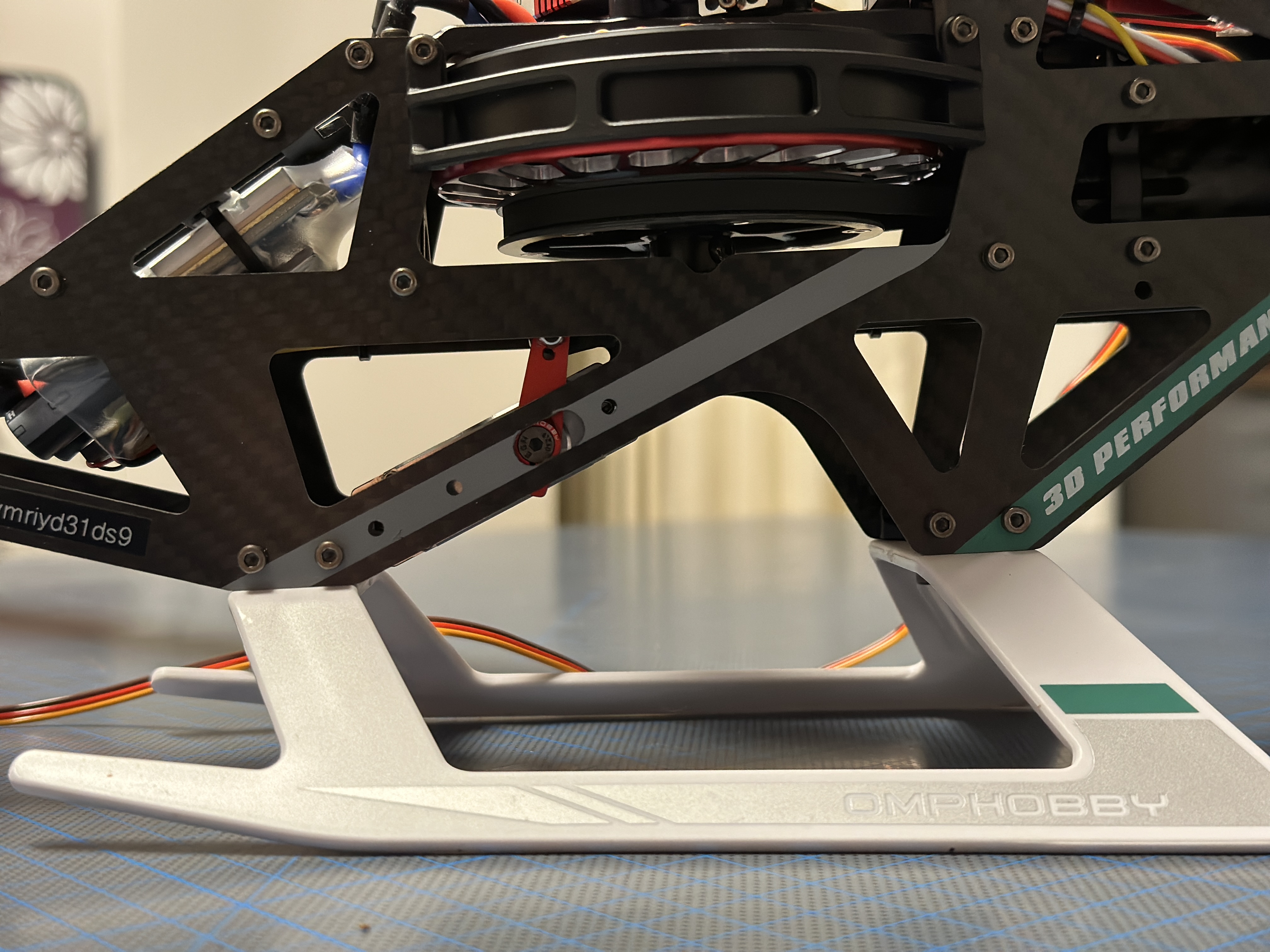

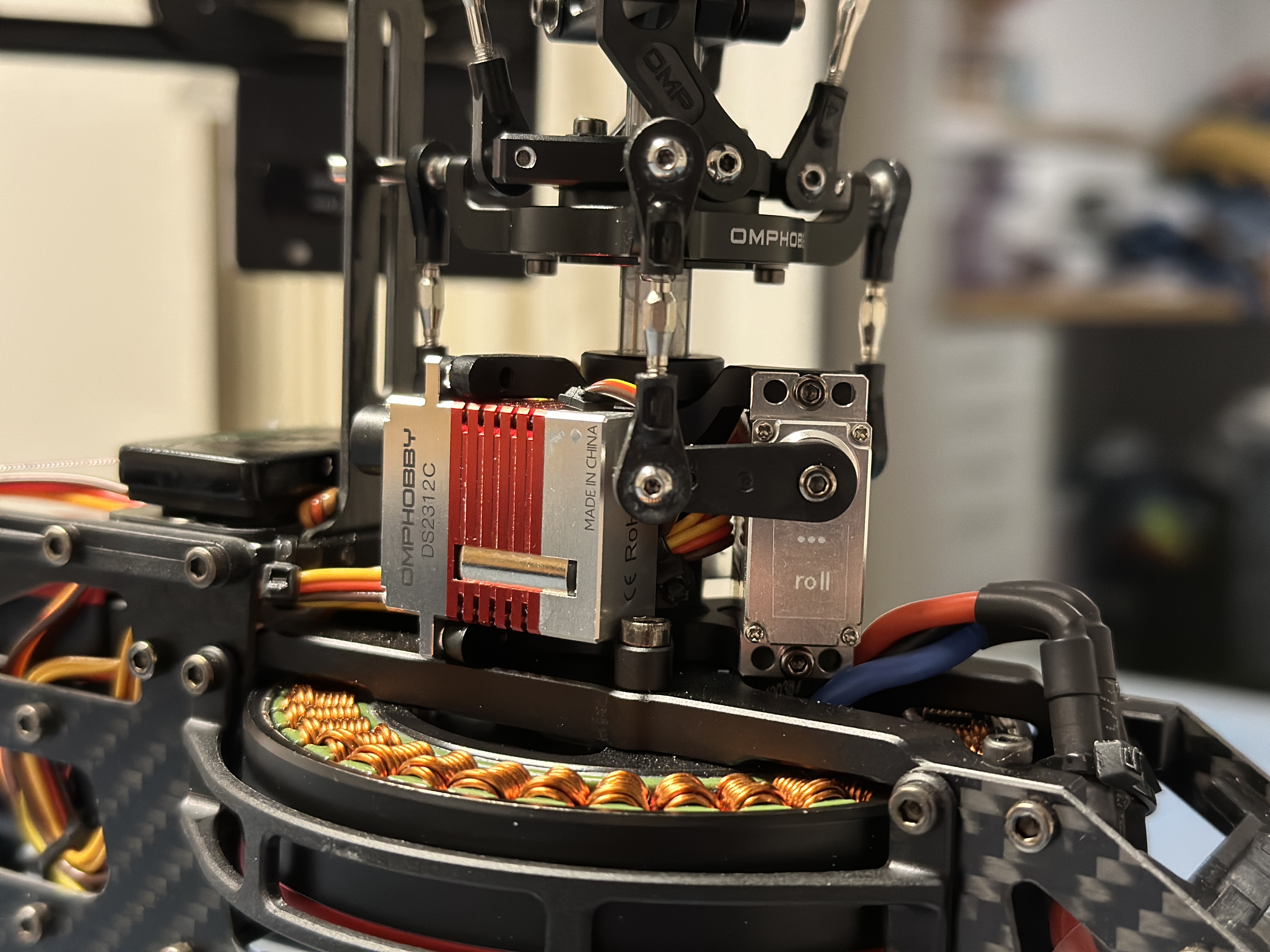

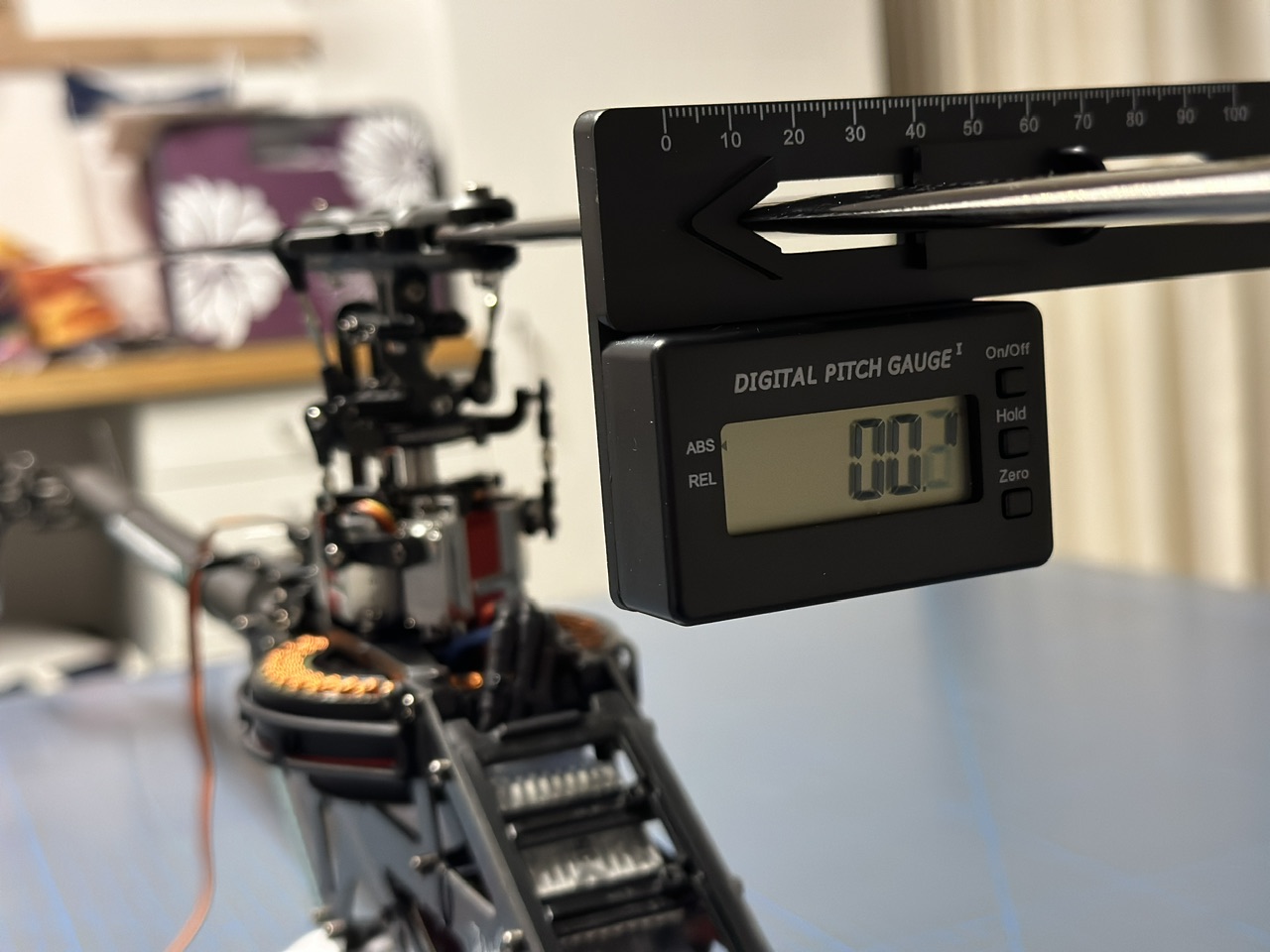

Further pictures

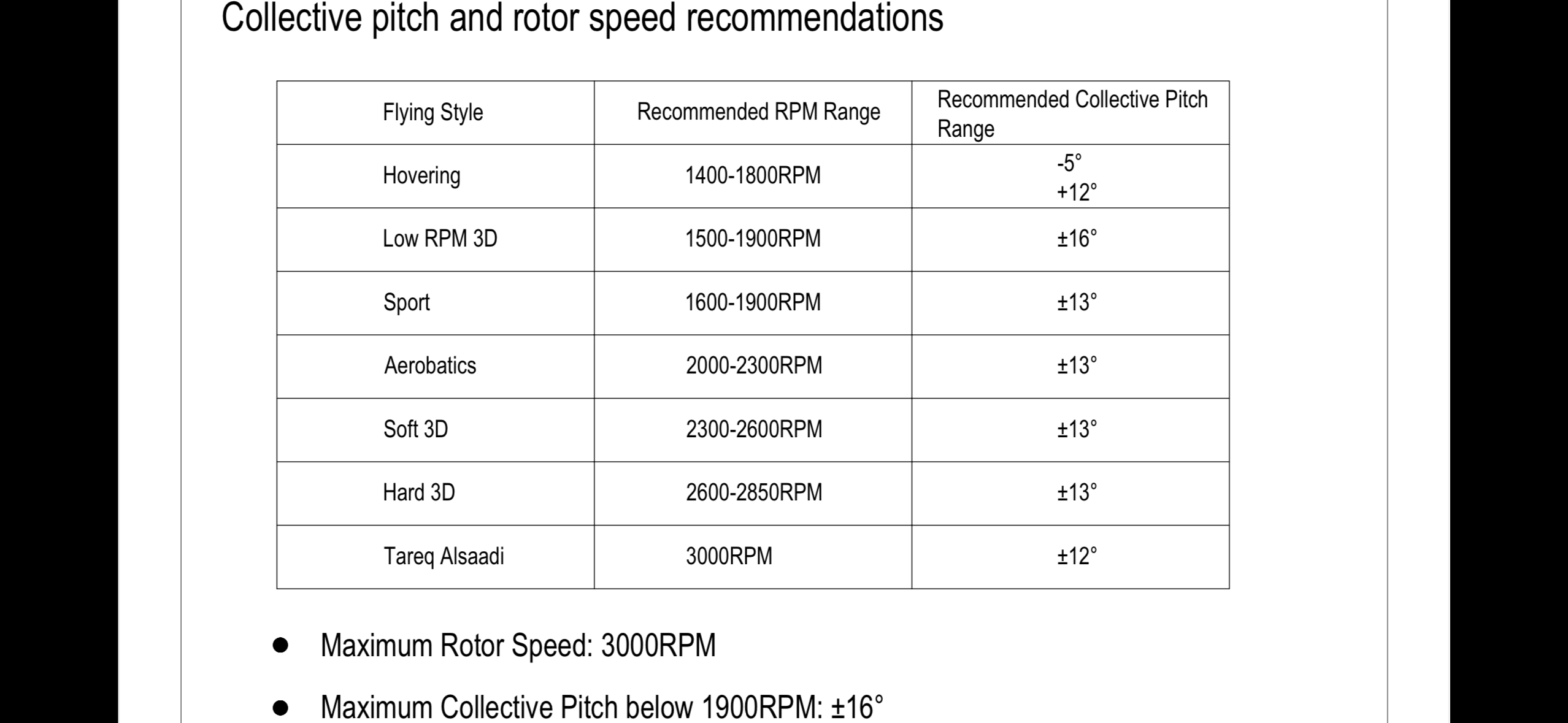

I use the governor of the OMP 85A ESC, the spirit gov is disabled. I ordered the programming box for the ESC to shut it off and test the Spirit governor to see if that could be the reason. The used rpm are from all spurces that I know the perfect ones for the M4 max, as you can see in the screenshot. And the wag gets bigger when increasing, so the low RPM should not be the source of it. Today I flew at 1700 / 1800 / 2000. should all be fine watching Jonas doing the same. But again: tail was shaking left/right. It is indeed strongest when changing the RPM, so maybe a gov thing indeed…
The telemetry said afterwards max vibration-level was +24
