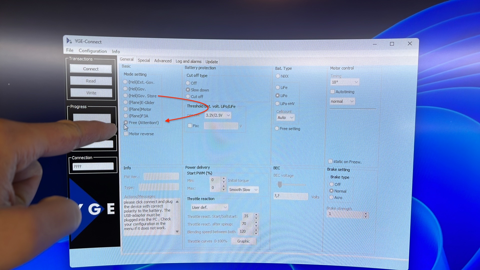

Yes. I selected YGE LVT/HVT for ESC type.
curmudgeon
- Posts: 233
- Joined: Thu 01. Oct 2015 15:13:29
I played with different combinations. I got it to work now. What finally did it was when I switched the YGE PC App > General tab > Basic Mode Setting from "(Heli)Gov. Store" to "Free (Attention!)". After doing this, the WAVE radio gave me access to the YGE parameters.
