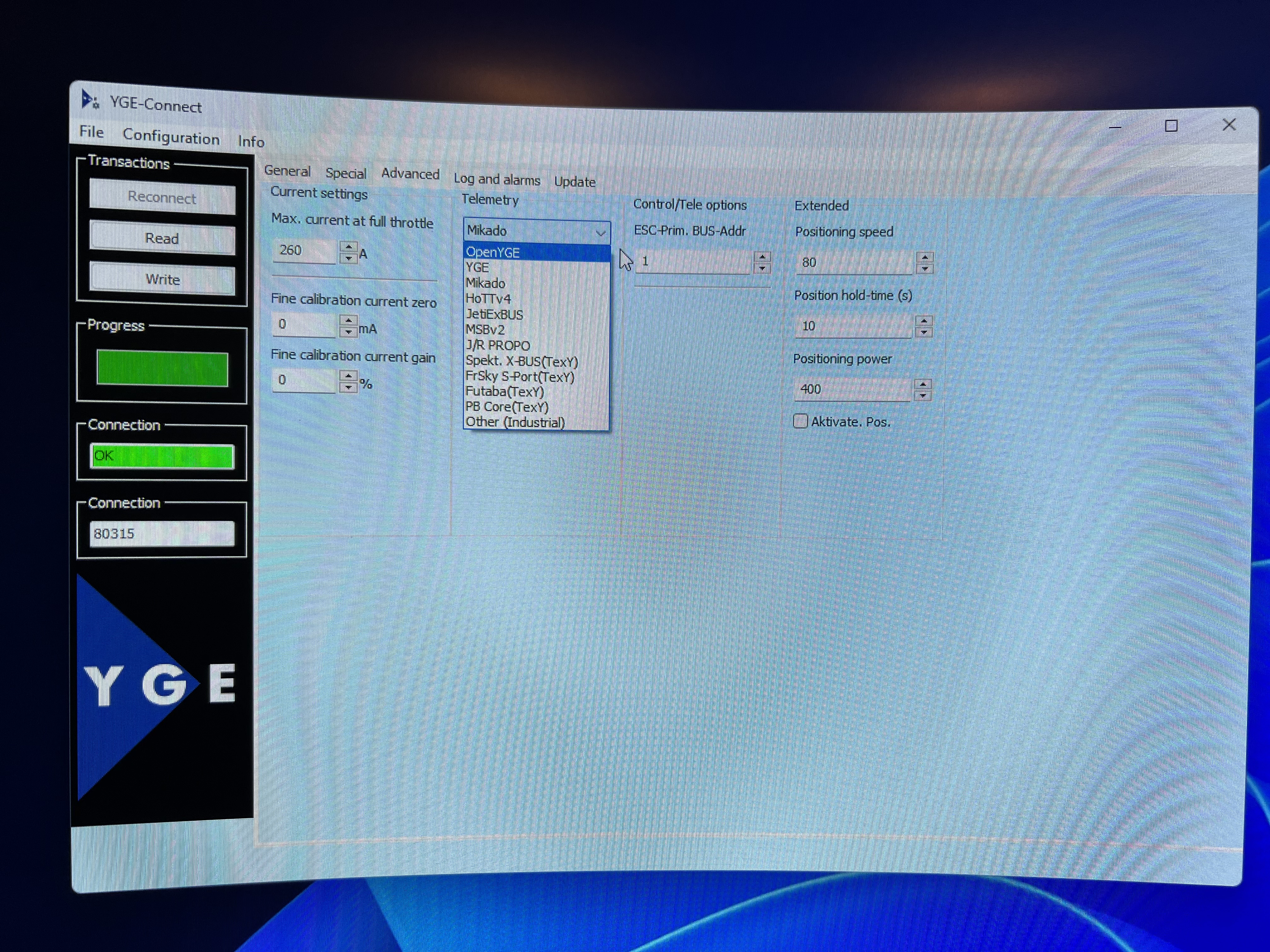

I am setting up a helicopter for the first time with a WAVE radio and a W1 flight controller. I am using a YGE 205A ESC. I am trying to figure out how to get the WAVE and YGE ESC to "integrate with each other. Which YGE ESC telemetry option do I need?
Posts: 12988
it should be YGE option.

Make sure that YGE is selected, not OpenYGE.
If you can see telemetry values, it should work.

Just a little thing that I didn't see in the video. Did you also select YGE from ESC type?
I have the YGE Aureus 135 V2 and 205 V2 both with the latest firmware and it works perfectly.
