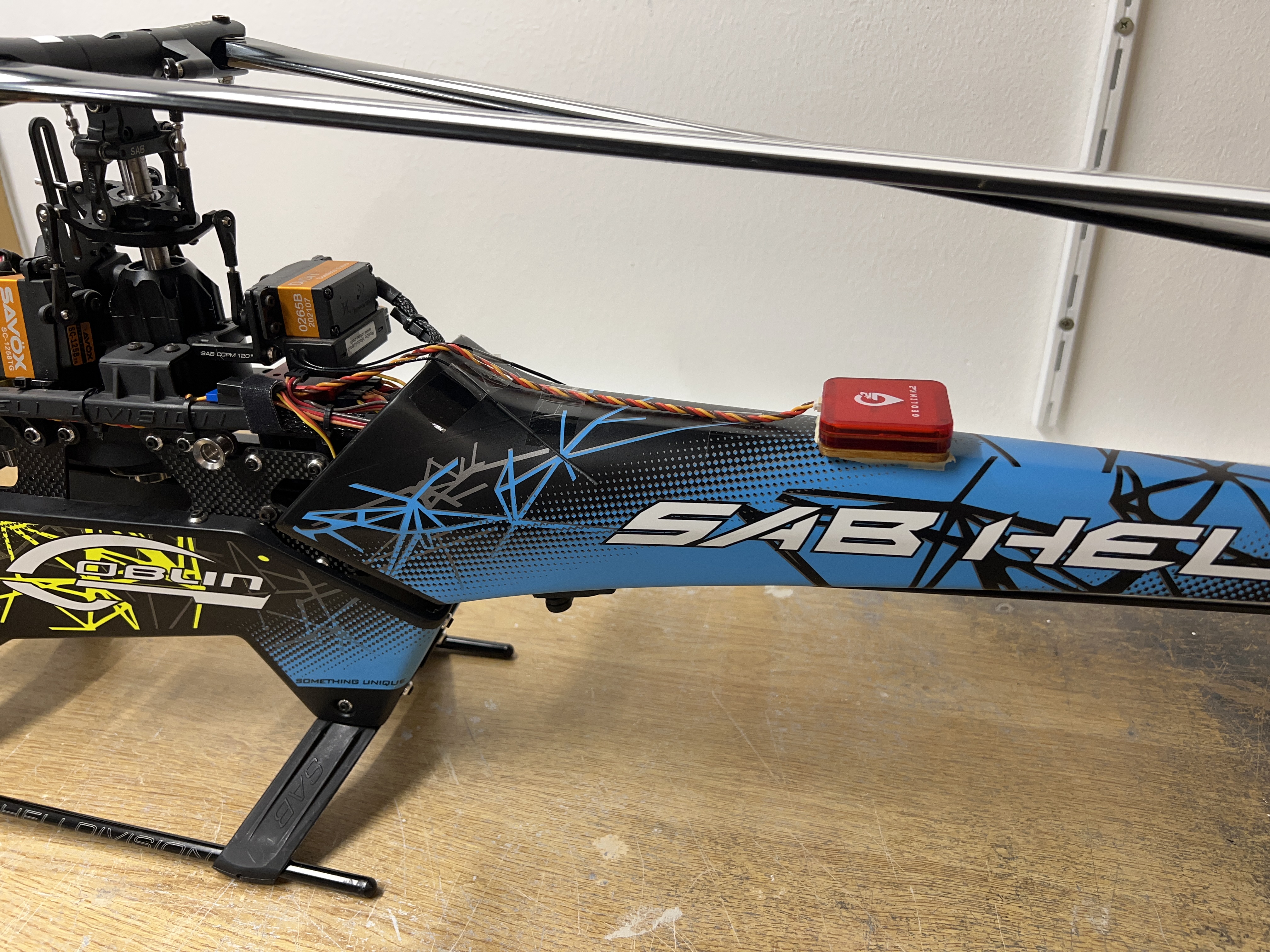

Thank you for the photos.
I am afraid I can't see GeoLink position - this is module where altitude is measured. Can you take also a photo fo GeoLink mounting?
Mounting position could make big difference, especially if using inside a canopies. There air is flowing very differently when flying faster.

Sorry, I uploaded two times the same photo, here is the Geolink position.

Hi Admin, Do you Have any ideal for solving my problem? I bought the Geolink from Spirit Systems together with the Spirit GT a few month ago and have the problem since one of the first Flights.
Posts: 12849
we will prepare special GeoLink firmware for you tomorrow which will hopefully prevent from changing altitude.
Posts: 12849
I verified your logs and settings again and I found your model has no Throttle assigned.
Throttle signal is very helpful for GeoLink because it knows exactly when to reset Altitude - when you are at the ground.
I think in your case it will help if you will assign General - Channels - Throttle to your Throttle signal. Then detection will work properly and your issue should not happen anymore. Can you try this?
