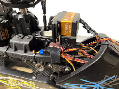

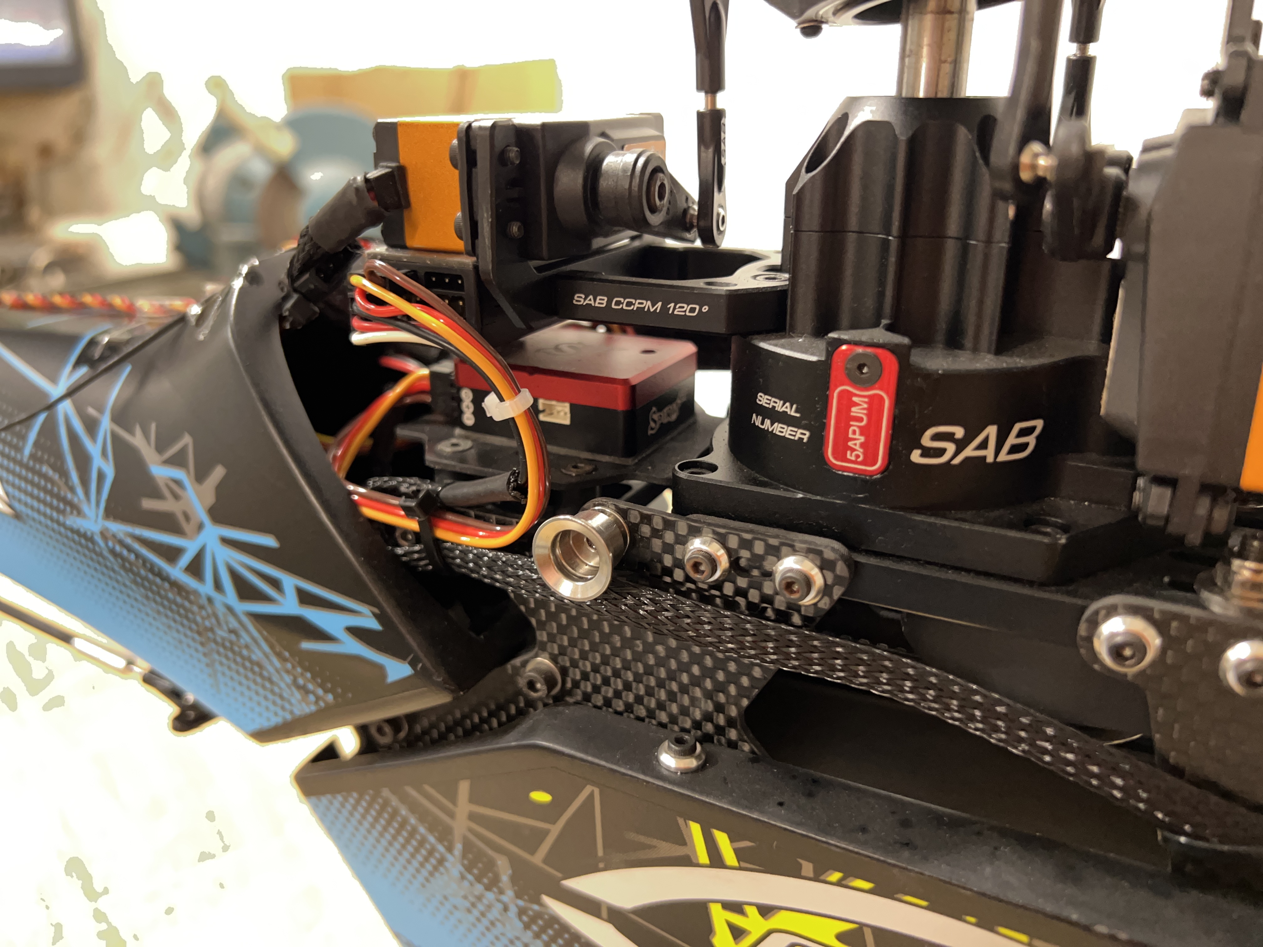

Could my setup in the helicopter play a role, where the Spirit GT is directly below the receiver, which in turn is directly below a swashplate servo?
I'll upload some pictures for illustration.
franz88
Posts: 343
But if you connect one extend USB and connect software (outside with all geolink satellites) and raises and lowers the helicopter with your hands the barometer and laser reading of the geolink it's precise?
my reading barometer It is accurate to within 10 centimeters.
0 meters
0,10 meters
0,20 meters
Ecc ecc
And how do you read the height? (On the table without blade, use a USB extension cable)
