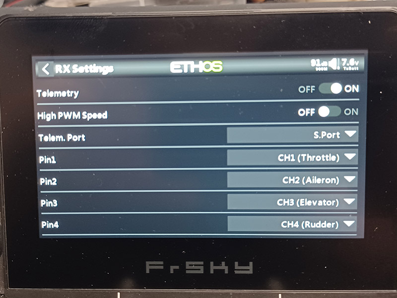

Aircutter wrote:Good Morning
Ok, will try again. In the settings of the receiver I can switch between S-Port, Fport and FBUS. Will try with Fport.

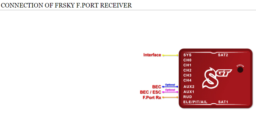

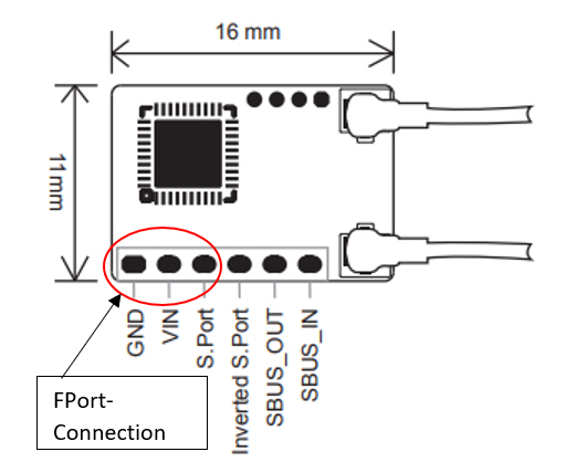

Could anybody provide the wiring for the Archer RS receiver with Spirit GT.
Posts: 643
FPort-Connection see below:
Aircutter
Posts: 7
Joined: Fri 17. Feb 2023 19:29:58
So it is exactly the same wiring as with the R-XSR receiver. Then I have to change my soldering on the archer. I took the inverted S.Port instead of the normal S.Port.
Mattes61 wrote:Hello,

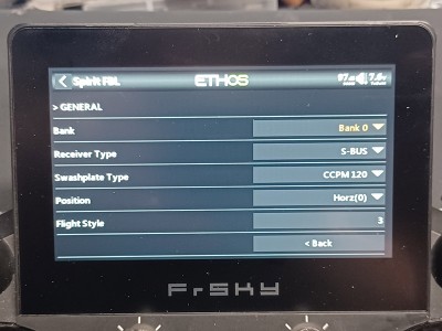

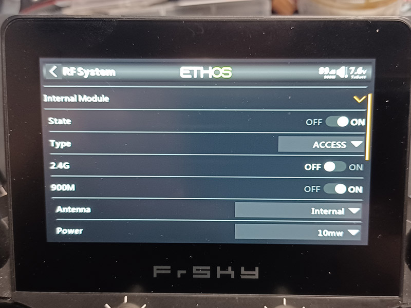

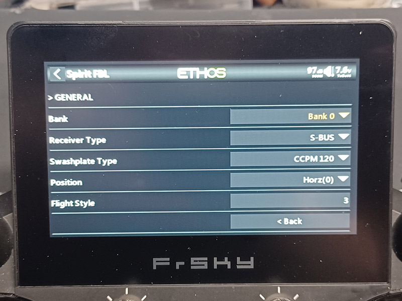

I hate to disagree with the guy that developed the Spirit System, but this is inaccurate.
I have a Tarot 450 heli running with a Spirit 1 and it's connected to a FrSky R9MM OTA. This is a 900Mhz. It is connected to the Spirit via S-BUS, and S.Port protocol (see the first post in this thread). I have full integration, even though it's running S-BUS and S.Port, since there is no F.Port support for the 1st generation Spirit FBL.
I'm not sure where this "not allowed by FrSky" is coming from, but obviously it's not correct.
So this is still more of an issue with particular receiver units, rather than "It's not allowed". Yes, it works more reliably, or rather with more receivers via F.Port, but it doesn't mean it won't work with S-BUS and S.port. It's likely the LUA code work more "universally" over the F.port & .BUS protocols, whereas S-BUS and S.port are more picky
