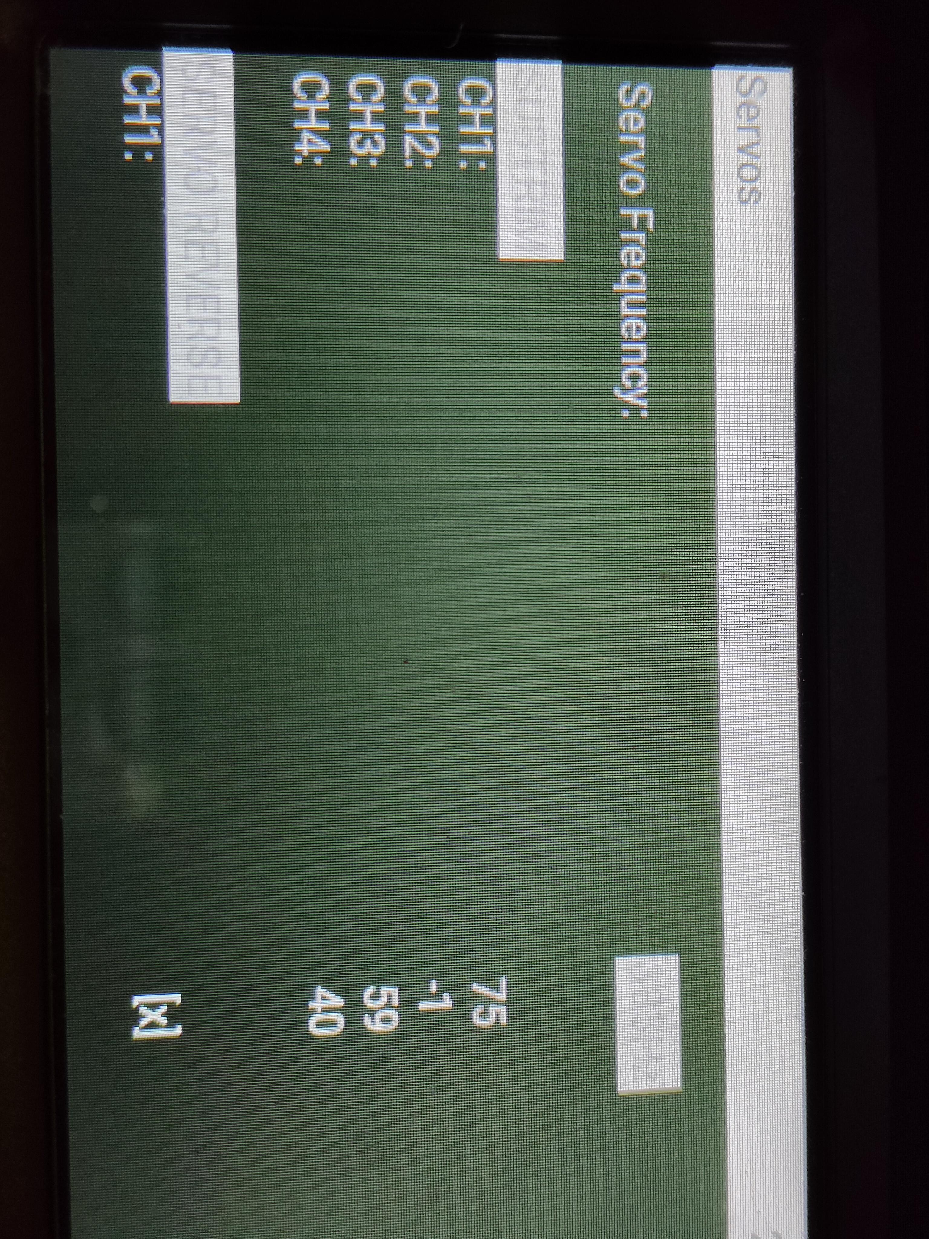

NOTE: There is something wrong with the integration here. I can go to most of the menus and see the actual values. I haven't tried making any changes yet. HOWEVER, If I enter the SERVOS menu, everything becomes grayed out and I no longer have access to any of the functions, even the ones that were working before, until I power the radio and the receiver off and start over.

So this is what I have currently working with Ethos. As mentioned above, Integrations is touch and go, and seems to work on some units, but not others. Also, there's the bug that crashes the integration script when I go into the Servos menu on the F.Port receiver, but not the S.Port.
