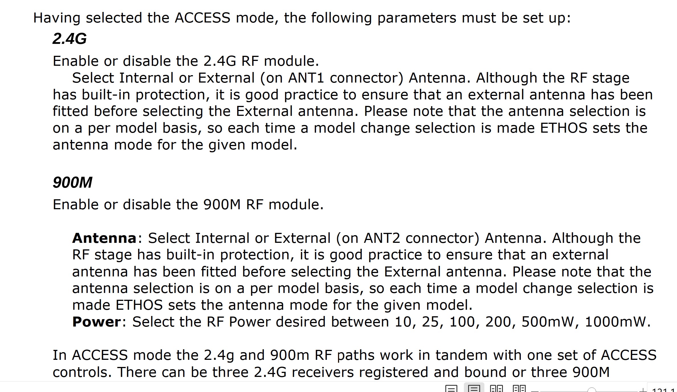

Posts: 638
Hello Tomas,
can you deactivate the 900Mz Path in your transmitter for this test ? I think it is possible, see here -
I have made an screenshot out of the X20 and Ethos-Manual:
