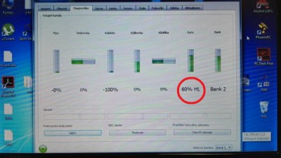

sampoalphascan wrote:You have to decide what is better for you.
The rescue are always activated only when Gyro Gain is negative.
The rescue mode you have to set Function parameter in the software, Stabi tab.
Diagnosis is then in the channel gyro displays HF instead HL.
HF/HL what are these to mean?
sampoalphascan
Posts: 108
When activated rescue would be "HF"

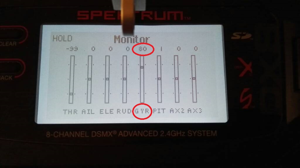

Yes, the method 1) may not be used to switch banks. ELE / D / R activates HOLD who deserts a negative value to the channel gyro, thereby activating the rescue. When activating the rescue must be in diagnostics see "HF".
"When activating the rescue must be in diagnostics see "HF". By this you mean I need to go into that page of the Spirit settings in the software to activate rescue??

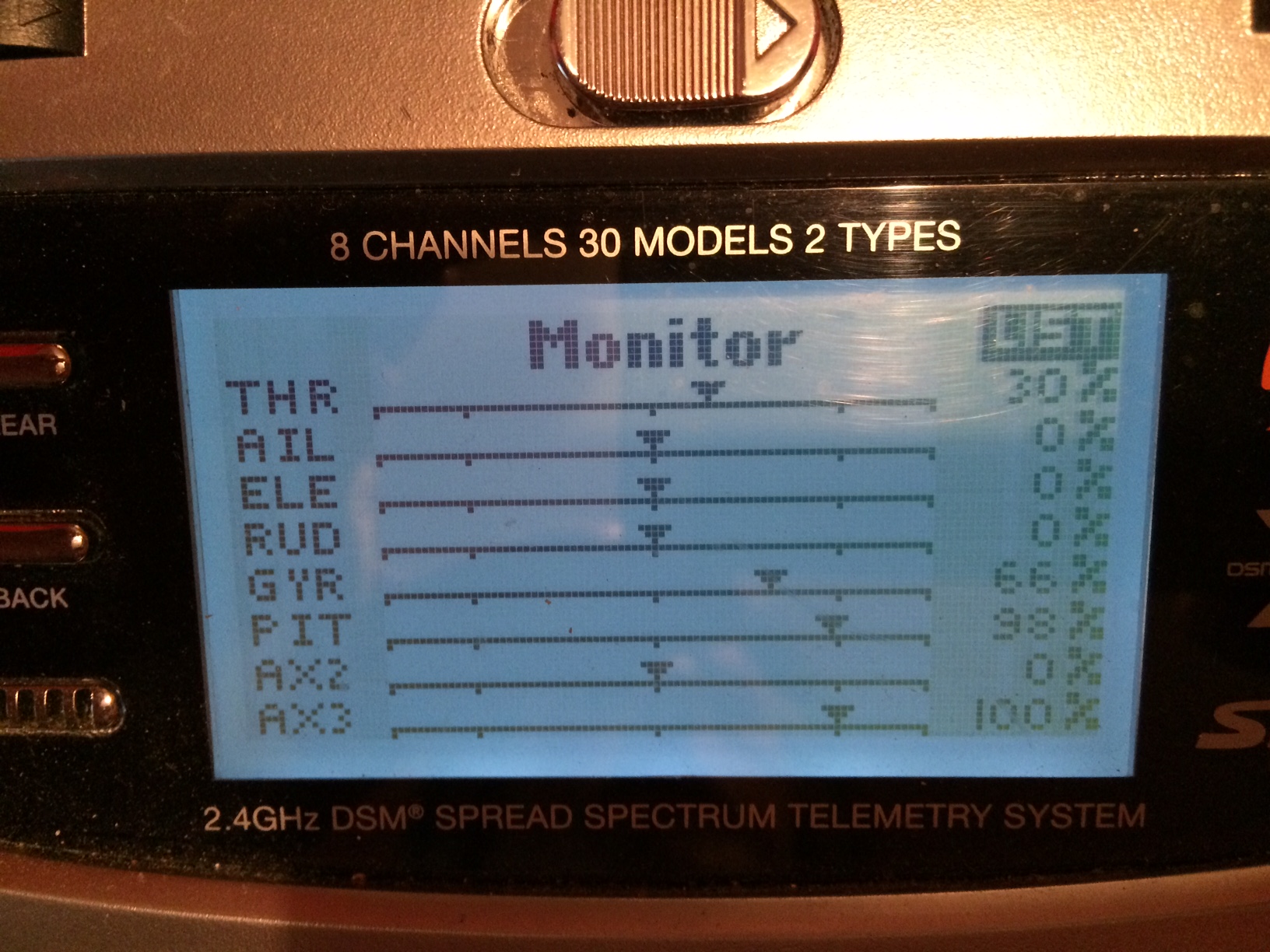

Ok thank you, one more thing please.....please look at this radio specifically the throttle.....do I need to redo this or something it goes from -98 to +30 or something like that...

sampoalphascan wrote:I do not understand the question. I do not know what is photographed.
There is not picture of my monitor of my radio showing?
My monitor shows at bottom throttle I have -96, and full throttle showing +30. I am wondering how i can get it to read -100 and +100
I am afraid this throws everything out like 0 stick actually not being 0 stick. I don't know how it got this way.
Also I do not have radio set up just yet, I saw this throttle setting and became concerned and am thinking I shouldn't set any rescue up until the throttle setting is resolved
