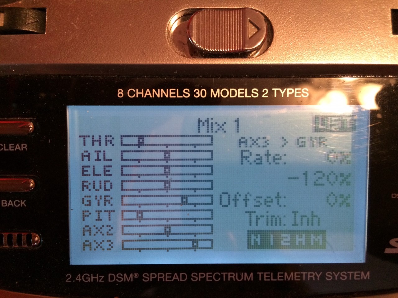

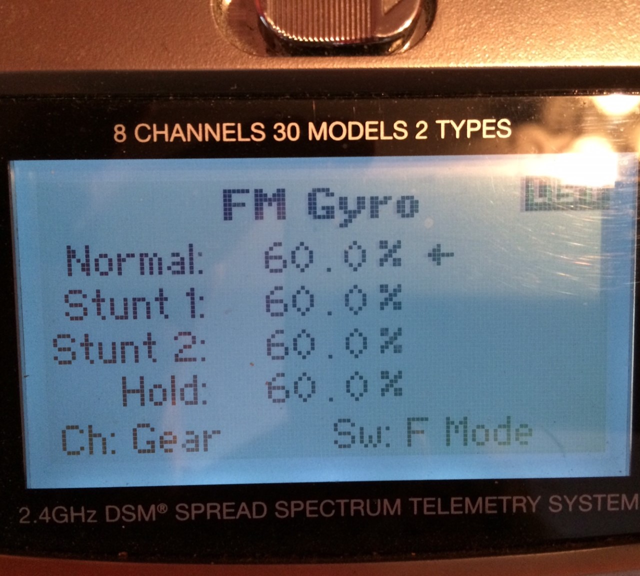

Ok I am very confused on how to set up rescue on my DX8!
I want to use the bind button to activate it, and these are my settings.
I have not tried bailout yet because I want to be sure all of this is correct.
As of right now I am getting tail kick on punchouts with these settings and since the negative reading only goes to -125 on my radio, there is not much room if I add gain on my positive side.
Anyway are these settings correct?
Also I just want the bailout to flip the heli up right, what setting do I set it to in the program??

Je třeba na jeden vypínač dostat přepínání bank + zisk gyra. Záchranu pak nastavit přímo v jednotce v bance.

Konkrétně mám na přepínač "F" nastaveno 5 kanál gyro (-80/80/-80) + 7 kanál přepíná banky (-50/0/50). V JEDNOTCE V BANCE "0" PAK ZVOLENA FUNKCE ZÁCHRANA. BANKA "1" BEZ FUNKCE. BANKA "2" FUNKCE STABI. třeba

Switch F = GYR + AX2
GYR... Switches gain gyro
AX2... Switches Bank in spirit
sampoalphascan
Posts: 108
F position "0" GYR - 80, AX2 - 50,... activates bank 0 & selected function

I am still not getting how this all works, part of my problem is I have to see things work too when it comes to electronic things.
All I want to do is push my bind button and activate rescue. I like to use my F-Mode to switch between flight modes Idol 0/1/2

Unfortunately, you're limited to a maximum value mix .... If that's not enough there are three options.
a) the set features a rate gyro firmly in the unit and only switch banks.
b) profit Gyr sent from the transmitter simultaneously with switching banks.
c) Only one bank to which send negative earnings Gyr's aktuvuje function. Everything shows up in the diagnostics unit.
