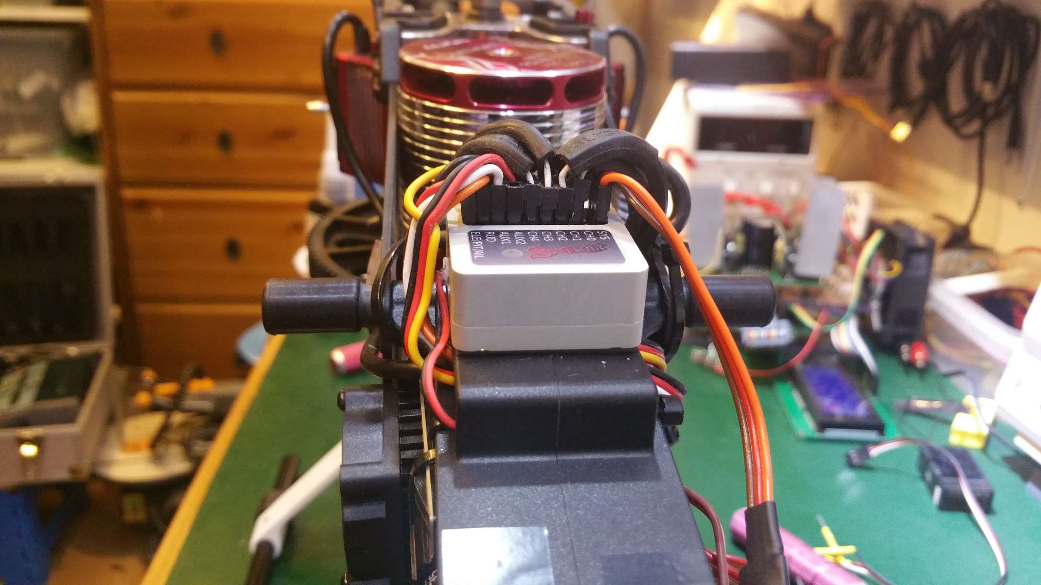

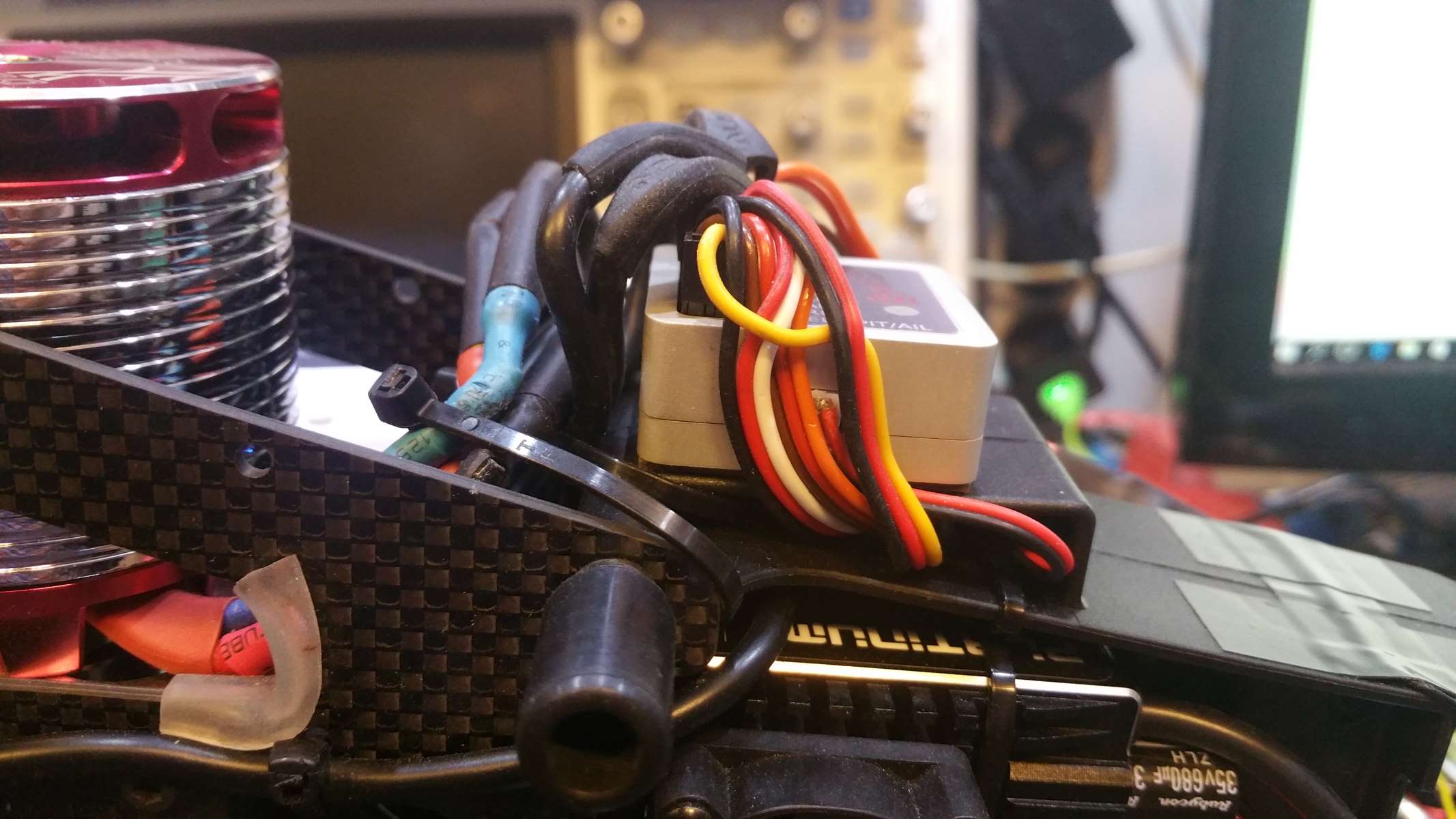

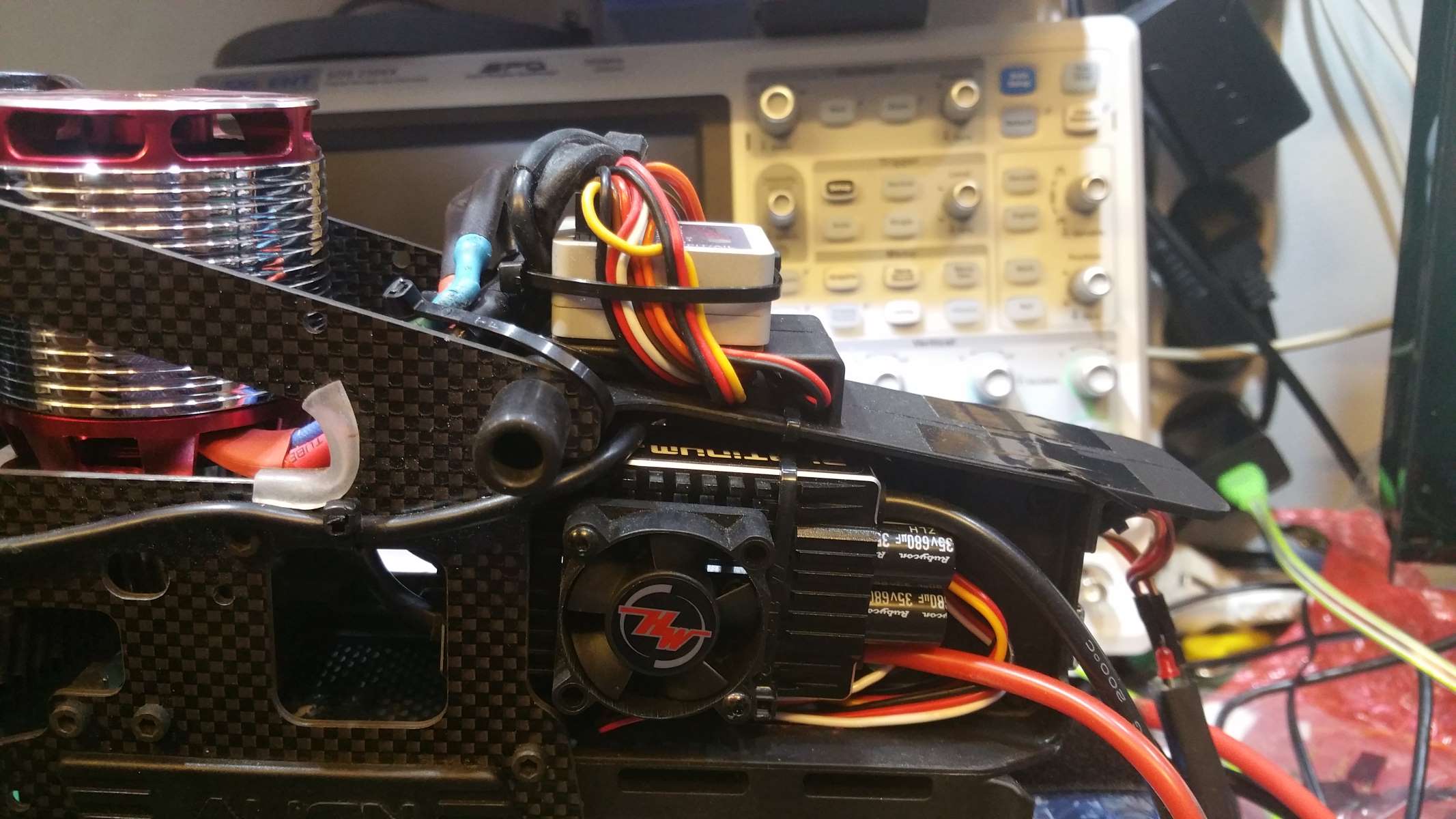

Here are some pictures of the installation after I added the wire strip I mentioned:

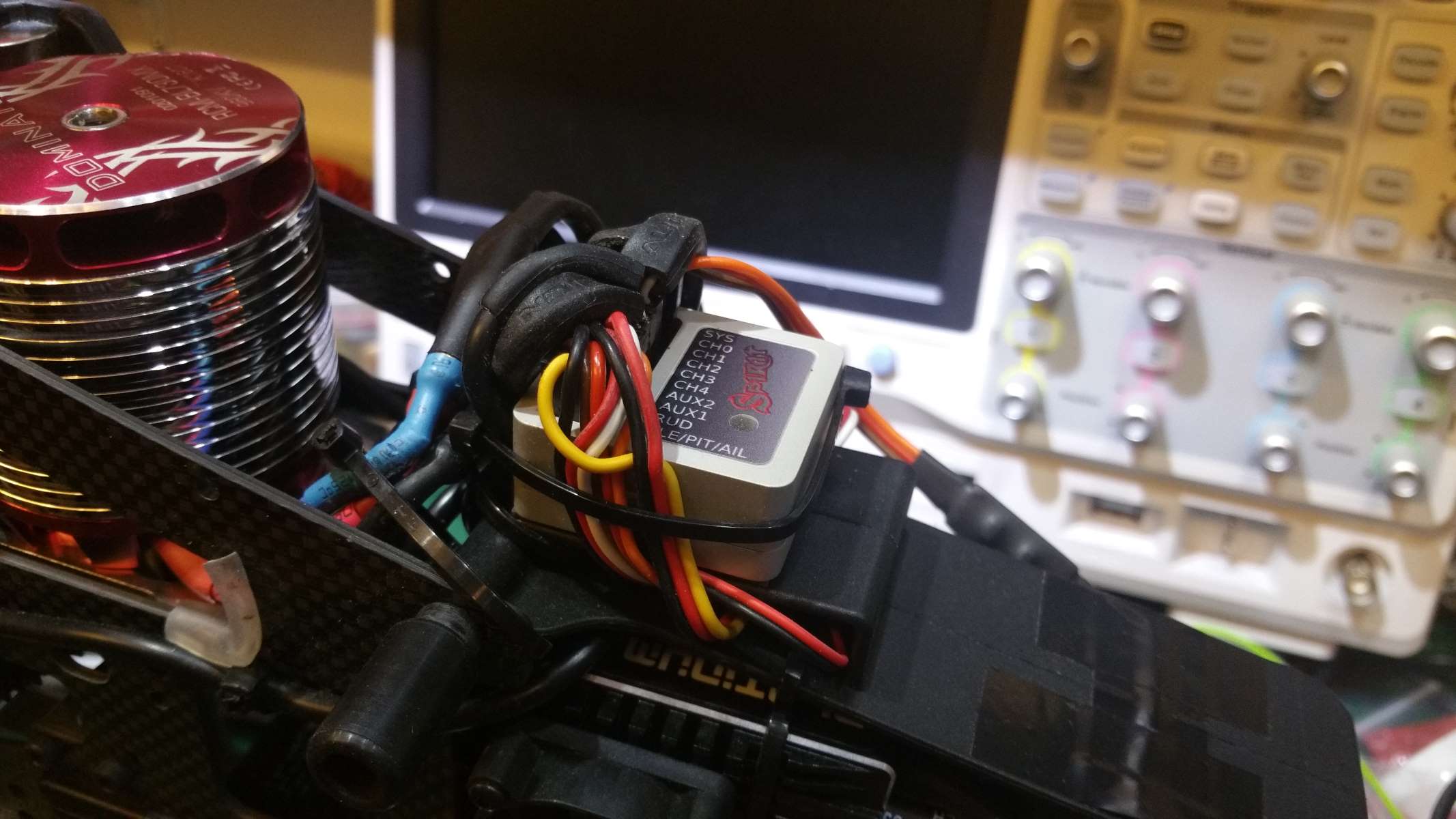

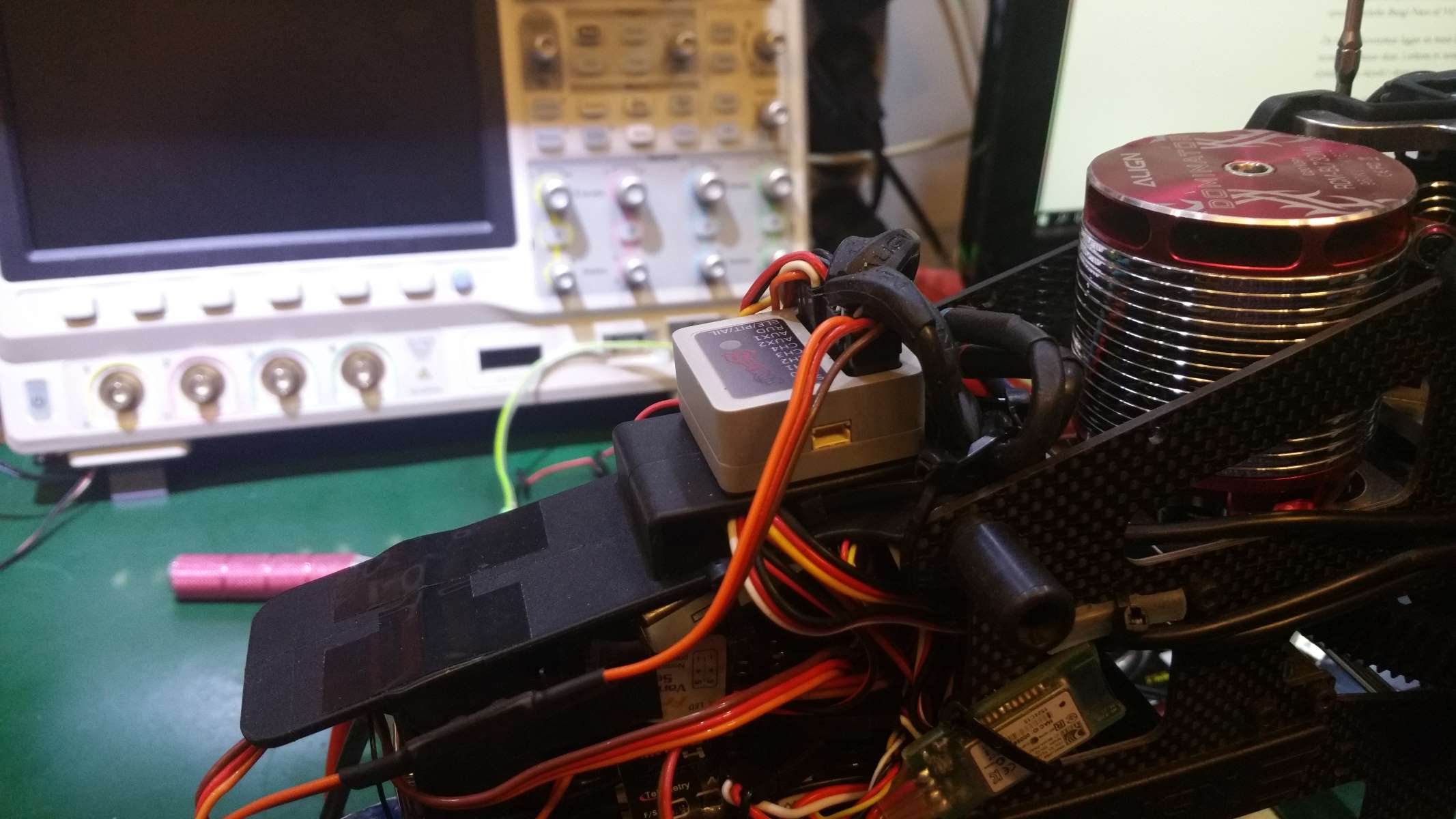

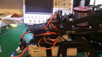

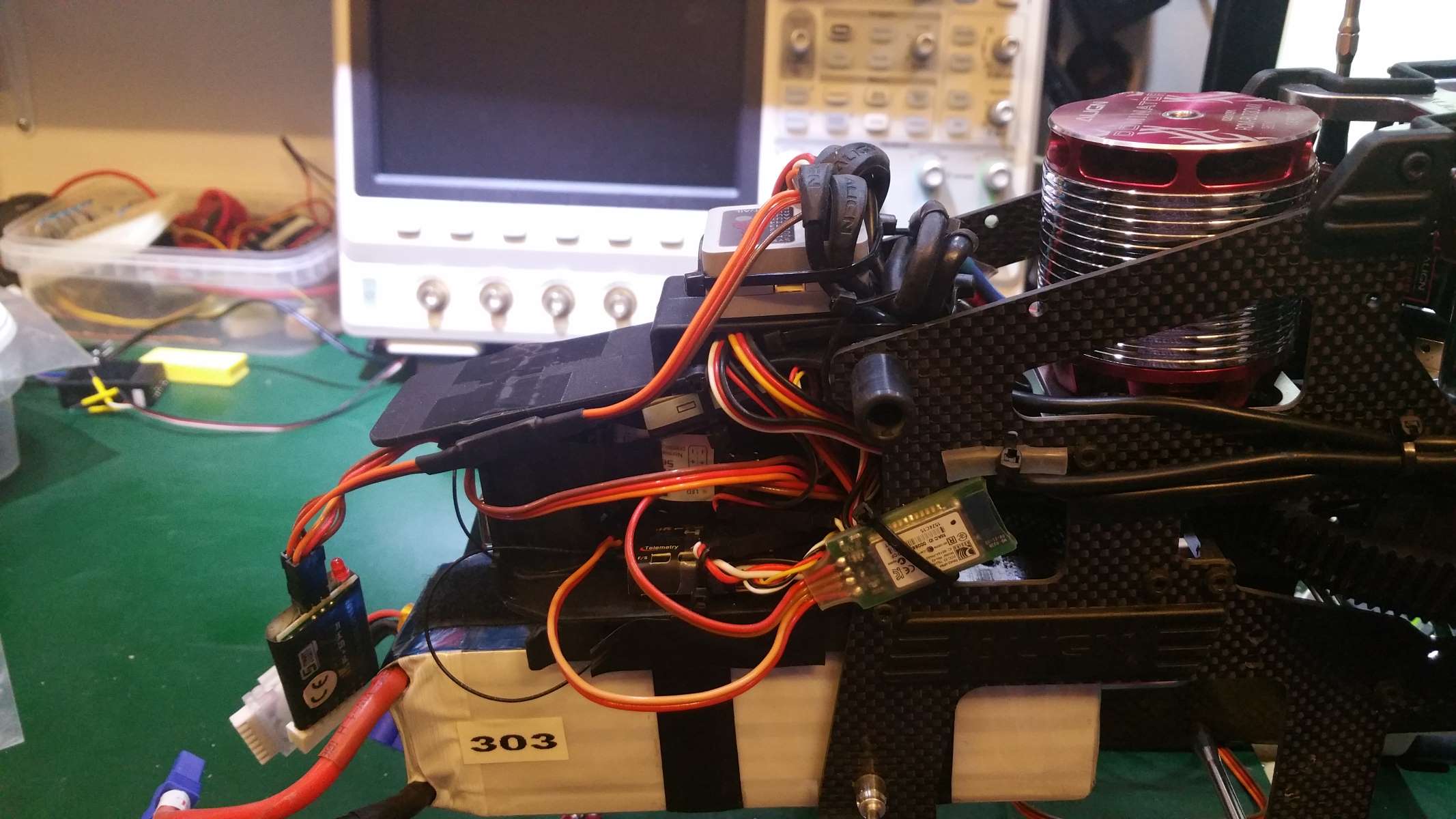

And here are some picture after I removed it again:
If there is something more specific you want me to take a picture of, let me know.

Thank you for the photos.

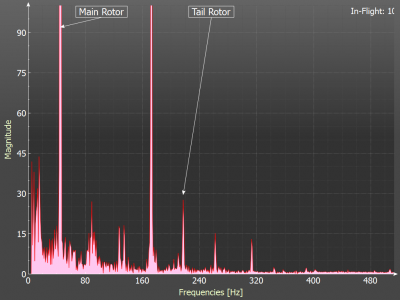

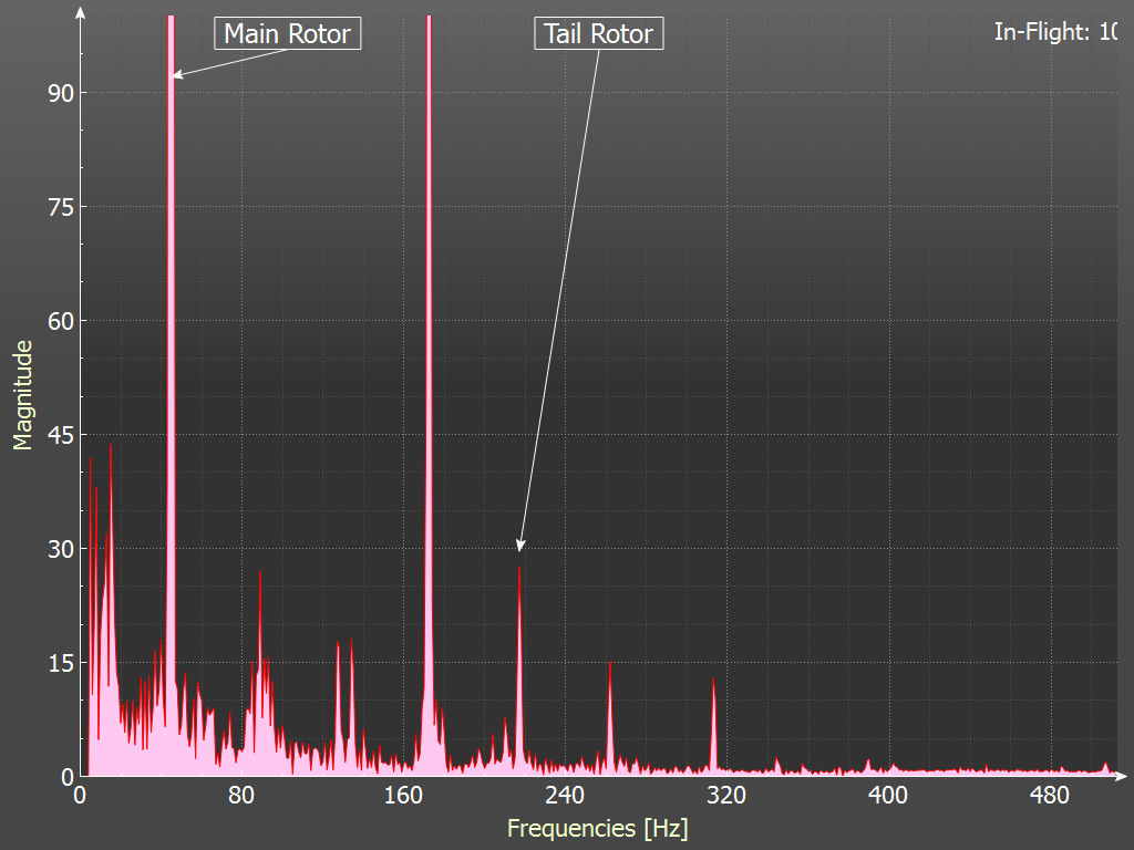

Then I set it up for sampling the X-axis on one switch and the Y-axis on another. And it turns out that I had massive Y-axis vibrations in the frequency for the main rotor rpm, and what I at the time concluded was the motor rpm when measuring it in-flight. Much larger than what I saw when measuring it on the bench with only tail rotor blades on.
But now that I look at the snapshots I saved, I believe I was wrong about the second peak being the motor. It seems to be in the frequency range of the tail rotor instead. It is not very easy to extract any data from the PNG's though. Would have been really nice if it had the ability to save the raw data instead and display it in the software later. Would be much easier than trying to decipher everything on a small tablet screen completely washed out by sunlight in the field before unplugging the battery and loosing all the data.

From the plot vibration spike is on the main and tail rotor.
Both spikes are over 100% amplitude which mean it could be even 200% high. They are together with many more along the plot - the small ones that are repeating from the beginning looks to be failing bearing. I dont know if the plot was taken before motor was replaced, but it looks that it could be even bearing from the motor since some spikes are higher than tail rotor RPM. If you want to be sure that it is not the motor, you can just move the motor out of the main gear or remove pinion. Then perform the analysis again on the bench.
I recommend to make the analysis again, with tail blades only - on the ground. This should reduce some spikes on the main rotor, then we will know if it was from the blades itself or it will be still there.
You can say that the model is in good condition if no spike is higher than 60% of amplitude. So it would be good if we can get into this area.

Yes, the spikes seems to be very high. This measurement was done before I replaced the motor. I have not been able to make a new after the replacement.
Before all this I did make a measurement without the main gear installed. So only the motor. And it peaked at about 50% at motor RPM. And when I tested it with the whole drive train engaged with tail blades but without main blades I got one peak at head speed that would sometimes go as high as 70%, still a fairly high motor peak, but not much on the tail. So I was surprised to see the very high tail vibrations in flight.
On the bench there was only 3 spikes and much less random noise in between.
