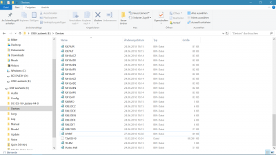

Could you please take a screenshot of the Devices directory? So then I can see if it is all OK.
Previously it worked for you, because the Spirit.bin file is bundled with JETI update. But their latest update does not include Spirit.bin for 2.5.1 but for 2.4.3. For this reason the file must be replaced with newer version.

Here my screenshoot

That's the old one, the new bin file has a size of 86. Jeti does not create the file, Spirit does. So why wait for Jeti to post the same file that Spirit has now on their site?

After connection through TeamViewer all was sorted within few seconds.
The problem was wrong Spirit.bin in the Devices.
