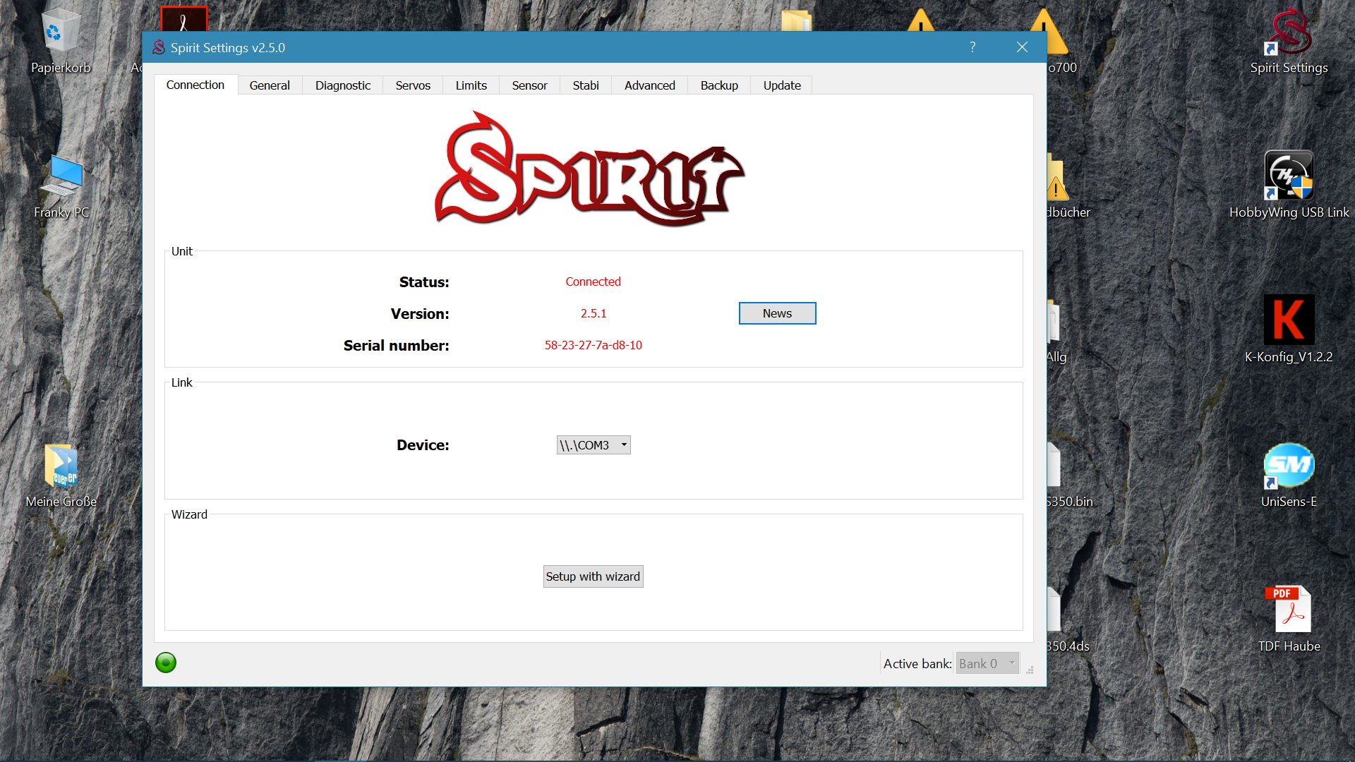

In the DS16: Device Explorer
Here the spirit is displayed. If I click it, the Spirit settings will not be displayed.

I see spirit in the device explorer, ok on the right!
I click the spirit, I get the message:
"Device not connected"
I did not have this message with version 2.4.3
Immediately come into the spirit settings!
